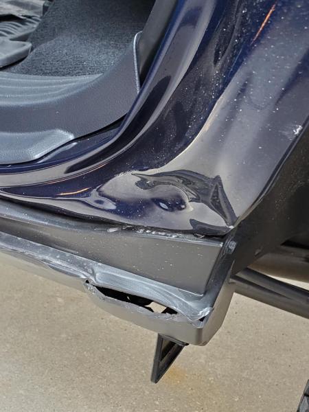

I'm not too excited because the body guy said they'd have to remove quit a bit of the interior to make the repairs due to the door rail damages...I have no tolerance for rattles and I don't care how good they are, it's never the same!

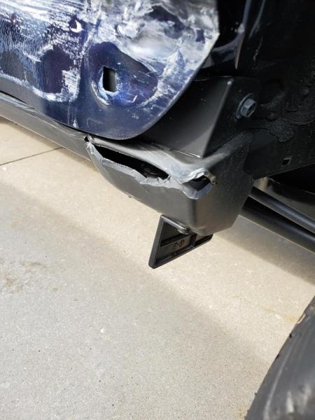

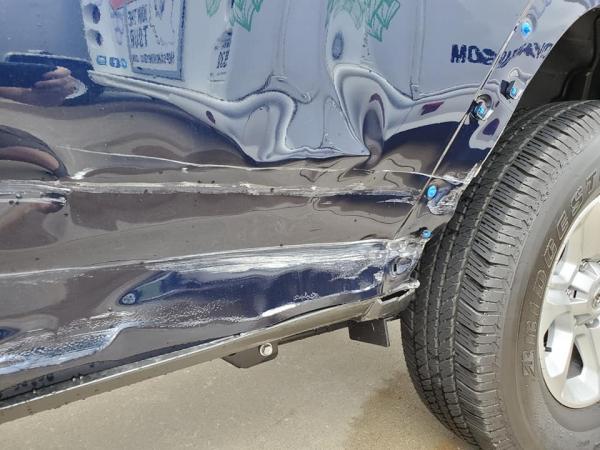

That looks brutal, obvious besides doors, if the B-pillar is bent, doesn't that compromise the integrity of the vehicle such that it lessens its ability to withstand another large impact? I'm not sure on that part.
What i do know is that if those rocker panels are bent, you're going to have premature rust issues down the road. The rocker panels are several sheets of metal pinch welded together with 1/8"ish gaps between them. Certain whole bits of the vehicle are literally dipped in a primer + paint bath so that paint goes into every crevice and crack possible. The rocker panels is one of those pieces. If the paint is compromised, those pinch welds hold a ton of dirt and moisture. So it may be one of those things that nobody can see and rear its head down the road i.e. premature rust after insurance fix.
There is absolutely 0 way of fixing damaged rocker panels to the quality of straight from the factory. Even if you cut them out and weld in new pieces, you run the risk of trapping moisture in the welds which will rust from inside out. Nobody can say for sure what the likelihood of this is, but it's definitely a possibility greater than 0.

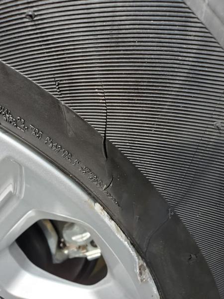

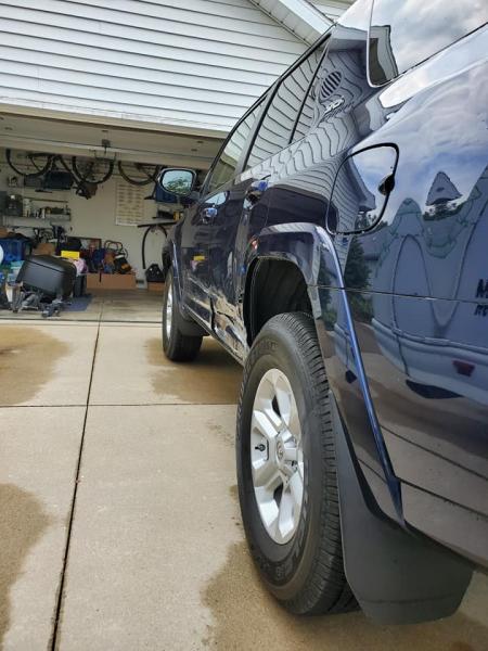

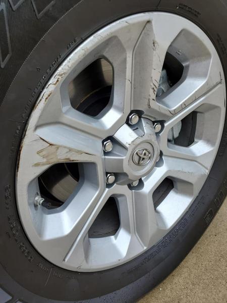

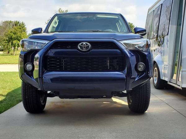

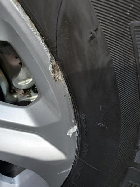

Here are more pictures of the damage.
I’ll take both of the good snowflake wheels for $100.
I’ll take the scraped, but not dinged wheel in the last pic for $25.

Man, that is bad. Surprised it’s only $7,200. Figure painting it right in a booth is going to run at least $4,000 alone. Is the axle bent? Have you had any other shops take a look and write up an estimate? If you haven’t, I would. And who gave you that estimate? Progressive rep? Or a Progressive authorized body shop? That seems way low for what they’re going to have to do. No way that’s with OEM parts. I’d definitely ask your dealer for a trade in value and use that in negotiating a settlement. I’d also find a 4R exactly like yours and throw a few hundred deposit on it with your dealer before the 2019s are gone. You’re going to have to get a check for diminished value for this - the Carfax accident report is going to sound awful. And the pictures aren’t going to put anyone’s mind at ease. Sucks!
Folks I'm sick. My new 2019 SR5 Premium with 560 miles on it got tagged today after somebody ran a stop sign.
Left front fender, both doors, both left side wheels have chunks out of them, alignment is screwed up, under body looks pushed in a bit.
Any body guys here? Providing frame is OK, ball park figures on replacing all if that? It wasn't my fault but I'm going to push his insurance co since this is brand new.
I'm worried about damage to drive line since it was knocked aout of alignment.
