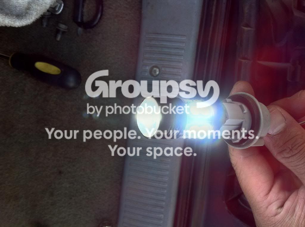

2X White T20 10W 7440 COB Optical Projector Super Bright LED Brake Tail Light | eBay
I got these a few month ago and they are a big improvement over the old ones, if still is not enough you could try the suggestion posted above, but hey for 13 dollars it still worth a try.

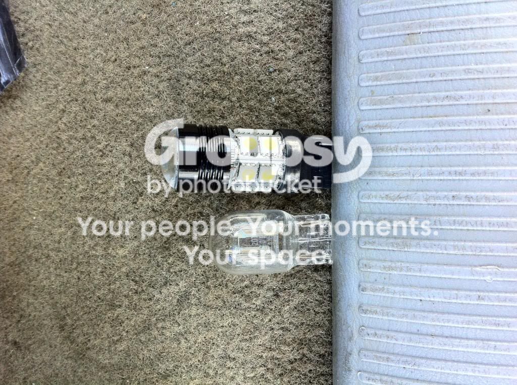

2 x Car Xenon HID White 3157 Genuine CREE 7W Tail Stop Brake Reverse LED Lights | eBay
Just get these!!!! Trust me you'll will be happy, took me a whole 10mins to install and for the price you really can't go wrong, I have ALOT of people asking "what kinda lights are those? bright as f**k" lol
