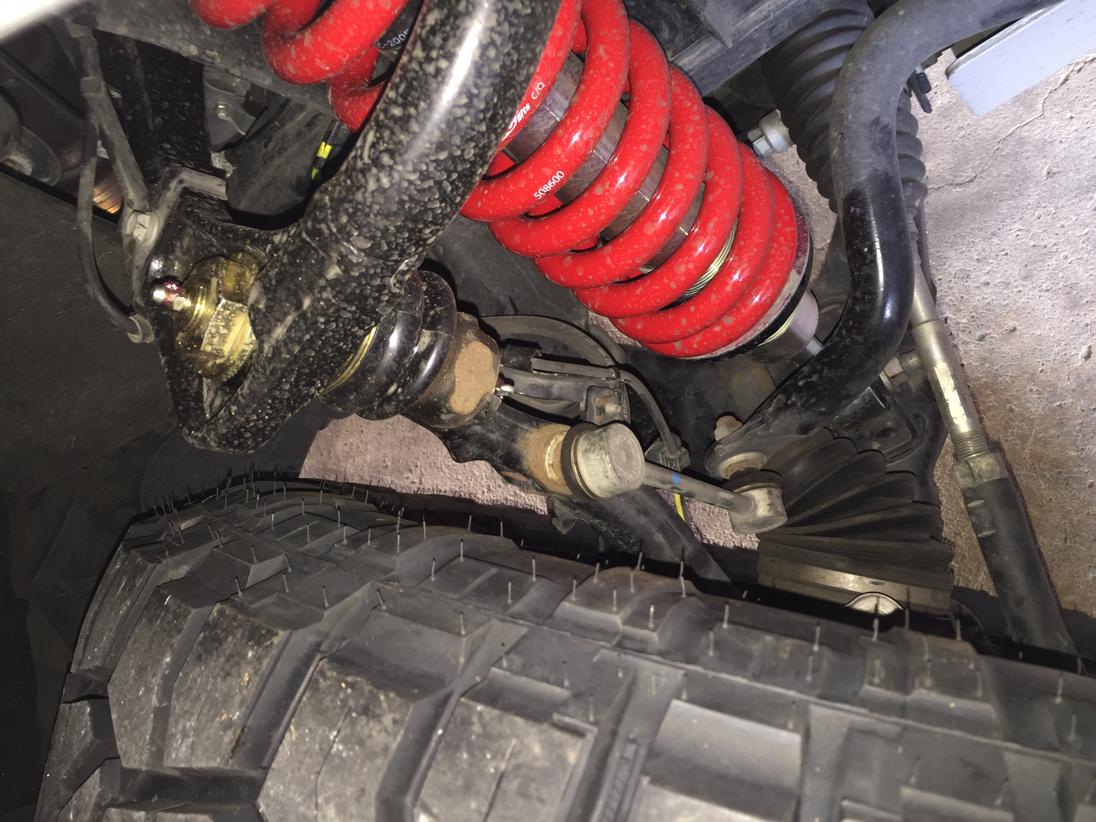

SPC uca from amazon 360.00 they now play the change price game. I intially got it for 450, saw the change and returned it back to their ass. Installed with Toytec Boss 3" kit. My 33"x 11.5" ridge grapplers fit just fine.

so, with this new greasable type ball joint SPC is using now, where is the outflow from that zerk fitting? that main bolt would have to be hollow for the grease to go anywhere...that would be a huge concern for me since this is one of two points which actually keep the wheel/tire attached to the truck. losing either this point of contact, or the other point at the LCA/steering knuckle is catastrophic is speed, and really, really shitty at low speeds. there is a reason this is usually a huge grade 8 bolt and stainless fittings on other aftermarket brands

It's a standard ball joint so if you force grease in, it should purge the old grease from the grease relief valve (found where the boot contacts the stud).
