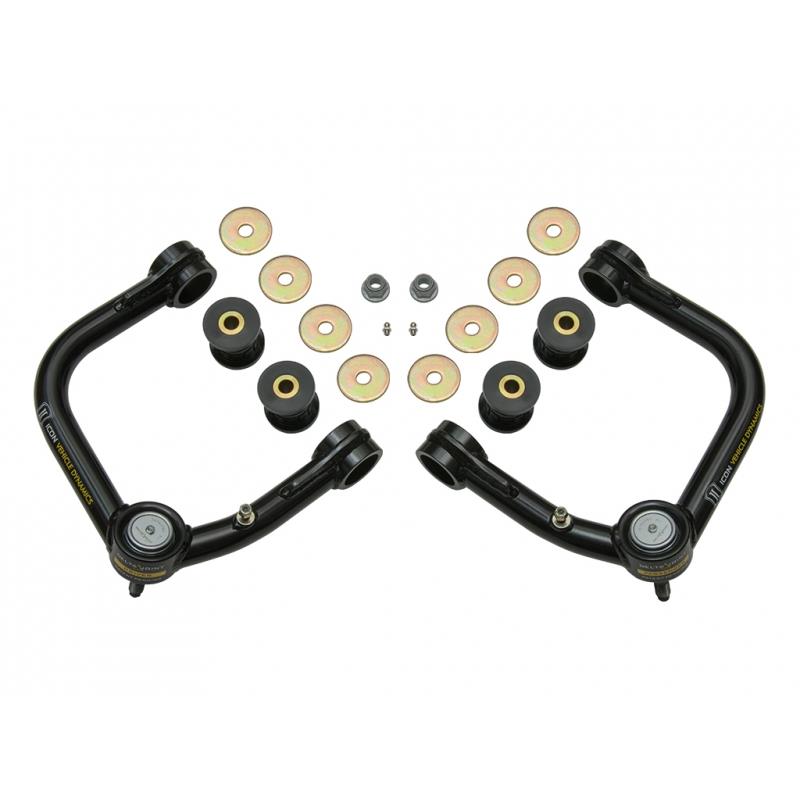

ICON Upper Control Arms with Delta Upgrade was by far our hottest UCA.
The Delta Joint is a heavy duty high angle ball joint that combines the
durability of a ball joint with the performance characteristics of a uniball.
ICON Delta Joint UCA #58451DJ
KEY FEATURES:
• ICON Delta Joint
• 1026 DOM Steel Construction
• CNC Bent Tubing
• Serviceable Dual Stage Bushings
• CNC Machined Bushing Housings and Sleeves
• Built-In Caster Correction
• Black Semi-Gloss Powder Coat Finish
Fits 2WD & 4WD Applications

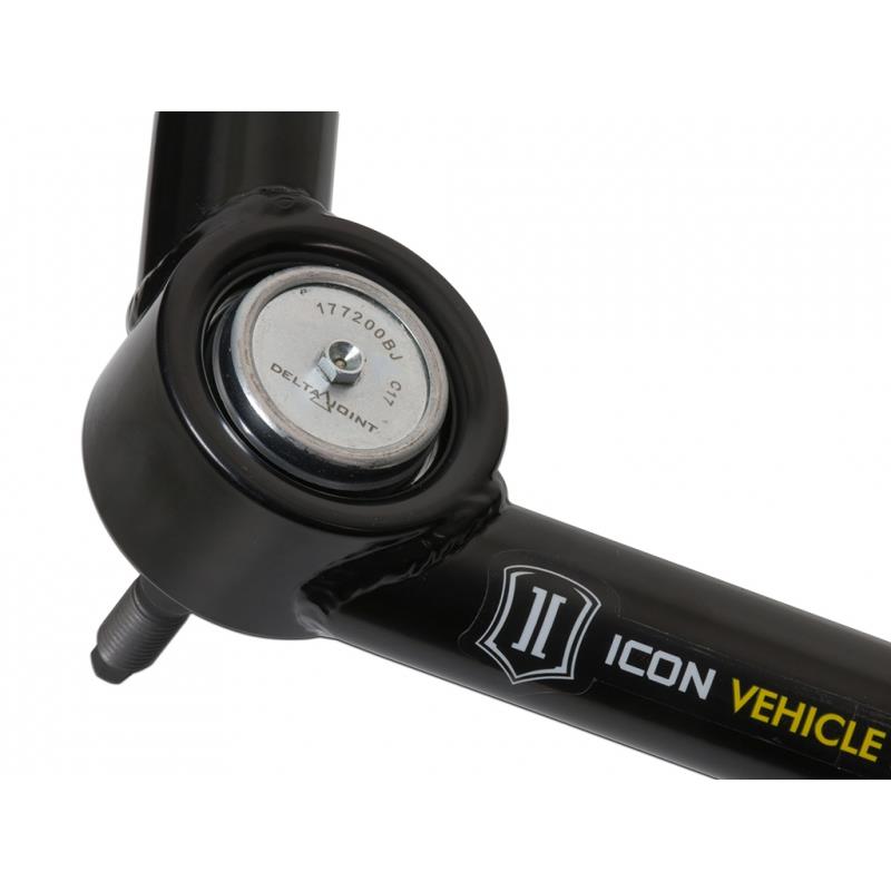

What makes the Delta Joint unique is that it brings the best of both
worlds to ICON upper control arms with features that make it more
robust than a uniball, and at the same time capable of greater
angularity than a typical ball joint.

I got my Delta Joint UCA in last week with the other ICON suspension parts from TAPLV. It looks really robust and the finish is really durable. What I can't figure out is, is that a zirk fitting on top of the ball housing? I'm used to seeing a rounded nipple that fits the grease gun. The info and instructions say the ball joint is serviceable and needs to be greased on installation. But how or what fits that piece?

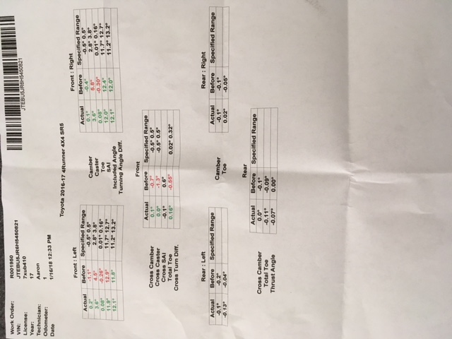

How's the alignment after? I have Camburgs and they can't quite get my caster where it needs to be (2.5ish instead of 4+)
I had these put on yesterday, they seem to be pretty good. I can hardly wait to get down to the mall. :shrug:
Here is the read out for my uca's, i do not know if this is good or not, but it feels real nice.
