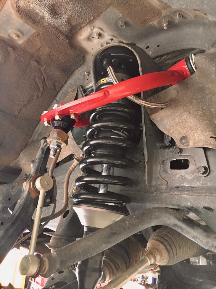

I added the JBA UCAs to my build. They are as advertised with no noise and great articulation, fit and finish are good and the alignment is spot on with a 3-inch lift. Marlin (Owner) has been building UCA's for 30+ years in the jeep community and began about 5-6 years ago for Toyota. This is from memory when I researched the product so if I am off a little please don't be too put off. They are priced fair ($450 range) and can be greased via zerk and ball joint replaced if it ever wears out. What is not to love.

Nice! I may go this route instead. Can you link where you bought them or list the vendor here? Thanks again.
Just for the sake of keeping info together in one thread. I've run 4 different UCA sets. Stock, EBAY uniball (broke), Tuff Country (Geometry worse than OEM), and JBA (great quality - rubs with stock wheel offset on the arm).

The JBA arms are well built and have high quality hardware. The only issue there is rubbing on the inside of the tire with OEM wheels. To be clear - JBA knows and fully discloses that their arms have a minimum backspacing to fit. It wasn't a surprise. It's essentially cut to fit for me with them. And it's a bummer because there's plenty of room with a slight redesign of the arm to fit. Also, to fit the larger tire sizes you basically have to keep OEM wheel backspacing. So trimming the arms is essentially a must. I have a pretty complete fab shop, so it's no big deal to me to grind out some clearance, but it's something that could be fixed in the design. And then I ruin the pretty red powdercoat. Tires are 275/60/20's on stock Limited 20" wheels.
