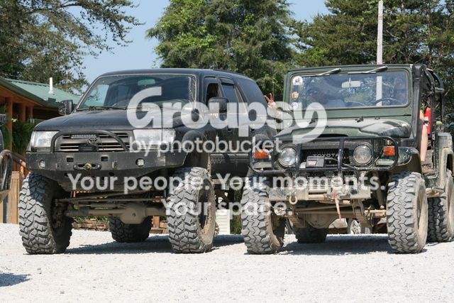

For those that are just skimming for a pic, I'll add one (I do it all the time).
DSC01078_zpsec5e15ad.jpg~original

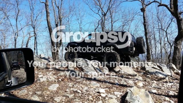

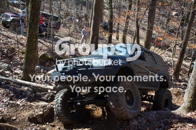

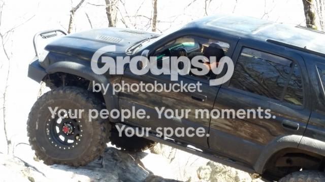

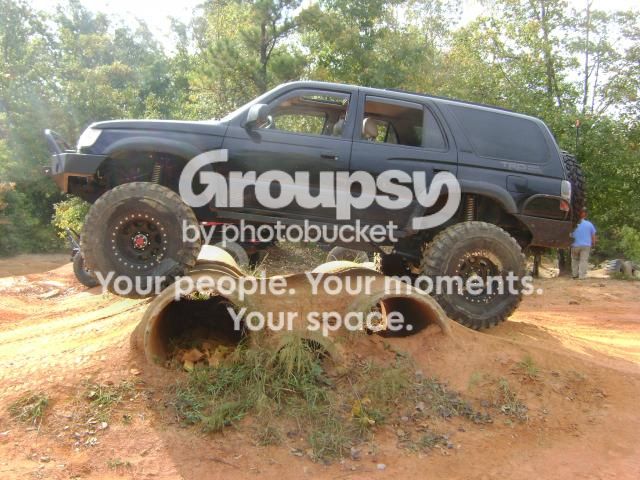

Not much to update on the build, but the wheeling has been steady.
20150207_105754_zps7353e35e.jpg~original
A section called "The Ledges" used to have an easy, moderate, and hard lines. But the buggies have dug it out real bad. So, now it is hard, ridiculous and stupid. I was denied on 'stupid' and settled for 'ridiculous'.
img_9159_zps74560587.jpg~original
I had to stop looking out my passenger window because my pants started fitting funny.
img_9160_zpse123b621.jpg~original

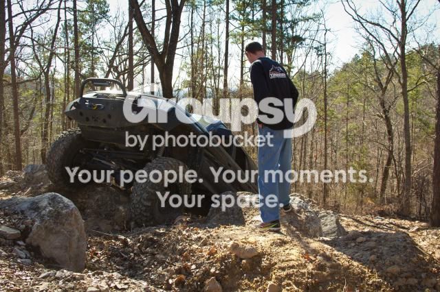

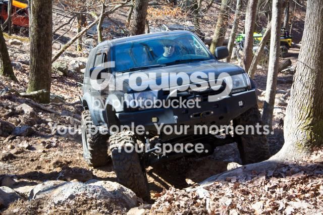

Many of the trails are really tight. I have to plan different lines than the jeeps to avoid losing glass and sheet metal.
img_9035_zps0cc3562a.jpg~original
You can see where the passenger side tree has lots of scars from those that have gone before.

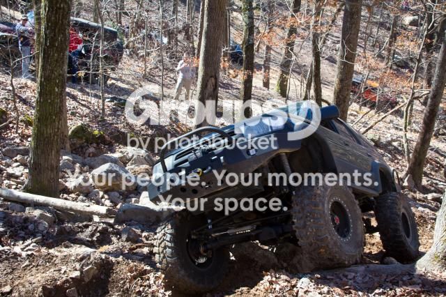

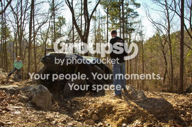

I took a higher line, which felt like it was going to be a flop, but flexed and rolled through without contact.
img_9049_zps52381b95.jpg~original
I really need to catch up with the times and get a GoPro or equivalent. But for now I will keep the pics updated.

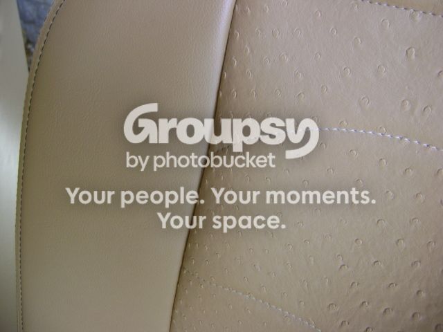

PRP Daily Driver Suspension Seats. Tan, with Ostrich skin centers to satisfy my inner pimp. Options/upgrades include: Double stitching, High back 2 slot headrest, extra tall (+4"), Seat Heaters (D&P), and adjustable lumbar support (D only).

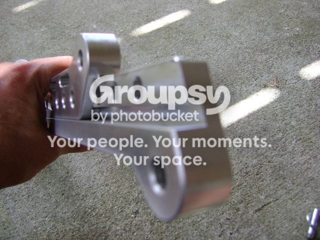

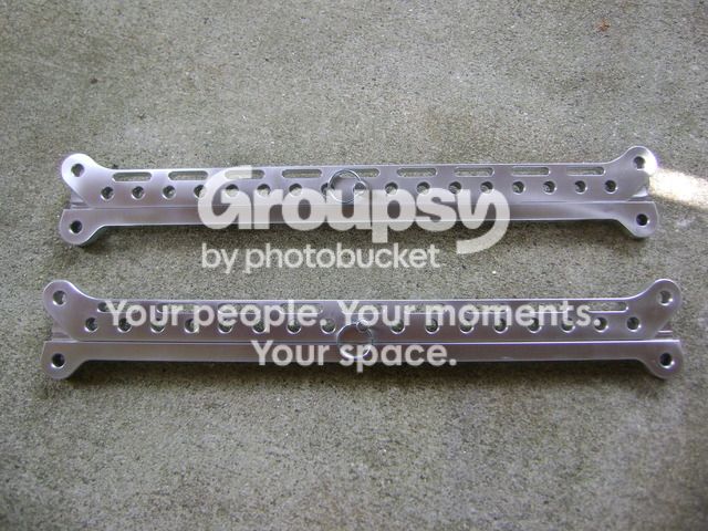

I picked up these billet dog bones made by Chassis Unlimited, in an effort to retain slider function:
DSC01099_zpsyjhh2xoc.jpg~original
Really well made. I got them on sale from frontier4x4.com Thanks Luke!
They are approved by virtually every racing industry. Including U4/KOH. Not that I will be racing anything, though it is nice to have that stamp of approval.
The top and bottom halves "key" together. Slide front to back, and set with a lockout pin.

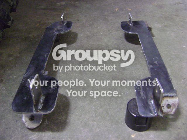

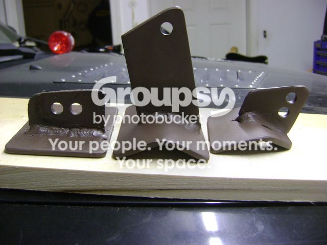

As usual, everything takes longer than expected and my schedule has been hell lately. I started with the passenger seat, and quickly realized the sliders probably wouldn't work. The rear passenger HVAC motors and fans are under the passenger seat and add several inches of height to the floor pan. Not a big deal since the drivers seat is really the only one requiring slider function.
My next plan was to use the factory rails and feet and add tabs for the PRP's. First off, that added way too much height, and secondly removing the feet from the rails nearly destroyed them. I was amazed at how thin the factory feet were.
So it became clear I would be making my own feet and rails.

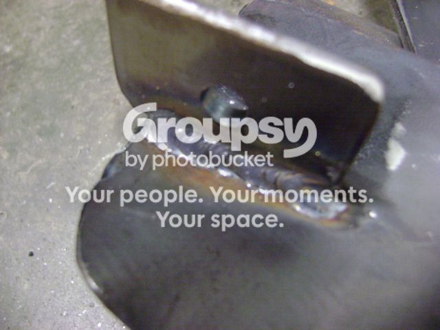

I opted for 3/16" steel all the way around. Much beefier than factory and way overkill, but I had a several pieces readily available. (This process took forever when you have 1-2hrs/night to work on it)
Several bends, cutouts, and welds later, I had these:
DSC01104_zpsuebfv0ur.jpg~original
DSC01108_zpsflldqkk6.jpg~original
I kept them wide for mounting accessories. Extra fire extinguisher, flashlight, etc.
The frame of the PRP's is also steel tubing which makes for a very stable structure.

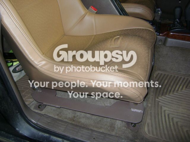

Bolted in:
DSC01124_zpsom8eib1j.jpg~original

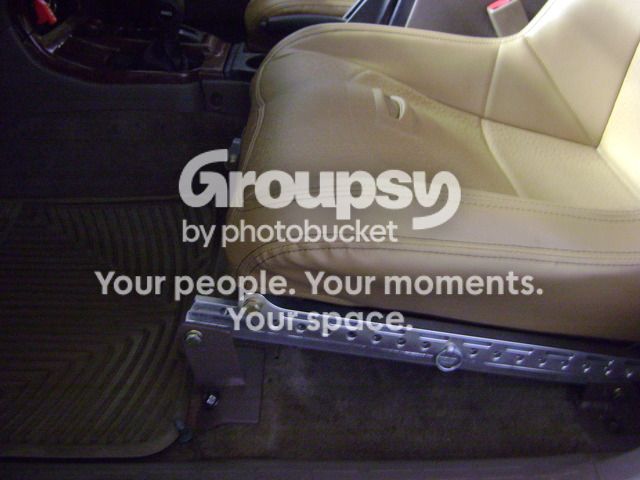

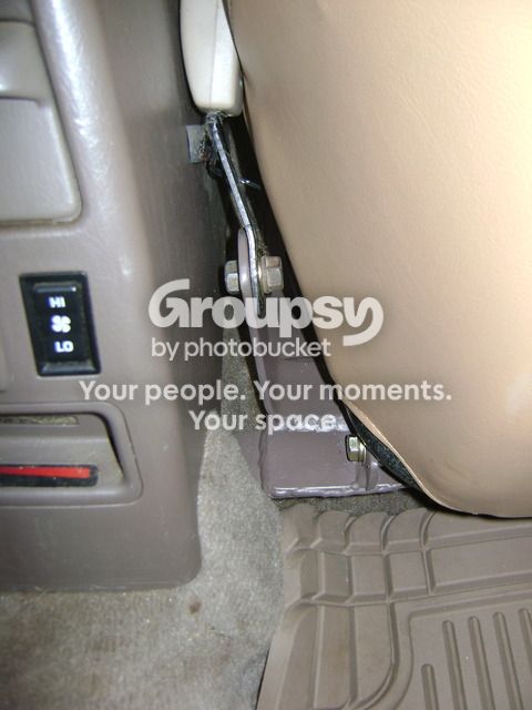

The drivers side had it's challenges as well. My goals were to sit lower and further back than factory. I'm 6'3" and look like a gorilla on a bike when in the drivers seat. This meant, once again, fab'ing up custom brackets. Yet, I was determined to use the sliders on the drivers side.
No 2 brackets were the same, which added lots of time and labor. 2 floor mounts and 2 transmission hump mounts.
DSC01112_zpstsqrylfn.jpg~original

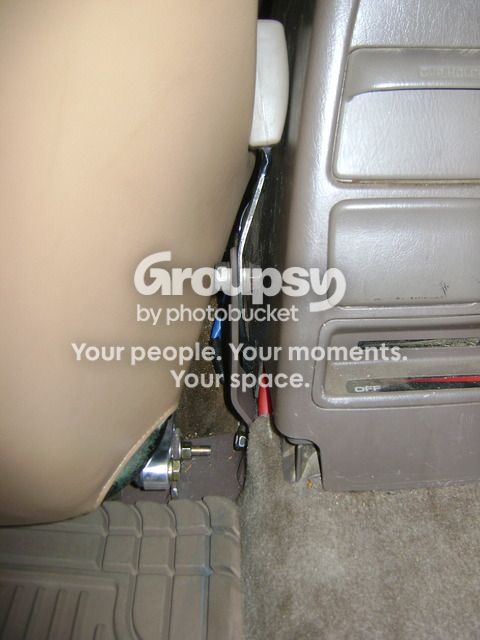

I used all factory mounting points and grade 8 hardware on the seats.
Created another extension for the drivers side seat belt receptacle.
DSC01116_zps7uxzimps.jpg~original
Bolted in. I haven't taken final measurements yet, though I am about 2" lower and several inches further back.
DSC01113_zpsnbl11i4u.jpg~original
DSC01117_zpstmdsuw3b.jpg~original

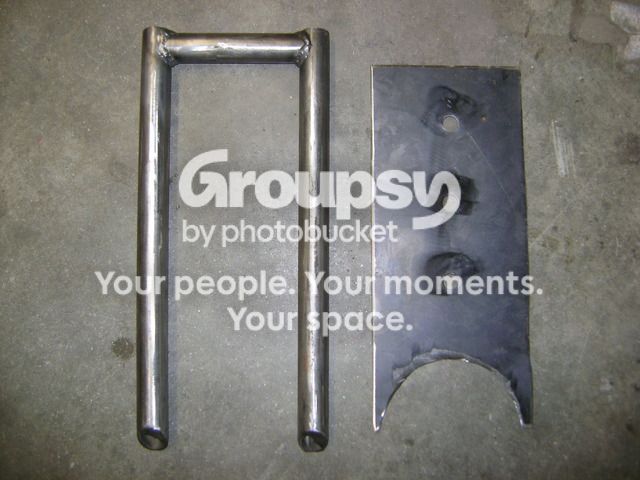

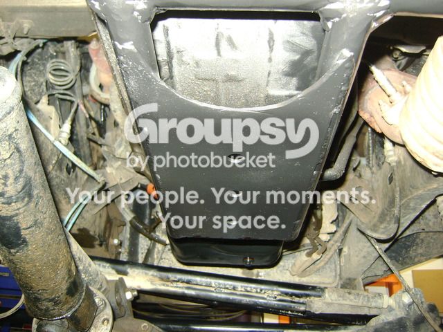

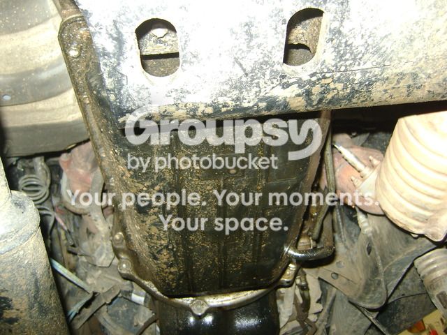

Since the solid axle swap, I've been a little leery of how exposed my transmission pan is.
DSC01130_zps5fmnxuzc.jpg~original
With all the movement of the links, and drive shaft I can no longer run a full belly skid. The pan sits above the frame rails, between the links and next to the driveshaft. So, it would take a really unfortunate shaped rock to get in there. Nevertheless, it looks exposed and I've thought about it more than a few times, especially when climbing ledges. Like this:

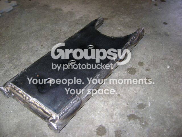

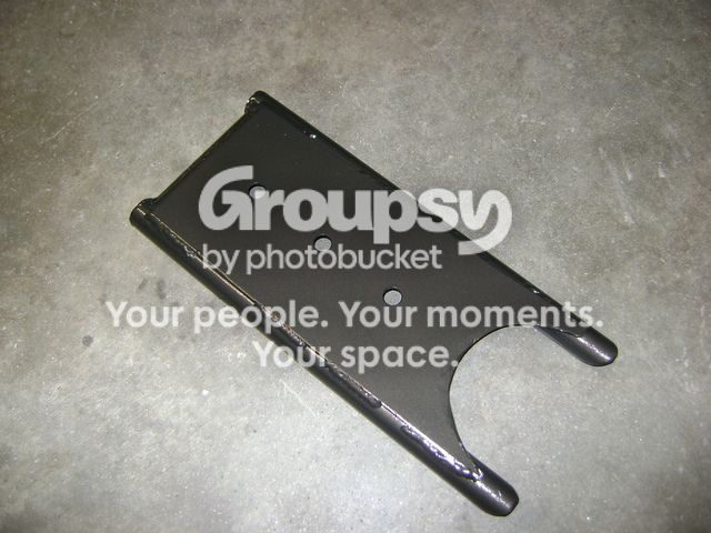

The crossmember I used for the transfer case/trans is 3/8" thick and bolts in/out. It is a massive heavy piece, but stops short of protecting the pan.
I decided to weld on an extension to the crossmember.
DSC01125_zpsnyh77sbj.jpg~original
.120 wall 1" tube, and a 3/16" filler plate
DSC01128_zpscjzv3oqa.jpg~original
DSC01131_zpsyhhy92vl.jpg~original
DSC01141_zpswodnpvn2.jpg~original
That should at least keep the sharp pointy things from finding the pan. I wanted to tie into the passenger side frame rail but there wasn't enough room with my Cali' compliant dual cats. When I rework the exhaust, and drop to 1 cat there will be room.

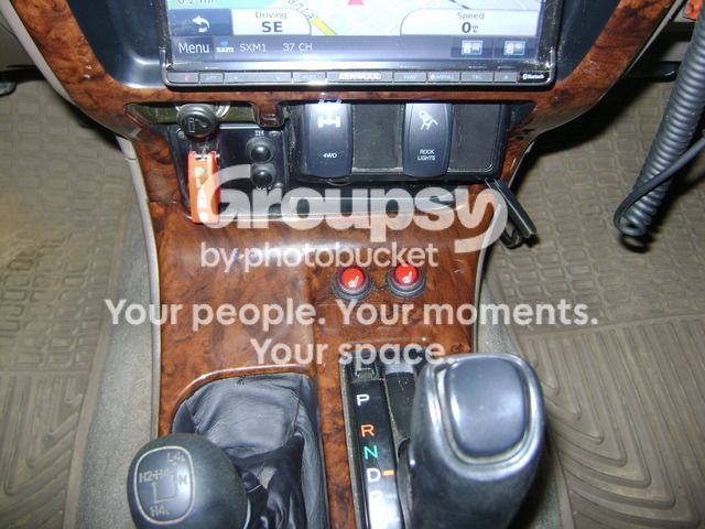

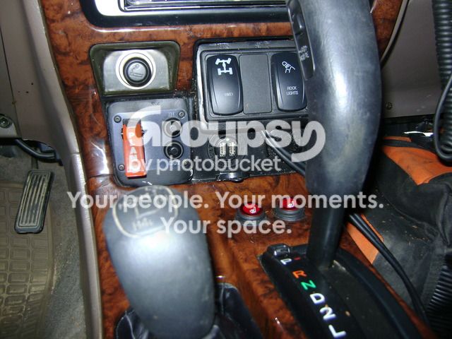

I also replaced one my cigarette lighters with a dual USB socket.
This one: https://www.bluesea.com/products/1016/Dual_USB_Charger_Socket
DSC01135_zpsrrhidkec.jpg~original
Trying to keep the 16yr old truck current with modern technology. GoPro, and all of my iStuff will hopefully be happy now.
