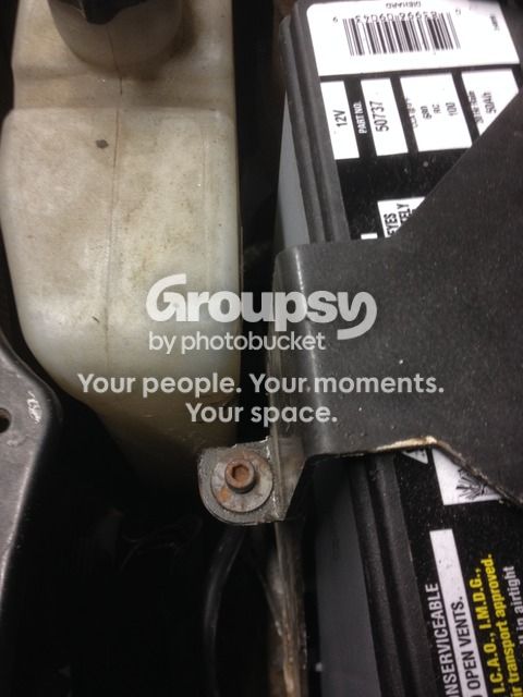

The battery fits great in the battery box. I was talking about when you put it in place of the old battery holder in your rig. It's right against the antifreeze overflow and tight against the fuze box.

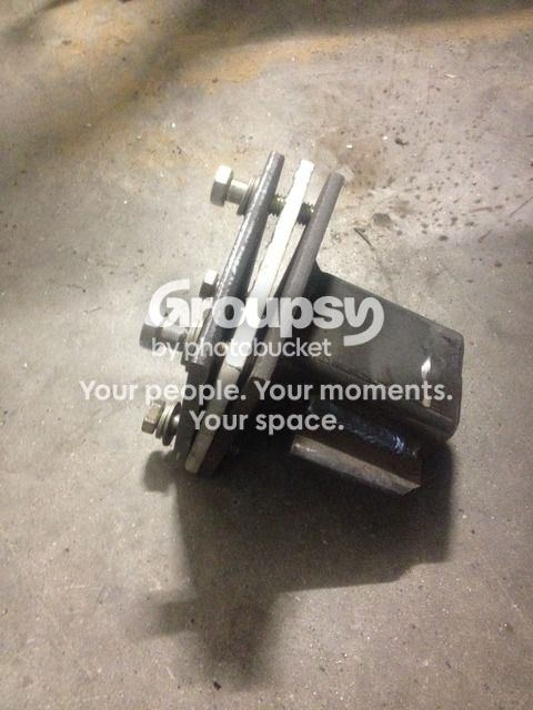

Gotcha. Yes. I basically cut the front mounting tab in half. So it has 1 hex bolt instead of 2. Notched around the radiator reservoir.

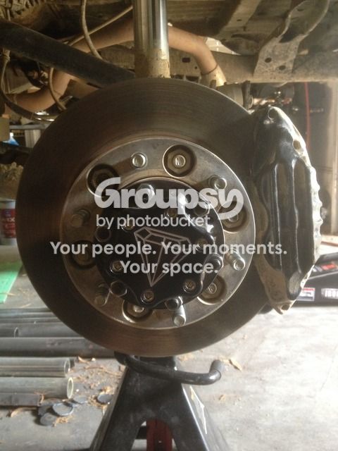

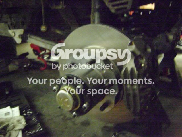

After my Windrock offroad trip, I noticed I lost the end cap off of my rear full float axle. It is just a small tap on cap, and I must have knocked it on something.
It is the small gold colored center cap in this pic:
DSC00734_zps740b719e.jpg~original
It's really just a cap, but the distal end of the axle is exposed when missing. Everybody swears the axle won't work itself out, and I can't imagine the previous tin cap was doing anything other than keeping dirt/water out. Regardless, it looked ominous with the distal end of the axle exposed.
Fortunately, Brian at Front Range Off-Road Fabrication has a pretty trick solution and hooked me up. [MENTION=125440]FrontRangeOffRoad[/MENTION]fab
It is a new flange and bolt-on end cap.
IMG_0996_zps8h8fqlwt.jpg~original
Also has the pimp Diamond Axle logo. Which is about as close to a diamond axle housing as I will come for right now.

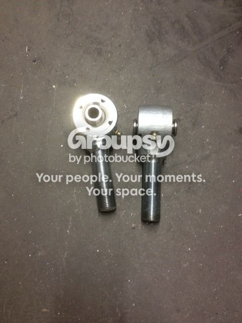

One other small change was getting rid of the heim joints on the rear panhard bar. Those things were clunking and rattling me to death. I switched over to a Ballistic Joint, which is like a currie johnny joint. Greaseable, serviceable, and much quieter.

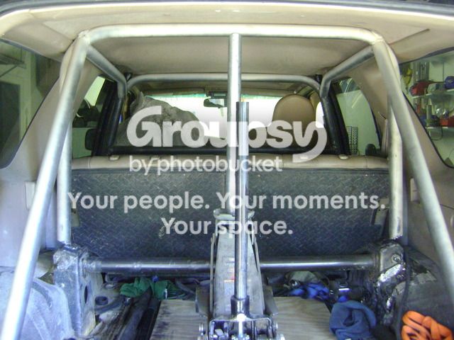

The following is a long overdue update of my build thread. Roll Cage. This project has been on the list for several years and represents a lot of research, rule book reading, web surfing and image saving, cage failure analysis, hand sketches, and bend-tech mock ups. I began the cage in January and mostly finished in March. I have proclaimed it “Done” several times, only to add something, or change something.
The goals of the cage are:
Protect the Occupants - Seems logical enough. Though, there are a lot of cages that are cosmetic, built primarily for accessory attachment, or designed to protect sheet metal rather than people. A flop or rollover in my truck will still do significant damage to glass and sheet metal. However, everybody will walk away and the truck will live on a bit more unsightly.
"Stay In Your Lane" - The scope of this build is a safe offroad cage, that preserves the factory look/design of the truck, suitable for street or daily use, and mostly unimposing to passengers. I have built my truck to be firmly placed in the “Moderate Group” of our rides. I do not, and this truck will not, do 100mph desert runs, or jumps.
Racing Inspired Cage - Please understand, my tired ol’ truck is not going to race anywhere. However, the sanctioning boards of various racing organizations have not just happened upon their cage rules. They are based on structural engineering, testing, and analysis of failures. I read the rule books of Ultra4, NHRA, Rally Sport, and Desert Racing (SCORE). Some key sentences I took away from the rule books and incorporated into my design: (a) The hoop behind the driver must be a continuous, uninterrupted DOM tube. (b) Main hoop must have a continuous, uninterrupted, and unbent diagonal tube from behind driver’s head to passenger side frame/floor attachment. (c) No tube shall terminate midspan of another tube. I only deviated from this on 2 occasions (above windshield and rear cargo roof) due to build plan or general design.
Some rules which are noteworthy, though were not within the scope of this build:
- Anything above 4400lbs vehicle weight requires 2” DOM (ultra4). I’m 5000lbs but could not fit 2” tube in my low clearance design. I used 1.75” DOM, .120 wall as recommended for 4400lbs Ultra4 racing.
- Ultra4 EMC requires a welded door bar, parallel to the ground, connecting A and B pillars.
- Front of cage requires dash bar or cowl bar and an inverted “V” connecting top windshield bar. I can appreciate this structurally, though it was not within the scope of this build.
So with that synopsis of the backstory, on to what you really want. Pictures.

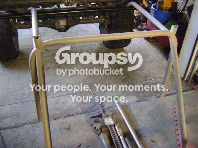

IMG_1171_zpseegt2d37.jpg~original

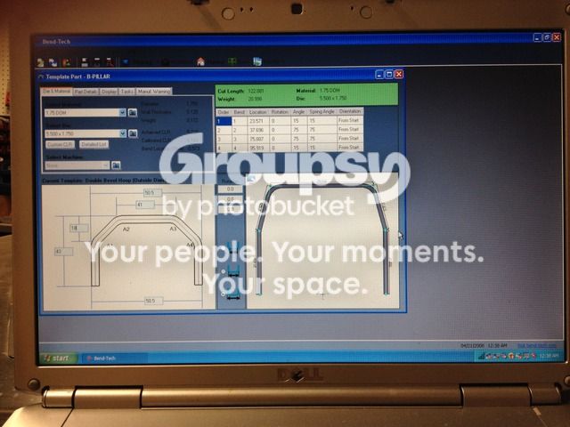

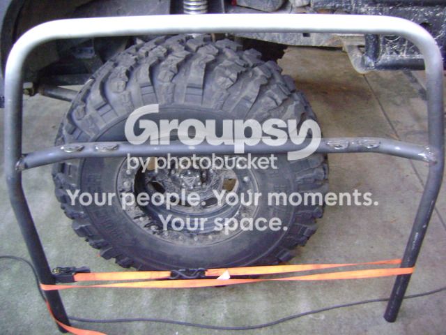

Bend Tech saved a lot of time, and undoubtedly some material, in the hoop design and fabrication. Nailed the B hoop and the C hoop perfectly and had them whipped up and sitting on the floor in about an hour. At this point I was euphoric and thinking I may knock this out in a weekend! However, everything else would be painfully slow progress from here on out and the truck would fight me every step of the way.
DSC01235_zps4hktpci3.jpg~original

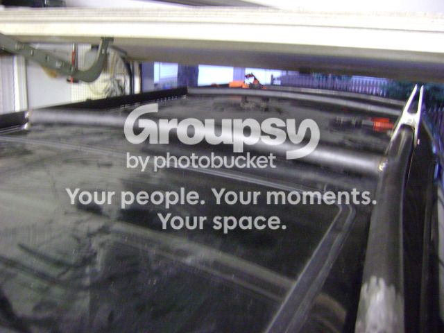

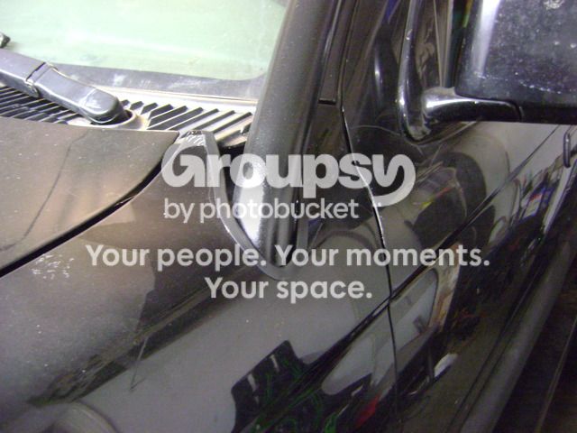

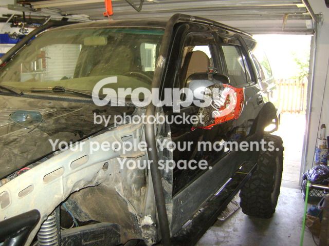

The fenders were difficult to remove since I designed my bumper to hug the body lines and wrap around the headlights. Mocking up the A pillar and the roof portion of the cage. The A and the roof have to be exo since I am 6'3", with an attitude, and building a cage in a Japanese truck. There simply was not enough headroom to do a fully internal cage. This piece, and it's counterpart on the passenger side took forever. It is a 3 bend, 3 dimensional piece. I also used a tubing roller so that the long roof bar would match the curve of the truck and stay tight to the body.
DSC01238_zps2qprxy4z.jpg~original

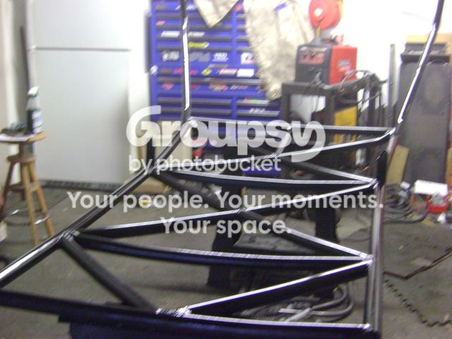

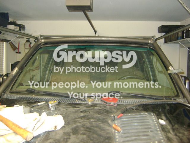

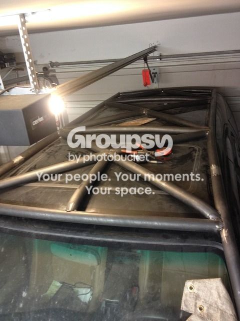

Top Windshield bar and more Tube Roller. Lots of trial and error with incremental changes to get it right and tight. I was shooting for 1/8"-1/4" of clearance all the way around. The body is solid mounted, along with additional body mounts, and reinforced frame. There should be very little movement between the frame mounted cage and body.
DSC01240_zpsn4vrtfbp.jpg~original
Roof cross bars and more roller.
IMG_1224_zpsl0ern0vd.jpg~original
More Triangle!
IMG_1193_zps9lrvfgur.jpg~original
The B pillars and the D pillars mount via 4"x4" 1/4" plates which sandwich the floor with 3/8" Grade 8 hardware. They attach directly to the frame on the underside, effectively becoming additional body mounts. A 4x4 sheet of high density ABS is used to dampen any vibration between frame and body. The A and C pillars are directly frame mounted.
DSC01242_zpsmt00brbv.jpg~original
DSC01243_zpsnzmjgggr.jpg~original

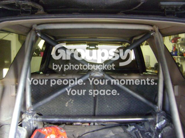

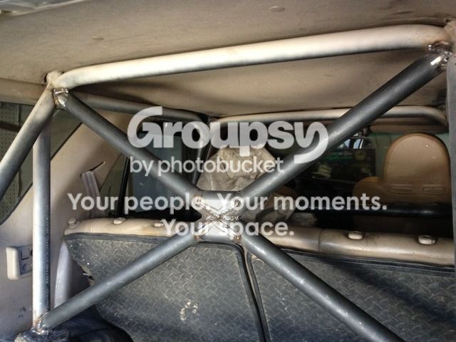

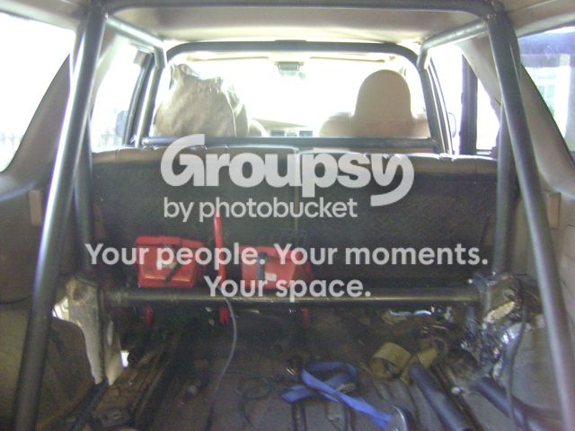

The interior portion of the cage put up a hell of a fight as well. It was extremely difficult to keep everything tight. I designed the cage in 3 sections so that I could remove it, 360 degree finish weld all joints, and then reinstall it. This minimized how many low clearance welds I would have to deal with. The interior cage and the exterior cage are attached via 4 tubes which go thru the roof.
DSC01245_zpsdprfwrhw.jpg~original
DSC01244_zpsu6wz2blp.jpg~original
DSC01241_zps4eckhyqp.jpg~original
B, C & D, and Exo portion all removed for finish weld and primer.
More updates coming shortly. Too many pics for one post.
Thanks to my friend Brant for coming over several times and helping me lift on/off the exo portion. No way I could have done it by myself.
DSC01246_zpsybqwdrrm.jpg~original

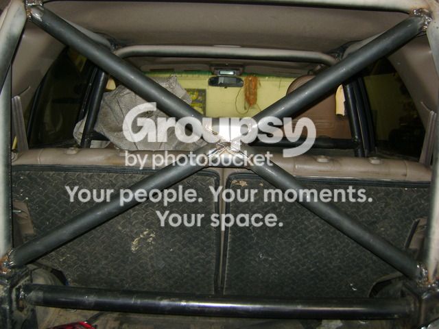

Once the C & D were back in, I used some red neck engineering to push the hoop up as far as possible to give me enough top clearance to weld the exo portion to the interior portion via the connector tubes.
DSC01249_zpstc9ymw0d.jpg~original
More triangulation for lateral strength. Gusseted with saddle gussets which was another pro-tip I picked up from reading the racing rule books.
DSC01247_zps1nmese4s.jpg~original
IMG_1236_zpss7nnnjdd.jpg~original
Interior portion coming together with B,C,D operating as 1 unit and integrating the A pillar/roof exo via thru-roof connections at the B and C hoops.

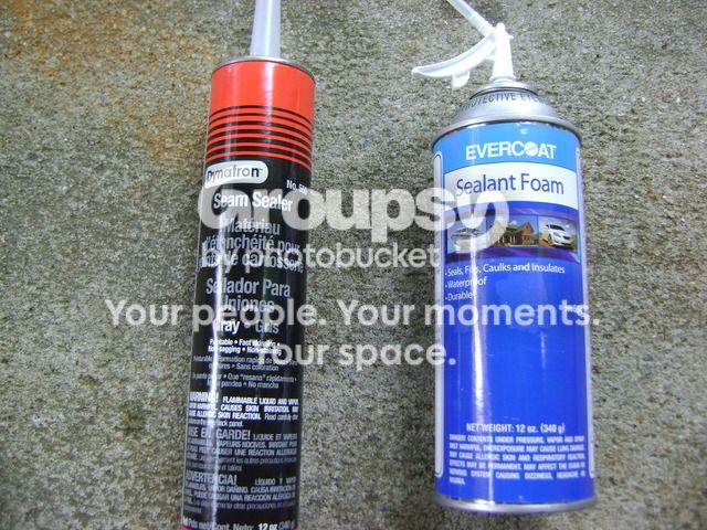

These are the marine products I used to hopefully seal the roof openings. After using them, I have low confidence they will be water tight. I have some other ideas I will try when necessary.

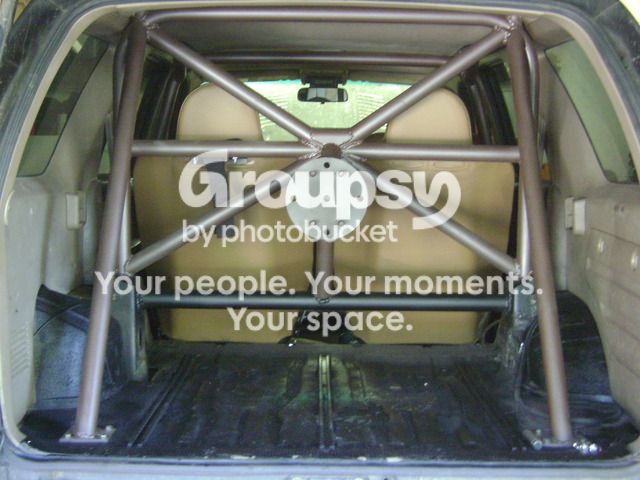

Added an interior spare tire mount. I really like how much more compact the truck is without a 37" tire hanging on the back of it. In addition, the suspension performs much better with the weight directly over the rear axle. I used to have a rear swing out but ditched it. I've been wheeling with the spare in the cargo for about the last 2 years.
DSC01255_zpsyuffxd5v.jpg~original
37" is about as big as I can go in this configuration. I have some ideas on modifications if I ever accidentally go bigger.

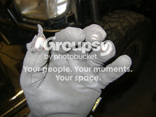

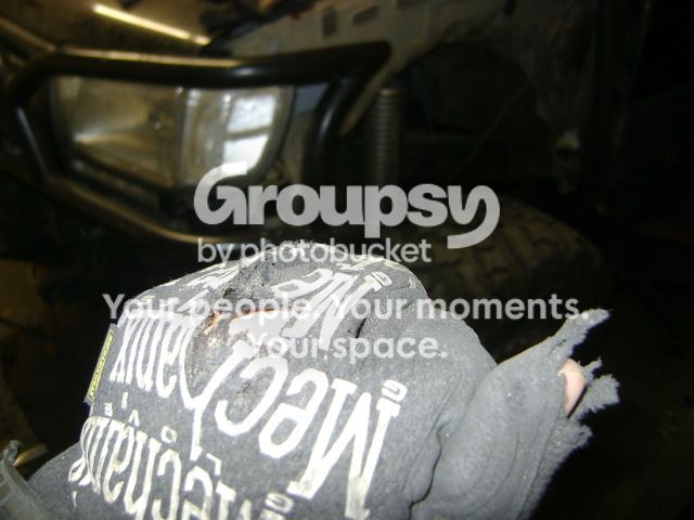

I went thru several pairs of these in the process. Finding a tough glove that still allows for dexterity is difficult.

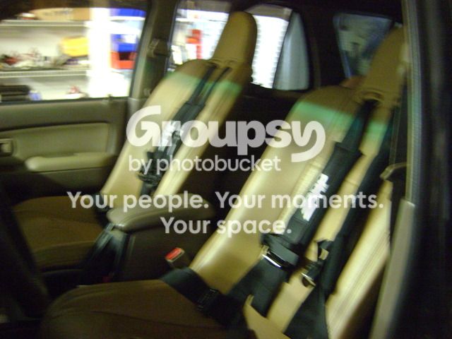

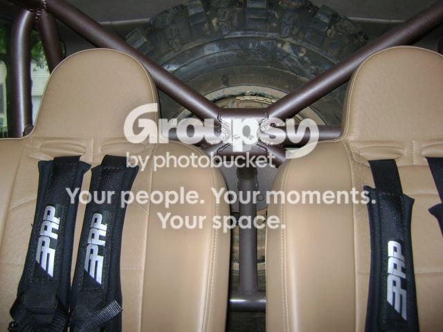

PRP seats and harnesses in rear to match the front. All seats and harnesses are now cage and frame mounted. The rear seats are mostly for kids, and women less than 150lbs; which is another added safety feature. I can squeeze in there but would not want to spend all day back there.
DSC01265_zpsxogiasmp.jpg~original

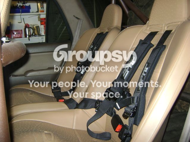

Front seats. I retained the factory seat belt attachments in the front. So, if I am just heading to the store or joy riding the neighborhood I do not have to go full harness.

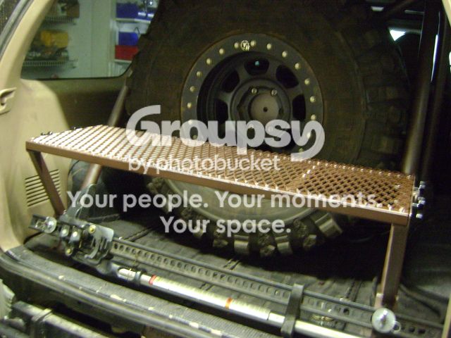

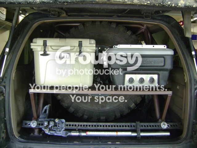

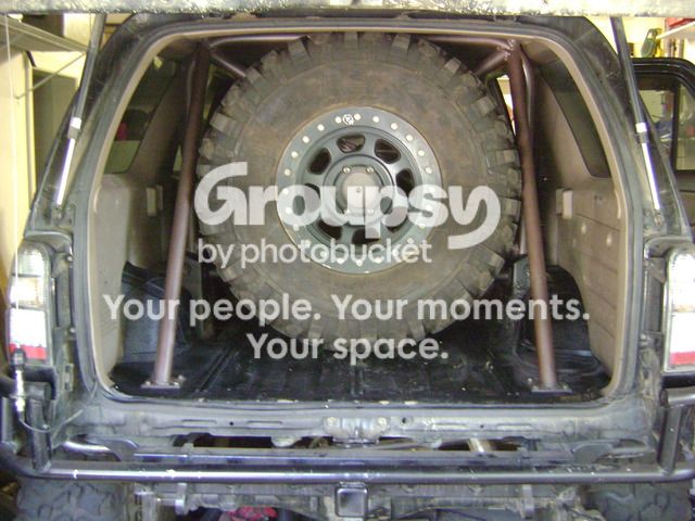

I recognized the fact that the cage and inside spare tire ate up most of the cargo area. It became evident I would need some storage solutions. The storage would have to be easily removable so the spare could be accessed if necessary. Here is what I came up with:
DSC01259_zps0hvocnwp.jpg~original

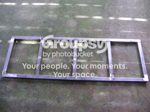

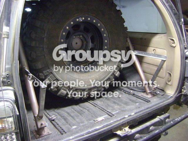

Used some angle iron to make a slide in shelf support and fab'd up some hi-lift mounts at the bottom.

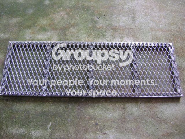

Next was construction of the shelf. 1" tubing in .060 steel to keep the weight down. These are the projects where I wish I had one of the fancy weld tables. Keeping it square and avoiding heat warp while welding was a struggle.
DSC01256_zps9k1sb3wd.jpg~original
Added some expanded metal on top, and ta-da my new barbecue grill shelf is done!
DSC01257_zpskl5xkgff.jpg~original

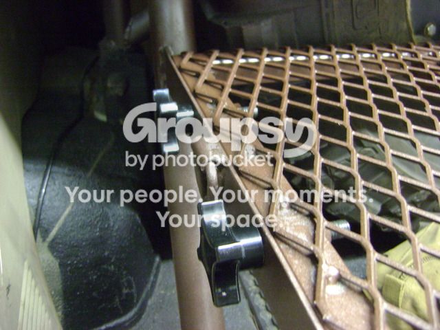

Used 3/8" twist knob bolts to attach, with a welded nut on the shelf, for easy, no-tool removal.
DSC01260_zpswkfhwbaf.jpg~original
In:
DSC01261_zpsflytl0oo.jpg~original
and Done:
DSC01264_zpsai01iogi.jpg~original

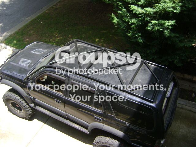

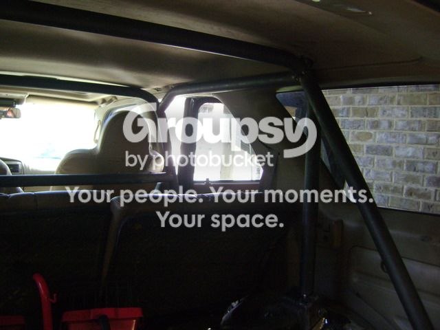

So glad to have this major "winter" project behind me! I'm actually a little disappointed in myself for not doing it sooner. Research "cage fail" or "offroad rollover" to legitimately scare yourself. However, the truck fought me on every step. Everything is low clearance, super tight, and low light. I put together strings of cuss words never before heard by man. But ultimately happy how it came out.
View from the top:
DSC01262_zpsz7ttjvwy.jpg~original
View from the side:
DSC01269_zpsy6lfnysv.jpg~original
