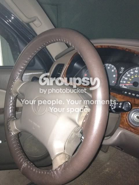

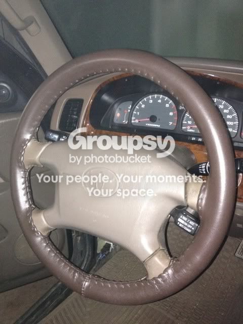

whats good with this steering wheel? cover or re-skin? is there an explanation in your build thread?
[MENTION=90485]URBAN ASSAULT[/MENTION]
I used this one:
Leather Steering Wheel Covers Manufacturer and Distributor
And I've been really happy with it. I have had it on there for a few years. I think I did a small write-up on it a few years ago, back in my yotatech days.
It is genuine leather with lots of color choices. They have a tan, which would likely be a perfect match to factory. However, I was looking for a little contrast, and something that would show less dirt. My factory steering wheel leather looked rough, especially at the 12 o'clock spot.
You stitch this on yourself. Which is time consuming. Save it for a day when you need to clear your head from the rest of the world. Line up a few of your favorite beverages and songs, and settle into the drivers seat. Time consuming but not difficult. If you can lace up your shoes, you can do this.
It does thicken the steering wheel slightly, but I like it, and love the look of it.
Here are a few more pics:
wheel1.jpg~original
wheel2.jpg~original

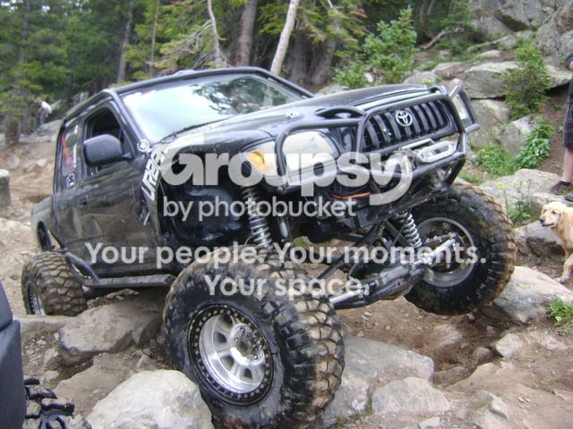

As we discussed plans for the following day, it seemed everybody was going to be doing Iron Chest. Originally, when I registered, I indicated I would do Holy Cross on Friday. I started to get cold feet when everybody else was headed elsewhere. There was another group of rigs coming from Denver and would be meeting at the trailhead. [MENTION=63986]Volcom[/MENTION] said it best, “Holy Cross is one of CO’s legendary trails and if you drove all this way, you have to do it”. That was the nudge I needed, and I was all in. Aaron (volcom) gave me a few directions/landmarks to find the trail and I was set. The next morning I was still hoping for a convoy of rigs lined up at the gate headed for Holy Cross. No such luck. Rolled out solo at 7:15am as it is 2 hours to the trailhead. A beautiful drive though, and you can definitely tell you are heading North in the Rockies as the landscape changes from arid to alpine. Aaron gave me a tip about a sharp 90deg turn in the road, just before the turnoff. Without that tip, I would have missed it. The sign sits recessed off the road, and I would’ve been more worried about making a 90deg turn than looking for a sign. The first of many thanks to Aaron [MENTION=63986]Volcom[/MENTION].
I arrived at the trailhead and fell inline with the group at the trailhead. I would guess we were about 20 rigs to start with. I was a little intimidated as ALL the rigs were extremely well built, caged out, and trailered to the trail. I would later be reminded of the benefits of the trailer.
Holy Cross is an awesome trail. Lots of huge rocks on a narrow, well managed trail.
DSC01171_zpsgokearhx.jpg~original
We quickly traversed and moved over obstacles that would be considered, ‘the best trail ever’’ in the Southeast.
About 2/3 of the way up is French Creek. An impressive section of large boulders generously deposited by the rockies, and annually arranged, and re-arranged with each flood, avalanche, and rock slide. Looking back on it, this was one of my favorite highlights of the trip.

Here is an in-cab video of my crossing:

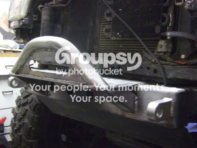

I had wanted to rebuild the bumpers and sliders anyway. I've learned a lot over the last several years and have moved away from the armored truck scenario, to a more simple and functional approach.
The bulk of the work, and the most notable visual difference was the bumpers.

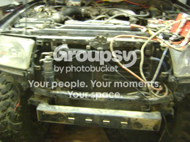

Everything off and ready for a fresh start:
DSC01194_zpsqg0nmyjp.jpg~original

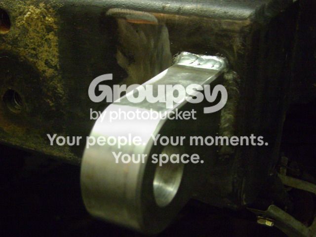

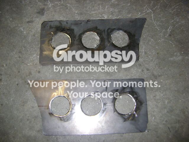

Then added some recovery points:
DSC01196_zpsfud5xs7x.jpg~original

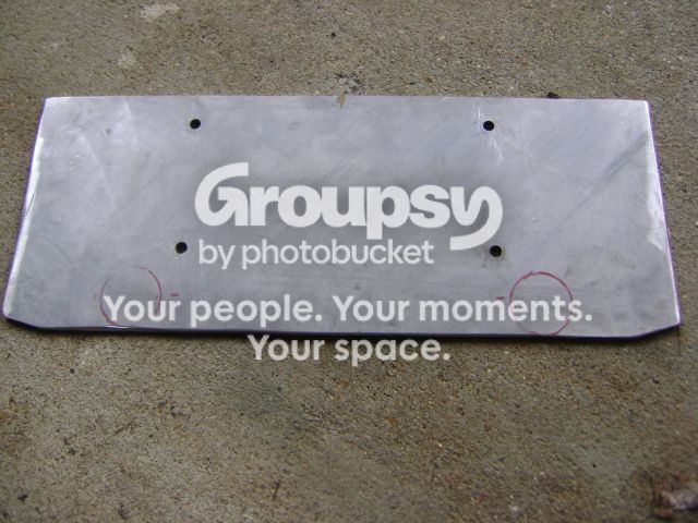

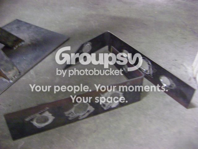

Cut out and drilled a winch plate:
DSC01195_zpswlpchdtj.jpg~original

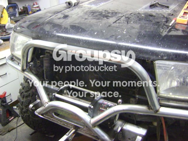

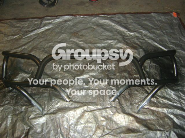

And added the first of many tubes:
DSC01201_zps0ccemgjt.jpg~original
Now that the body is solid mounted, I wanted the bumper to be as close to the body as possible. The winch sits as far back as possible and bolts thru the crossmember.
Starting to take shape:

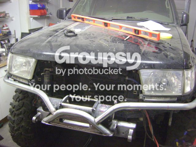

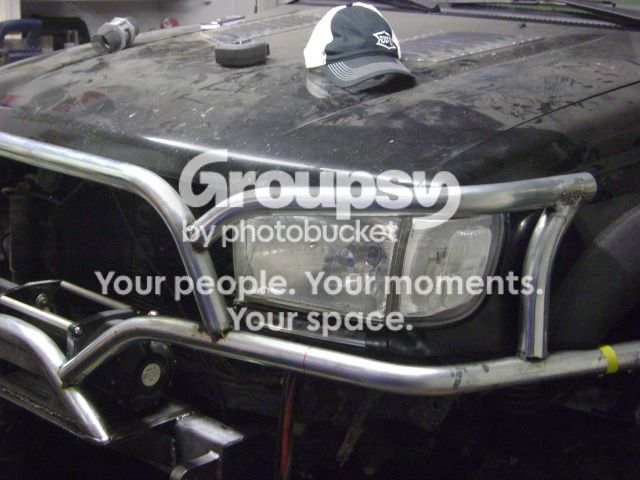

Followed by some headlight protection, with an attitude:
DSC01204_zpsnkyz2oly.jpg~original
And then all off for finish weld and paint:
DSC01206_zpsxvtpdm5v.jpg~original
The front bumper, not counting the winch plate, weighed 36lbs. My old front bumper weighed in excess of 150lbs.

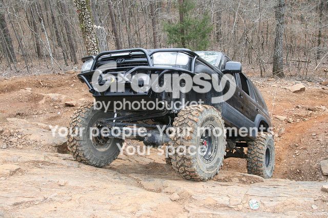

And the finished product:
DSC01226_zpsgjkrk5xh.jpg~original
So, roughly 100lbs lighter, and decreased the length of the truck by 12".
24886259420_b925c91750_z_zpsxfvidafk.jpg~original
And that's just the front end. Rear bumper update coming next...

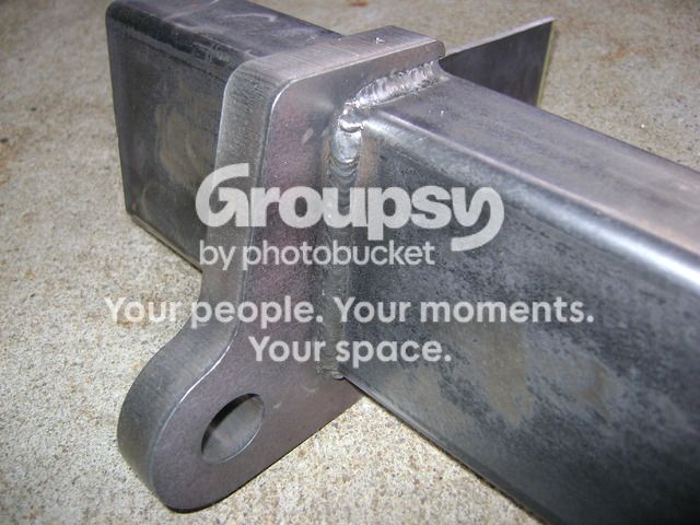

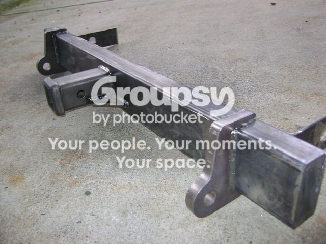

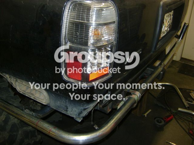

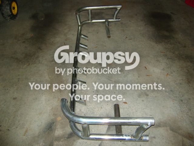

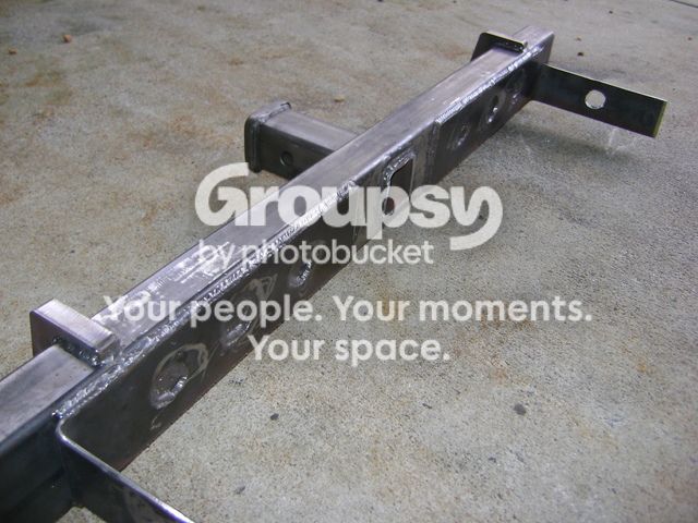

The rear bumper would be of the same mindset. Tight, light, and strong.
Started with a 2x4 3/16" crossmember, and added some recovery points:
DSC01220_zpslopjcr4b.jpg~original

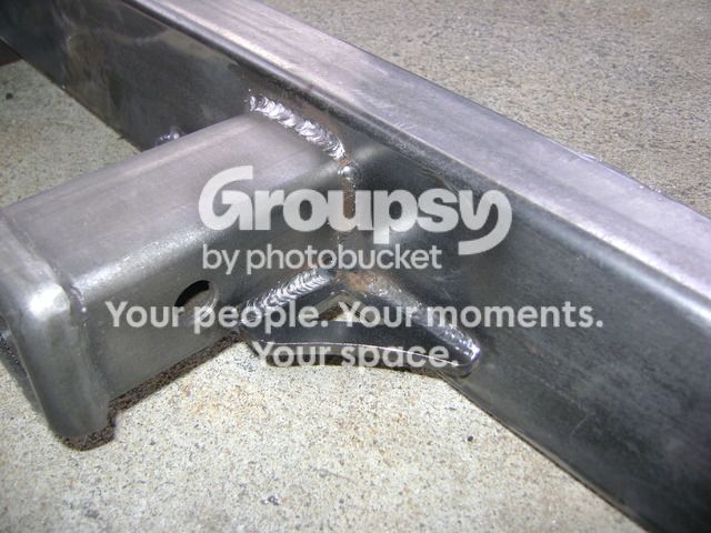

Followed by a trailer hitch and some gussets:
DSC01217_zpsyvfxqydr.jpg~original
Added some frame plates:
DSC01213_zpslj42iz9y.jpg~original
All welded up:
Easily, one of my best pieces to date. Yet, it will live a life of anonymity, hidden under the truck. :pout:

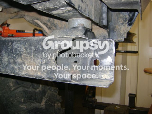

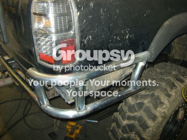

Notched the frame for a solid fit:
And started adding tube:
All off for finish weld and paint:
Added some filler plates to the rear quarters:
And the finish:

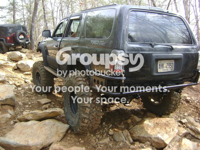

The spare is now mounted inside the cargo area. This reduced the length of the truck by another 18". All tolled, the truck is nearly 3ft shorter and over 200lbs lighter. In addition, it sits over 2 inches lower. That may not sound like much but it makes a huge difference. Most people's phase 1 lifts are usually 3" and it makes a world of difference. Every piece of tube on the truck, front and back, has multiple bends, rolls, and notches. Several pieces have multiple hours into 1 small section. To give credit where credit is due, lots of inspiration from [MENTION=17736]AddictedOffroad[/MENTION] (filler plates idea) and [MENTION=67615]Dirtco[/MENTION] (6 down-tubes to crossmember and notched frame ideas)
The shake out run to Morris Mtn demonstrated lots of rubbing of the rear bumper at full stuff. So my 3-hole filler plate is now a 2-hole filler plate, along with a re-work of the leading edge of the bumper. I'll add a pic of the changes soon.

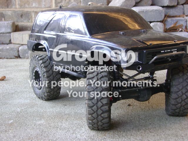

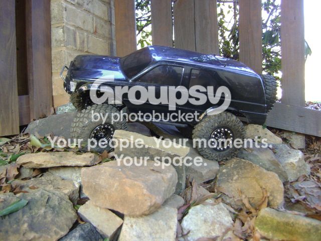

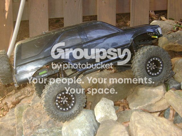

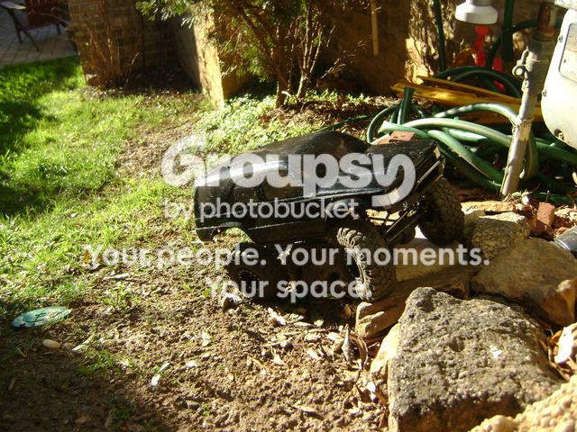

Did some serious wheeling today:
DSC01087_zpsvhttzte7.jpg~original
:laugh: Kinda. It's an RC my 5yr old and I built. Its a 1st Gen body because I do not believe they make a 3rd gen. At least not that I could find. Platform is an Axial SCX10 with lots of mods.
DSC01085_zpszjsf4ee0.jpg~original
DSC01086_zps2rswfd1w.jpg~original
We did a 3 link conversion, metal driveshafts, hi-steer kit, beadlocks, upgraded motor, axles and all metal gears. Pretty much a scale model of Papasan's truck. Also has working headlights, fog lights and taillights.
DSC01089_zpsbowkbrll.jpg~original
The build was good fun. It's just a smaller version of what we all do to our trucks.

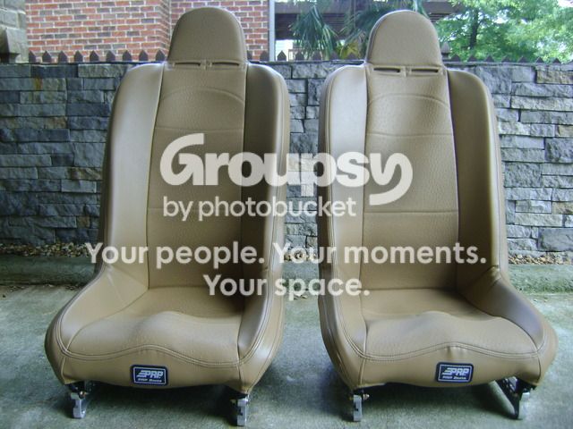

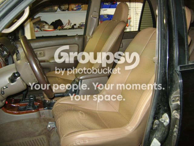

My well-used 16 year old factory seats have seen better days. They have served me extremely well. 300,000 miles and 23 different states. Wheeling trips, camping trips, and road trips. They outlasted 3 dogs, multiple girlfriends, and years of shenanigans. But alas, their job is done.
Enter PRP:
DSC01101_zpsn0iw77z9.jpg~original
PRP Daily Driver Suspension Seats. Tan, with Ostrich skin centers to satisfy my inner pimp. Options/upgrades include: Double stitching, High back 2 slot headrest, extra tall (+4"), Seat Heaters (D&P), and adjustable lumbar support (D only).
The seats look great! I was just looking into PRP today. I might go with the tan suede centers for my inner pimp. :pimp:
