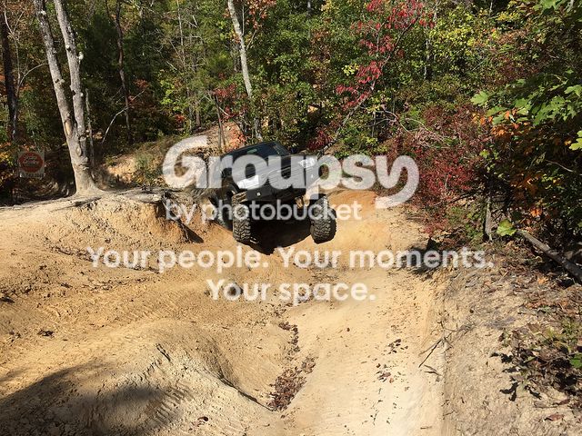

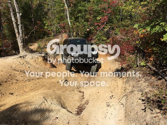

300,000 Miles!

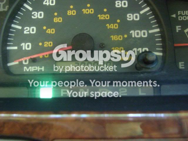

Ticked over a milestone today. 300,000 miles.
DSC01072_zps60cd30a4.jpg~original
I bought this truck new in '99 and 99.9% of those miles are mine. I can think of a few miles where somebody drove my drunk ass home, or I let someone borrow it. Though, for the most part, I can claim all those miles. I figured it out one time, and I have wheeled/camped in 23 different states.
I've been dosing out the miles here recently in order to roll over 300K on the trail. I barely made it. I had just left the pavement, and about a mile up Tray Mtn when it rolled over. An innocuous pic, but offroad none the less.

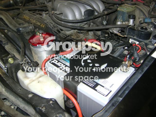

My Optima Red Top started acting up. Didn't seem to ever fully charge, and would really struggle if the truck sat for a few days, or after several consecutive starts in a short period of time. It was about 8 years old, and I believe it was manufactured after Optima's prime. Nevertheless, served me well.
I've heard good things about the Duralast Platinum, and Sears always has sales and coupons, so that is what I went with.
During disassembly I found a lot of corrosion inside the + terminal clamp. It wasn't visible from the outside. In fact I couldn't even get anything in there to break it loose. I disassembled the clamp and soaked it in baking soda. It looked brand new after that. Reassembled with a bit of dielectric grease. That was likely the problem, but I already had a new battery by this point. Oh well.
Everything always turns into more of a project though. The aftermarket battery box I had was specifically for an Optima battery. The new Duralast did not fit securely in the box. I could've modified it and bent up a new lid etc. But Ballistic makes a box specifically for the Duralast. AND...It has a skull on it!!! :evil: That is at least +50hp right there! Couldn't pass it up. Ballistic 34/78 Die Hard/Odyssey DT Battery Box
So, what I thought was going to be a 20 min battery swap turned into a long drawn out project of ordering, waiting, uninstalling, painting, installing, etc, etc.
Here is the result:

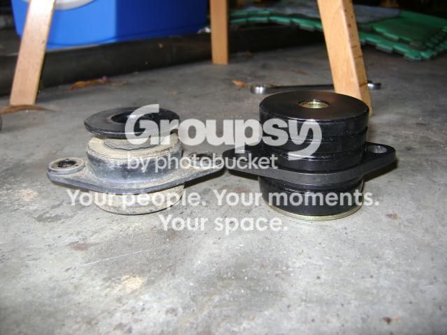

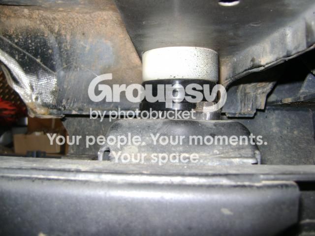

I also finally got around to replacing the rear body mounts. The factory body mounts have a lot of movement and allows for a lot of frame vs body twist when all flexed out. I realized this from some bumper contact on the body, and also the temporary dynamat I put over my in-cargo coilover mounts was nearly ripped off during my last offroad trip. Evident there is a lot of movement.
Sonoran Steel makes a bolt in polyurethane replacement. I seemed to remember some mixed reviews of these in the past but I went ahead and gave 'em a shot. These:
Rear 4Runner Polyurethane Body Mounts (Pair) - $75.00 : Sonoran Steel, Sonoran Steel Custom Metal Fabrication L.L.C. Custom Toyota Truck Parts
They look a little taller compared to stock, but I think my 15year old 300k factory spacers were shot.
DSC01074_zps7aa80818.jpg~original
They are kind of a PITA to get out. Like most things on the truck. If you can see it, you can't reach it, and vise versa.

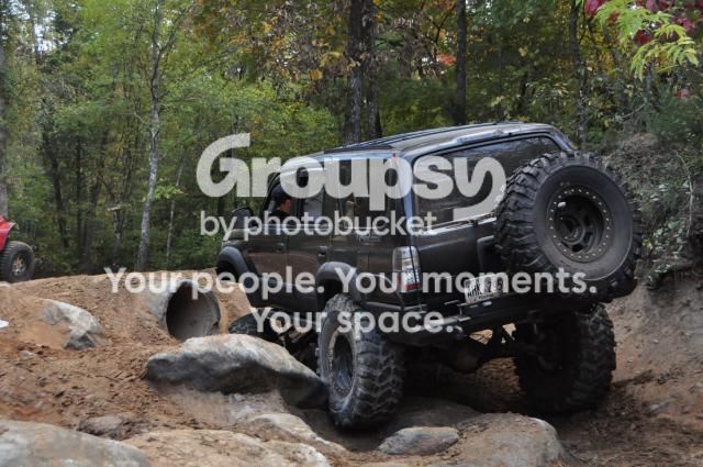

Wheeled at Gulches Off Road Park in South Carolina this past weekend (Fri-Sun). It is an annual festival for a local offroad club 'Georgia Trail Riders'. Great group of guys. 99.9% jeeps, [MENTION=67110]RedDragonATL[/MENTION], me, and 1 sick Tacoma.
On this particular trip, I was the only non-jeep out of nearly 50 rigs. Not uncommon around here.
I like wheelin' with this particular club because they are organized, consistent, and responsible wheelers.
Anywhoo, on to some pics:

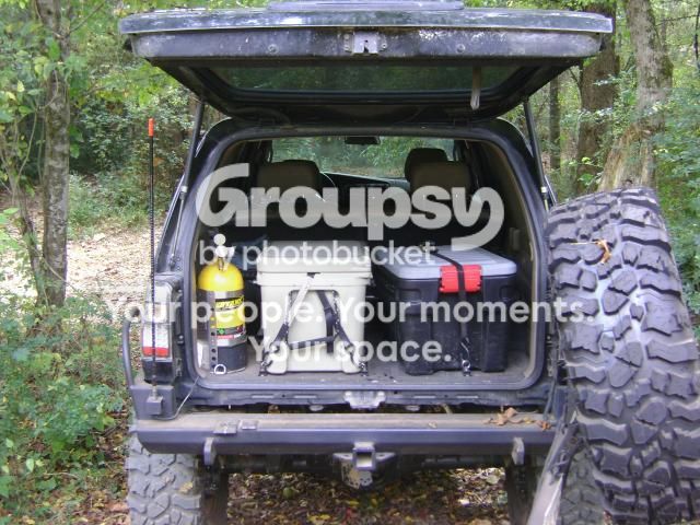

Once the camping gear comes out, this is about all I wheel with. Huge improvement over previous years. A spare driveshaft and highlift is mounted to the coilover tower spanner bar, just behind the Yeti and action packer.

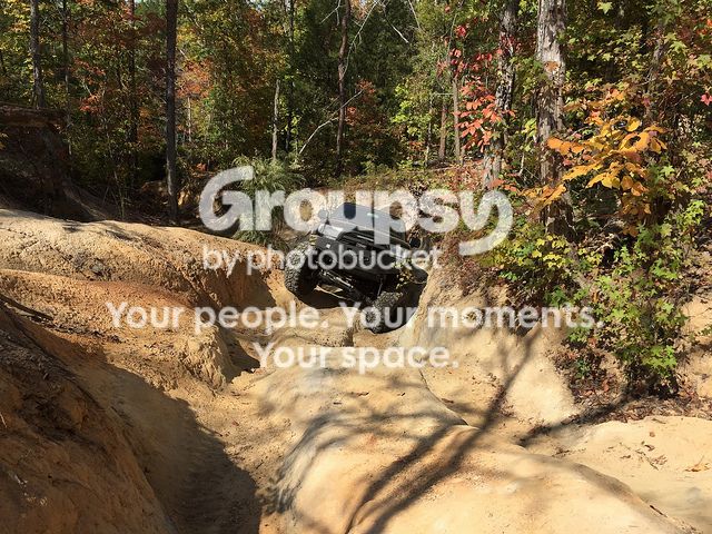

Cool sequence:
15330177068_48d976b41b_z_zpsc660a5de.jpg~original
15330179048_1b7ba0c1bd_z_zps5fc9ac95.jpg~original
15329930459_475cb000f8_z_zpsea30b3e9.jpg~original
15516845405_3ff2b6616d_z_zpse92a43f1.jpg~original
CAM00850_zps96adb5b8.jpg~original
Gulches was a small park for a big group. Hit several of the trails multiple times and missed out on 1 great trail due to a jeep breaking down right in the middle of it.
