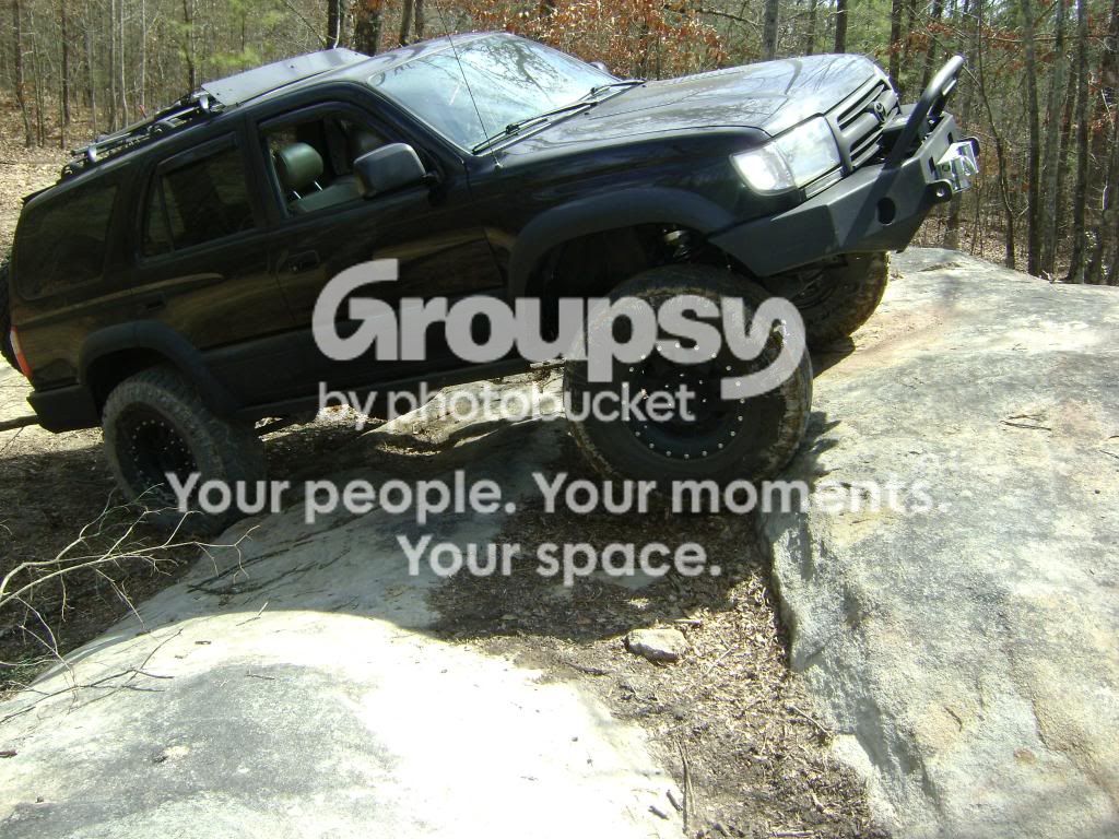

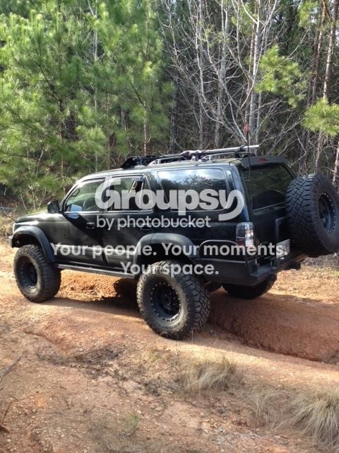

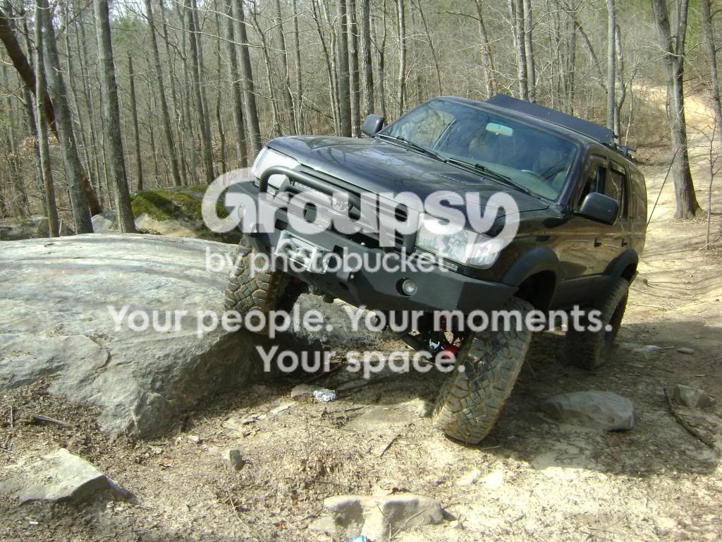

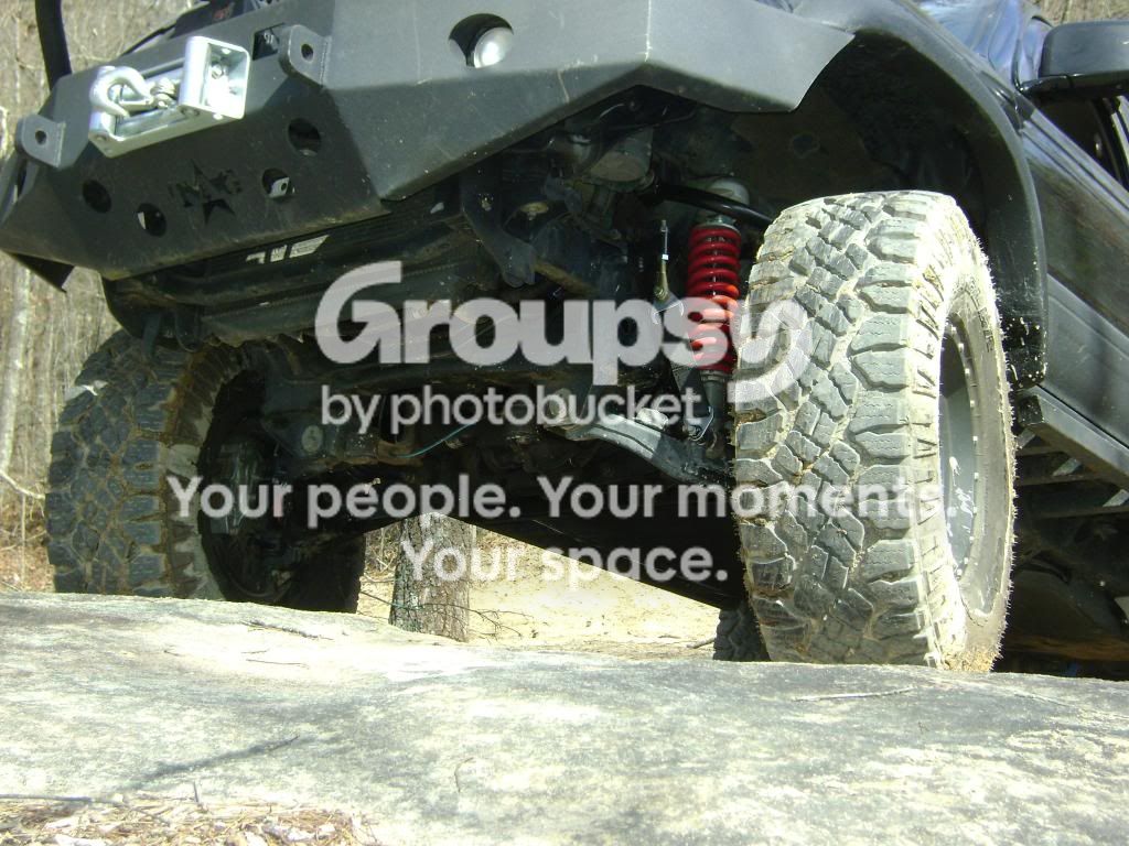

I did a little off roading yesterday to test out the limit straps, cv's, etc. Nothing too crazy, since I haven't put the front skid back on yet. I want to change the front dif oil before I wrestle that thing back on.
DSC00597_zpsc00f5939.jpg~original
I kept trying to find a place to wheelie a front wheel off the ground to fully test limit straps. I couldn't seem to make it happen. When I don't want it to happen, I can't seem to keep it on the ground.
DSC00600_zpsd59976c0.jpg~original
DSC00601_zps720a9ca4.jpg~original
DSC00599_zps0faa309d.jpg~original
Everything worked well. I am going to take care of a few more details, put the skid back on and take on a tougher trail in a few days.

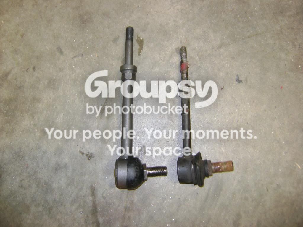

I threw a few new things on my rear end (no homo). First I swapped out the factory rear sway bar links, for some new front links. They are about an inch longer and better suited for my current lift and flex. This is not new to most, but somehow I missed this step until now. Really old vs. new:
DSC00602_zps04668364.jpg~original
An inch longer is about the most you could do without contacting the lower links during articulation.

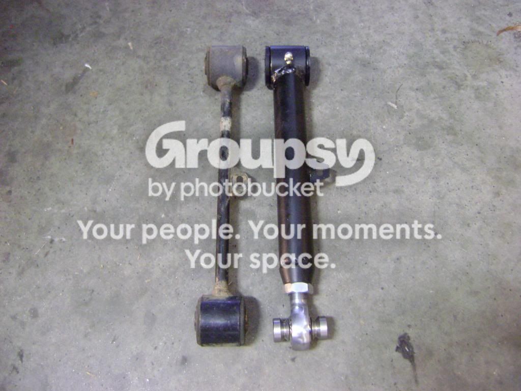

And speaking of links, I replaced the wimpy rear upper links with some beefy ones from Toytec. I kept loading up my online cart with heim joints, weld washers, misalignment spacers etc and threatening to make my own, but ultimately opted for Toytec's. Time has a lot of value to me right now. I am really happy with them. I adjusted in approx 1/4" of length increase. Big improvement on driveshaft angle, and seems to eliminate some driveline stress.
DSC00616_zps5eb3997b.jpg~original

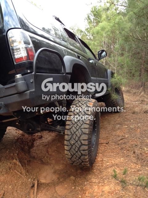

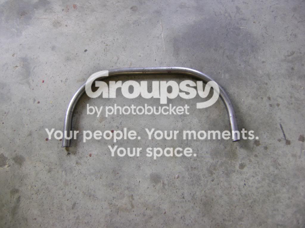

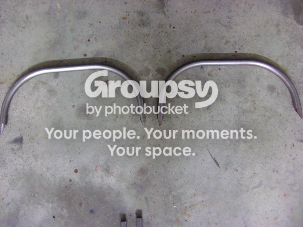

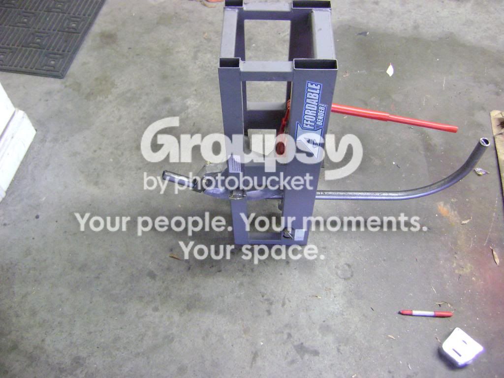

Lately, I have been jealous of some of your CBI bumpers. I really like the rear quarter panel protection option. Last month, I had to make about 10 attempts to turn a corner in a rutted out dry river bed without scraping up the RQP. Took some flack from some heepers in the process. Just because I want to go off-road doesn't mean I have to drive a mud covered raisin. A simple rub-rail was all I needed.
DSC00609_zps10869f98.jpg~original
A couple hundred jack pumps later:
DSC00610_zps08064b50.jpg~original
It is .120 wall 1" steel tubing. I went with 1" because I can bend it at a 5" radius vs. a 7" radius on everything bigger. The load rating is still very high for the .120 wall, and this rub-rail 'shouldn't' be bearing the full weight of the truck during a rub or kick-out.

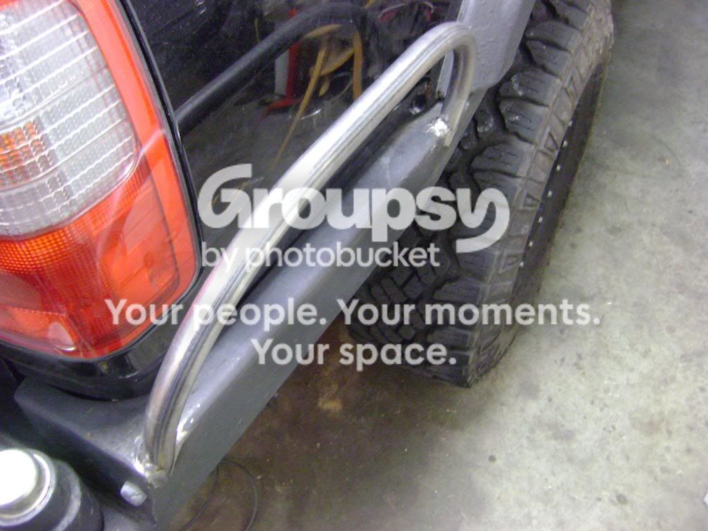

Added a 'fish mouth' to get good surface area on side and top of rear bumper

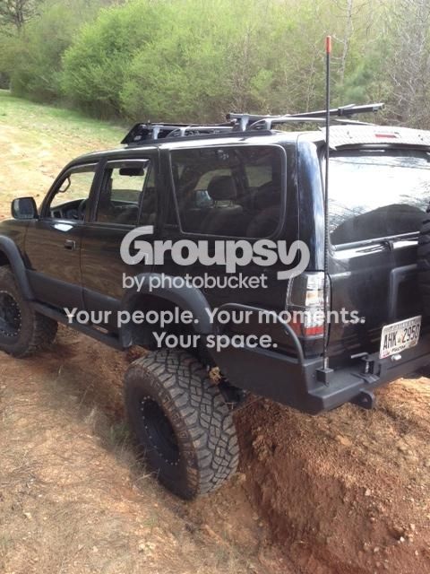

DSC00611_zps11db4897.jpg~original
Welded it on. Angled it out slightly to same width as fender flares and to give a little forgiveness between panel and rail in case it gets bent.
DSC00612_zpsb803e8dc.jpg~original

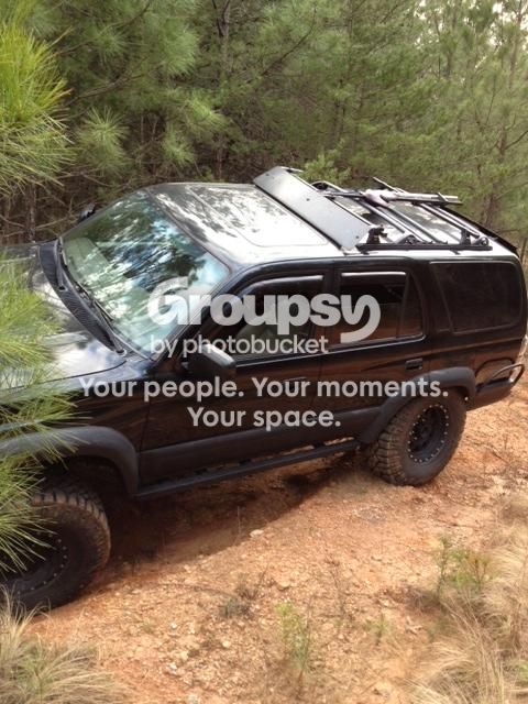

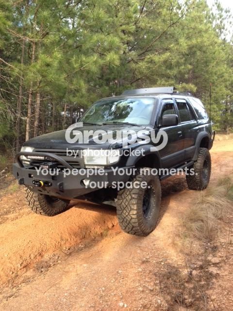

Schedule has been tight lately but found time to venture out to a fire road not far from my office.
april135_zps5c3006b9.jpg~original

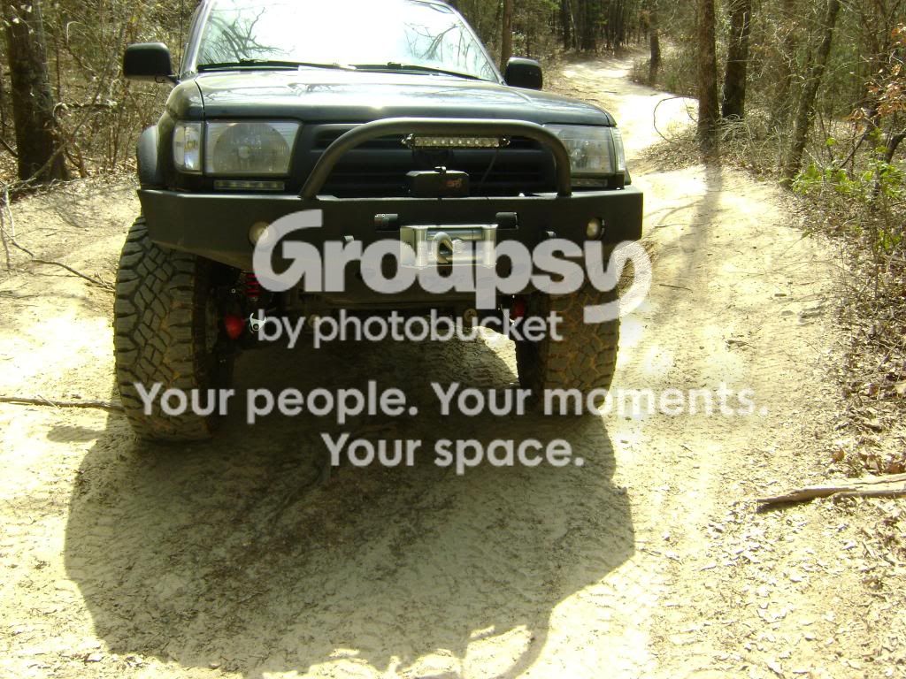

Also, a few weeks ago, I put my winch on a diet and swapped out steel cable and roller fairlead for synthetic rope, thimble, and aluminum fairlead. I bet the weight savings is in the 35-40lb range.
april134_zps8fa11dc4.jpg~original
april136_zps07e56b19.jpg~original

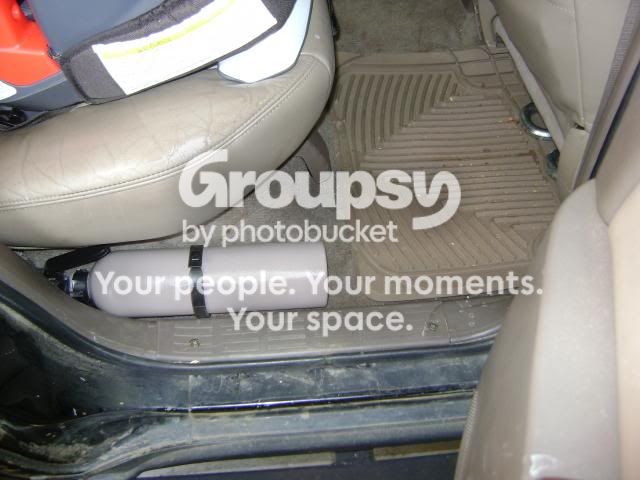

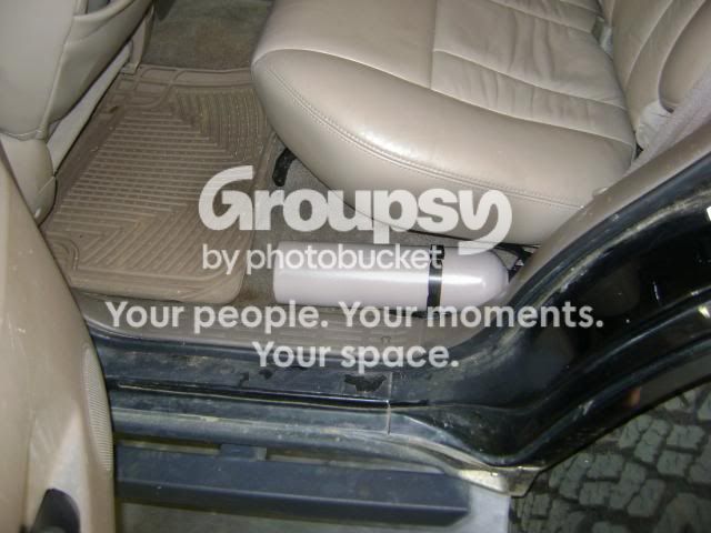

Sometimes I get the most satisfaction out of simple, yet original ideas. Like color-matched fire extinguishers and the perfect mounting spot.
Driver's side:
DSC00621_zpse8d55b5c.jpg~original
Passenger side:
DSC00623_zpsbebdd3d4.jpg~original
2.5lb fire extinguishers, rattle can'd, and several coats of enamel for toughness.

RE the car seat, my baby girl is still in a rear facing seat. I know she can't wait to be front facing though, because she gets bored staring at the dogs, the headrests, and the headliner. She'll grow up soon enough, though. Probably more like TOO soon.
That's a good place for the FE's. I have mine in the back on my storage box, and there have been several times where I've wondered if I could get to it quickly enough in an emergency. A matter of 10 seconds could save a lot of damage if you have an engine fire.

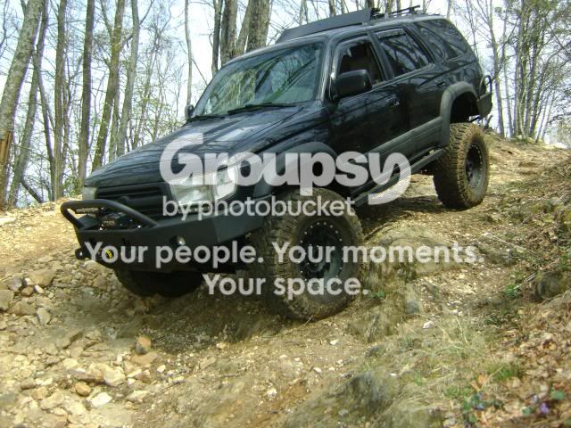

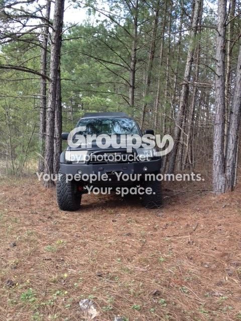

I checked out a 'new to me' fireroad yesterday. I've heard of this spot a few times, and a local club has an event there so I figured it was worth a look. Fireroads are common 4WD spots around here. They are legal forest service roads often leading to overlook points, weather monitors, or towers. Most are easy and simply gravel roads, but others can be a little more challenging and at least satisfy your offroad itch until you can get to something bigger. This one was steep, rutted out, with some rugged granite near the top.
Funny thing was that my in-dash Garmin GPS still recognizes this as a road. So much for county maintenance.
Nice views from the top of Bell Mountain. If you are used to looking at the Sierra's or the Rockies then not that special, but not bad for the Appalachians.
If you look close, you can see a couple of hawks flying near the cliff side. Not often you can get a pic from above the hawks.
Bad news is that there is tons of grafitti and trash at the top. Which means eventually this road will get closed, like so many others, thanks to morons.
It was fun, but not that challenging. I did notice a little steering rack noise though. I've already done the poly bushings, ITR's and OTR's. I need to crawl around under there for a while and probably hit the search function a bit. Will update.

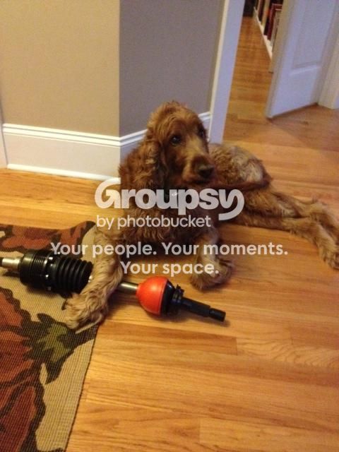

Also, may finally have the whole RCV thing figured out. What a nightmare this has been. I should have the new set in by the end of the week. This will be the 3rd set they have sent me. Ridiculous. Will post up a full review at that point.
I really hope they have the details sorted out, otherwise, Chewbacca gets 'em.
