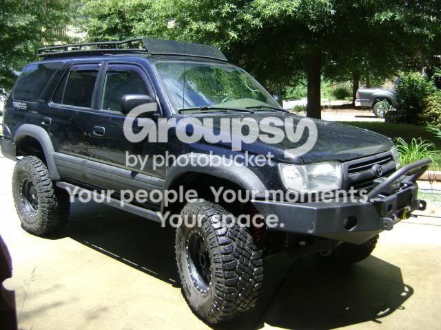

Urban assault's '99 4runner build
Damn those are sexy! Really glad to hear they finally got you set up with what you paid for. Let us all know when you head back out west, I foresee a big 3rd gen rally.
Amazing build!!! Mines still in the early stages of my build but I am looking at either going CVJ or possibly RCV. It sucks about the issues you have been happening. But it looks like they are trying to resolve the issue. At least they are taking your input and real world testing to better their design.

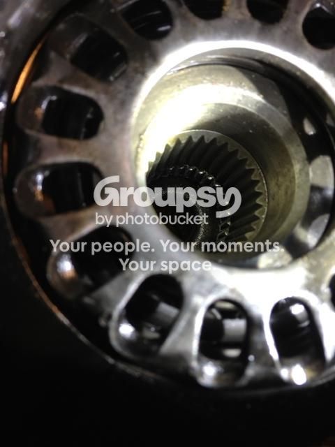

Also, as I tore into the truck I realized the problem was more involved than originally anticipated. The spider gear in the rear diff had also split
If you look inside the sleeve of splines, you can see the split. It knocked down the leading edge of the splines on the old axle. Fortunately it stayed intact and allowed me to get off the trail and home. The rear diff came from East Coast Gear Supply last year when I re-geared to 4:88's. I cannot say enough good things about that company and their employees. They were amazing in backing up their product, customer service and turnaround. So many other companies in the off road industry could learn volumes from ECGS! Thanks to Casey, [MENTION=51127]Dous[/MENTION] for literally shepherding my rear diff thru the process. Everybody can debate 4:88 vs 5.29, but there is no debate as to where to get them. Drivetrain Specialists East Coast Gear Supply

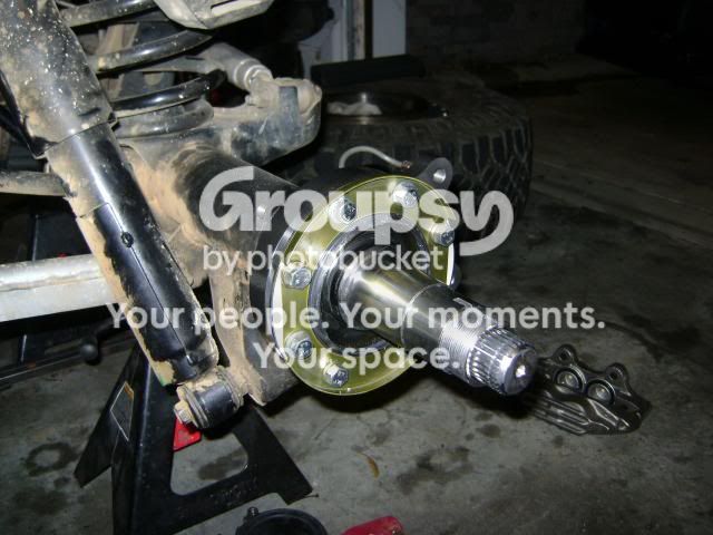

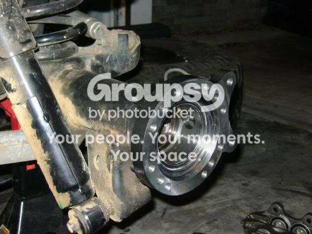

The foundation of the kit is the adapter which bolts to the housing via some large arp studs. Everything from your old drum setup can go in the scap pile. I enjoyed junking that stuff.
Here is the adapter bolted up
I painted everything except the sealing surface. Otherwise, the adapter will be exposed to the elements.

Spindle and seals mounted up:

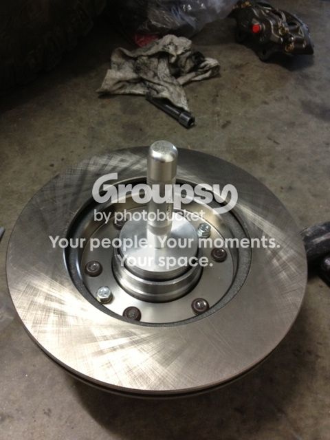

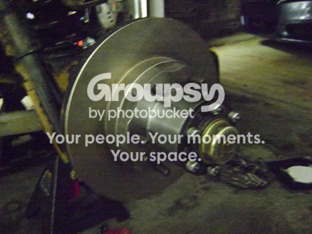

And the new FJ-60 Vented Rotor, and chromoly hub:
Sorry for the crappy late night pics. I basically work all day, play daddy day-care all evening, then play with the truck after everybody goes to bed. Sleep is over rated.
I went with new SW13 calipers. These are 4 piston calipers and were stock on front solid axle toyota trucks. A quick google search will show that all the import track racers (nissan, toy, honda etc) are wanting this caliper setup for its stopping power.
Also the trail-gear 6pin drive flange and cap, with new ARP studs.

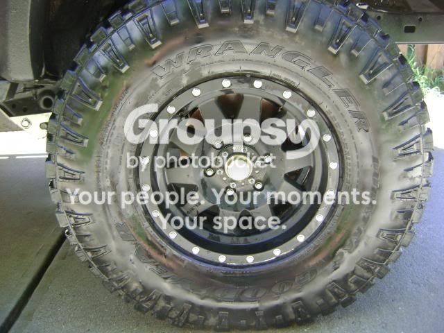

It looks so good I almost hate to bolt the wheel on. But, at the same time, I can't wait to get it dirty.
The rear-end is basically all new. Diff, axles, hubs, spindles, brakes, etc, etc, etc. There were a lot of twist and turns in the process. I also added a manual proportioning valve next to the master cylinder to adjust the rear brakes. I will get some pics of that. As a result of ditching the ABS, my speedometer is acting up. Though, I've got a solution for it and will post up pics for that as well. Like so many before, I just became anxious to finish up and get back on the trail.
And a driveway poser since I was so excited to get it off the jackstands

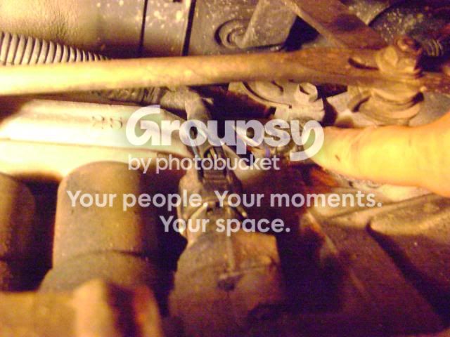

First, I located the speed sensors on the transmission. If you do not have a speed sensor then there will be a plug. In which case, you can add one. I located mine on the drivers side of the transmission.
There are 2 sensors there. One 2 wire sensor and one 3 wire sensor. I used the 2 wire as it is the exact same thing as the 2 wire wheel speed sensor that I deleted. My particular sensor had a yellow/red wire, and a red/white wire. A quick test with the voltmeter showed the yellow/red wire to be the positive (signal) wire, and the red/white wire to be the ground. I believe these are 4 pulse sensors, meaning 4 pulses per revolution. My head was spinning after reading way to much about sensors, square waves, oscilloscopes, etc, etc.

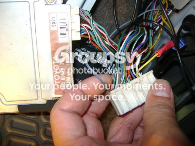

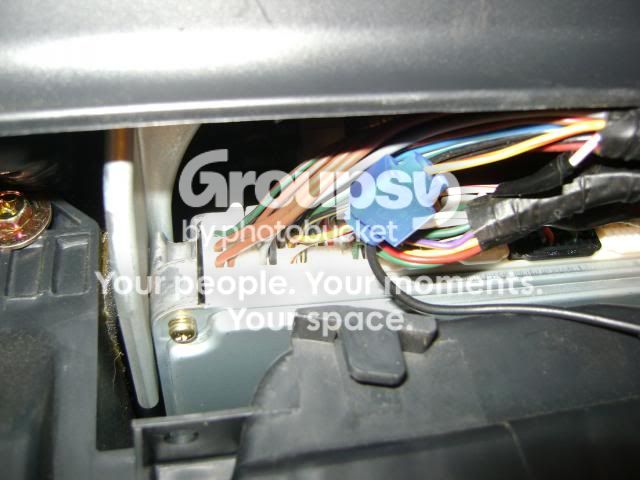

I was hoping, for convenience, that these wires went to the ABS ECU. However, they go straight to the ECM - Electronic Control Module. In my truck, this is located behind the glove box. I removed the glove box and the horizontal air vent duct shown in the below picture
The ECM is now easily accessible. I located the 2 sensor wires in the furthest left (DS) plug on the ECM.
I tapped into the yellow/red wire. If you had a sensor on your transmission, then this is the only sensor wire you will need. If you added a sensor, then you will need to ground the negative wire.

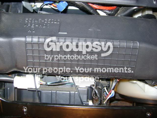

Next I found the wire which feeds the signal to the speedometer. This is a grey wire with a blue stripe located on the large plug of the ABS ECU.
If your truck does not have ABS, then you can tap into this wire behind the cluster. Likely will be same color wire, from reading other threads.

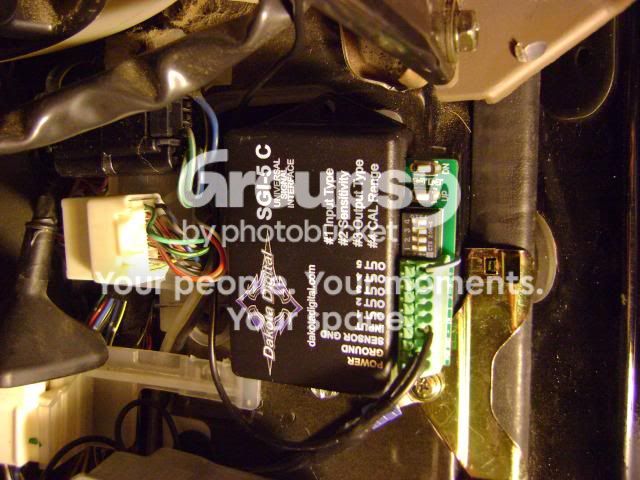

Also, I tapped into the yellow wire on that same large ABS ECU plug for power to my Dakota Digital sending unit. Dakota Digital - Digital Instrumentation and Accessories. I used the SGI-5 universal signal interface unit. This allows you to calibrate your speed with a few button clicks.
Power came from the yellow wire, ground to a nearby bolt, "Signal in" came from the yellow/red wire, and Signal Out goes to the grey/blue wire to the speedometer.
I experimented with lots of different settings and applications of the sending unit. The best one was "OUT 5" with all Dip switches off. This yielded about a -12mph difference between my GPS and Speedometer reading. A few bumps of the "UP" adjustment button and the speedometer was perfectly sync'd with my GPS speed.
