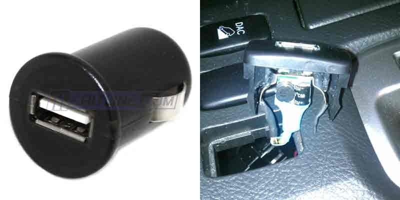

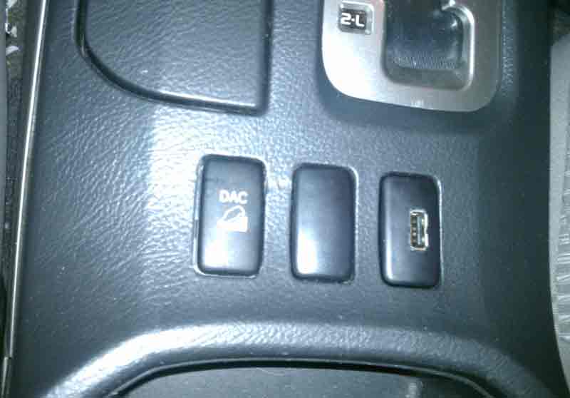

I used one of these kits on my center console dead panel. Turned out pretty good but kinda bulky looking... I use to work at a shop so I got the part for like $11.00...

Hey, I just bought one of these kits. Any tips on installing? Did you just use a drill with a large bit to make a round hole in the dead switch?
That looks great! Would I need anything else to get this to work? I have no electrical knowledge whatsoever. Is it as simple as pulling out the spare socket, finding a wire under there and plugging this new device into it?
There's not a connector to simply plug this into; you'd have to splice 12V and find a ground location. Finding where to tap in will depend on 1) where you want to put it, and 2) whether or not you want full-time 12V or ignition on 12V.
I installed a 2-USB (1 charge, 1 audio) port in the center console, and a 12V/Voltmeter port over near the AUTO LSD button on the dash. Both are on full time; instead of tapping an existing wire, I wired a fusebox from the battery so that I could add accessories down the road if desired.

I bought two of these USB ports so I wouldn't have to use my 12V outlet.
http://www.amazon.com/gp/product/B0...ocker Style&qid=1444422090&ref_=sr_1_1&sr=8-1
It's the nicest looking one I could find that would fit into a blank switch location. I don't want to drill holes on the interior if at all possible. I also have the dirty parts updated dual battery switch in another blank switch spot I next to the center diff lock switch.
