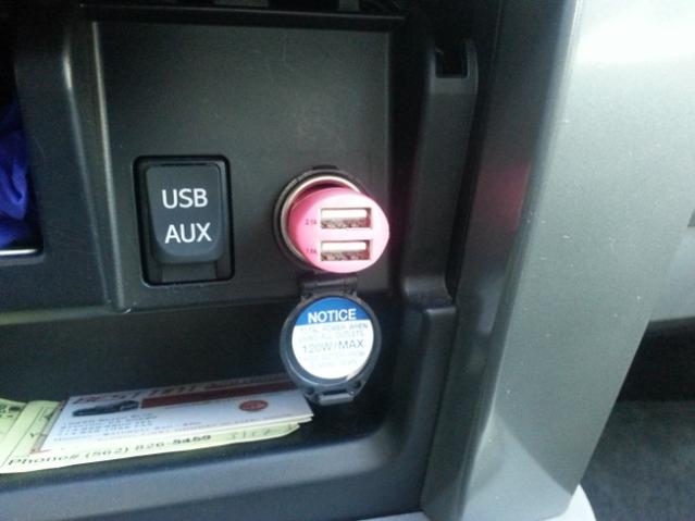

I use a cigarette lighter USB adapter with two outlets, 1 with 2 amp and the other with 1 amp output. Leaves the low power built in USB plug if a 3rd device is needed.
Not my choice of colors, old one died on a trip, bought this at a CVS store.
