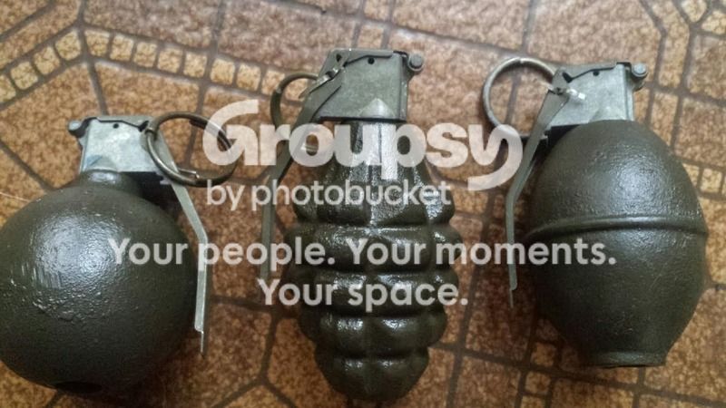

Using these for a potential mod... can you guess?
Yeah shift knob stuff. Want to use the pineapple for the main shift knob and the baseball for the 4wd. I have an engraver I'm going to use tomorrow to etch the baseball naid.
Problem is the 4wd bolt head is about double the size of the transmission shifter. Have to source some different stuff to mount it.

Weight is the biggest issue with these. I'm worried it will pop out of gear. The "baseball" frags are standard issue grenades. We had them in 'stan and they look light but they're not.
Plan is to cut 3/4-1 inch off the shifter and rethread it to stock M8-1.25 them weld on a long thread nut on the inside attached to the initiator/spoon. Then some sort of hose will go on the inside of the demilled hole to create a good tight fit with no rattle...

The M67 just doesn't look very grenade-y like the Mk2.
Also I agree that these could pop your truck into N because of the weight.
