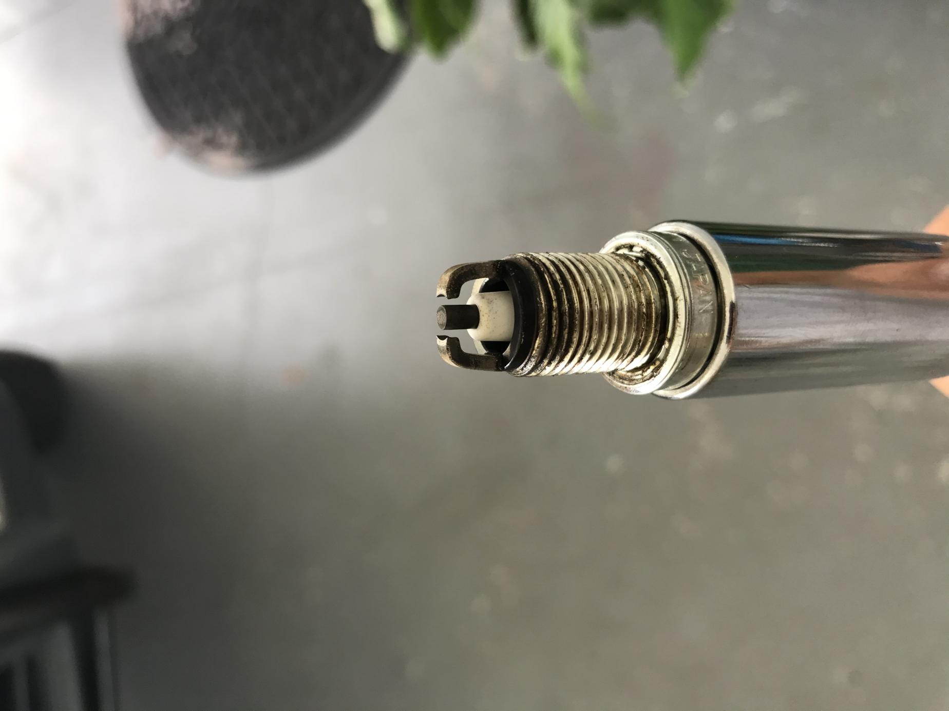

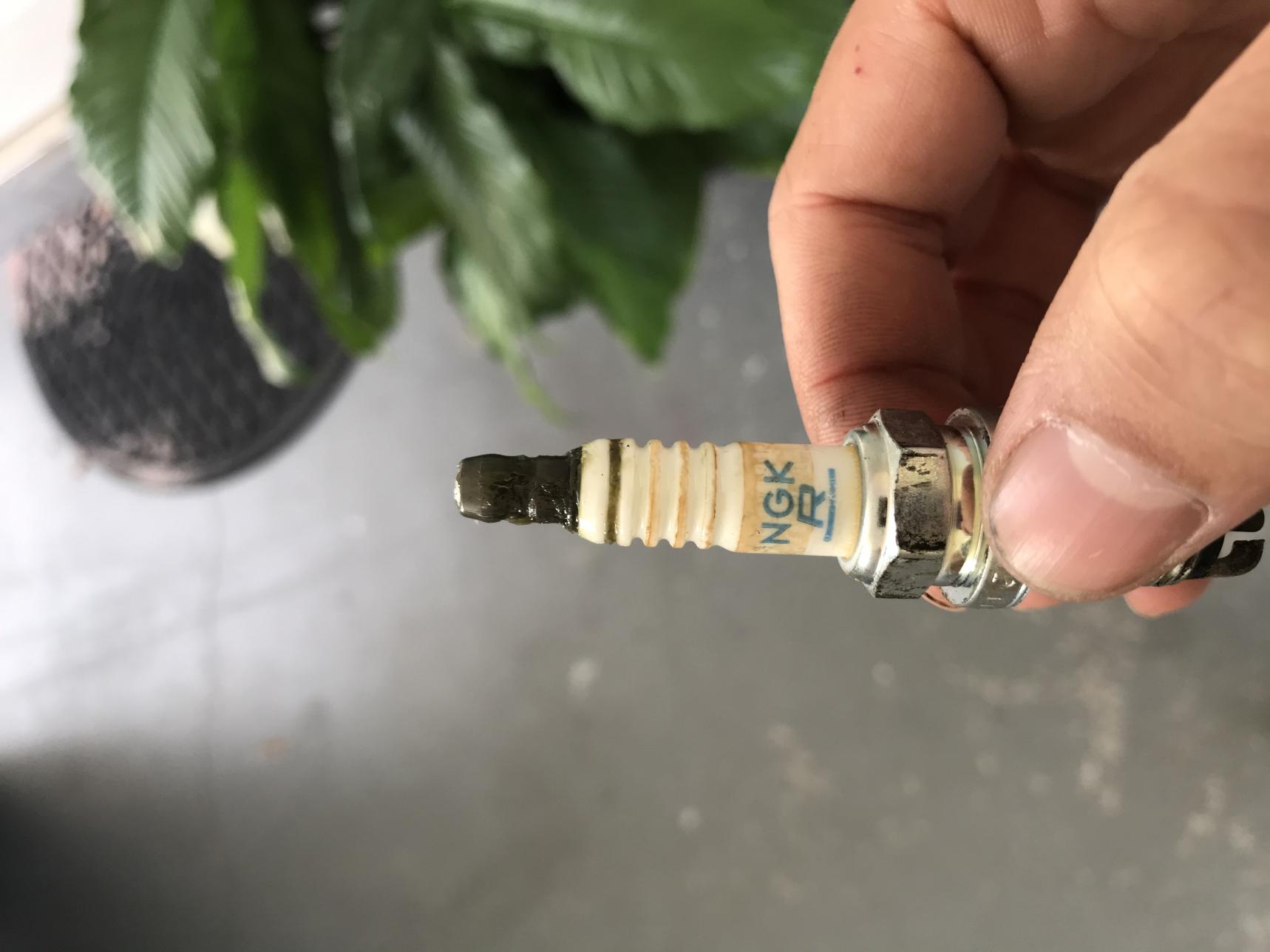

I’m having the same problem, won’t rev pas 2500rpms sometimes gets to 3k, new tps, remove cat no change. No check engine light.
I’m not sure, I noticed that is using a lot of fuel , in one week from full tank the needle gauge got to empty super fast.
SPARK PLUG Pictures
