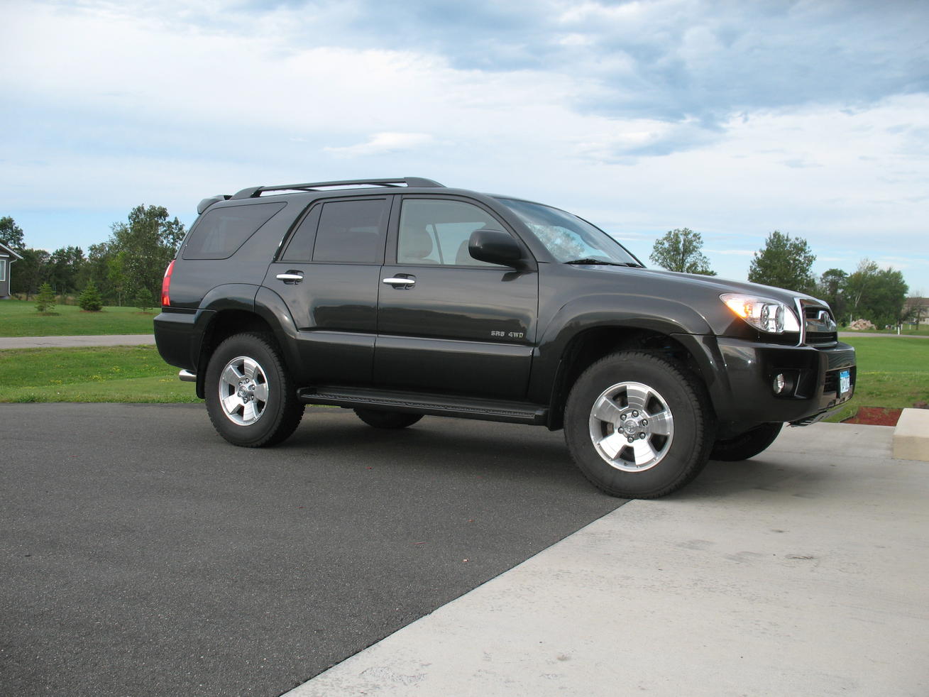

FJC Springs Front & Rear, Toytec 1/4", Spidertrax 1.25" wheel spacers, 265/70R17 BFG A-Ts
edit: it rubbed pretty bad because of the spidertrax, but I've heard with BFG ATs they will still rub without the spidertrax spacers. Most other tires don't (I've read)

No rubbing with 265/70-17's at all. There is rake left in the body but my running boards are dead level.
