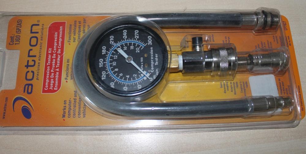

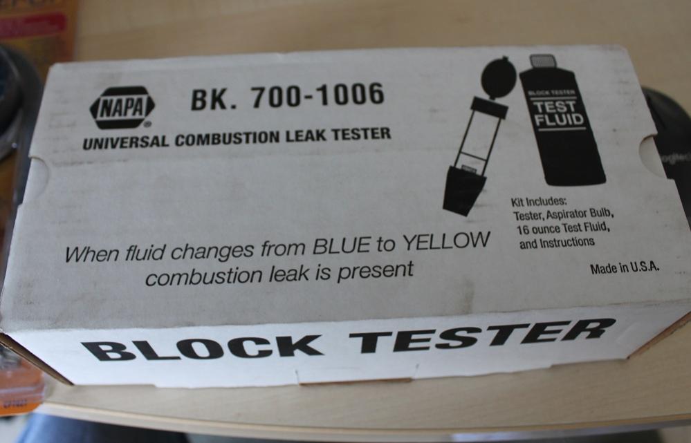

I used a NAPA, BK. 700-1006 universal combustion leak tester...no leak per test results. Is used on the radiator.
Bought a Actron compression tester kit, has sat collecting dust.
Was not sure how to disable the EFI at the time, so i never followed up on it, master procrastinator...couple years ago...pull the EFI fuse...duh.
Connects to the spark plug hole.
I have no visible antifreeze leaks...and its actually been closer to 7years i have been loosing coolant.
... I only put 5k/year on the old girl.
