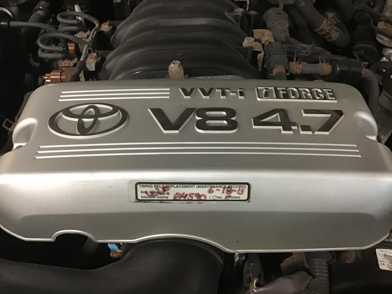

Most dealership and even independent service departments will put a sticker somewhere in the engine bay indicating when the service was done. My 4Runner’s first timing belt service was done in 2013 at 85k and there is a sticker on the plastic engine cover with the date and miles. I too just purchased an ‘07 (with the 4.7L V8...the 4.0L V6 has a timing chain) with 172k miles. I am sure the last owner traded it in because the timing belt/water pump needed changed and he didn’t want to spend the money on this old girl. If you can’t find the sticker, or any evidence the service has been done...you are rolling the dice. Even if it was done, it would have been done at 90k and is ready for it’s second timing belt service. If you have the V8 it is an “interference” engine and if the belt breaks you will have major damage, more than likely (bent valves, etc). There isn’t usually any indication the belt is about to break either whereas a timing chain (which rarely breaks) will make all kind of racket due to it stretching and rattling against the guides. It will sound like marbles banging around in the engine bay. Not so with a belt.
