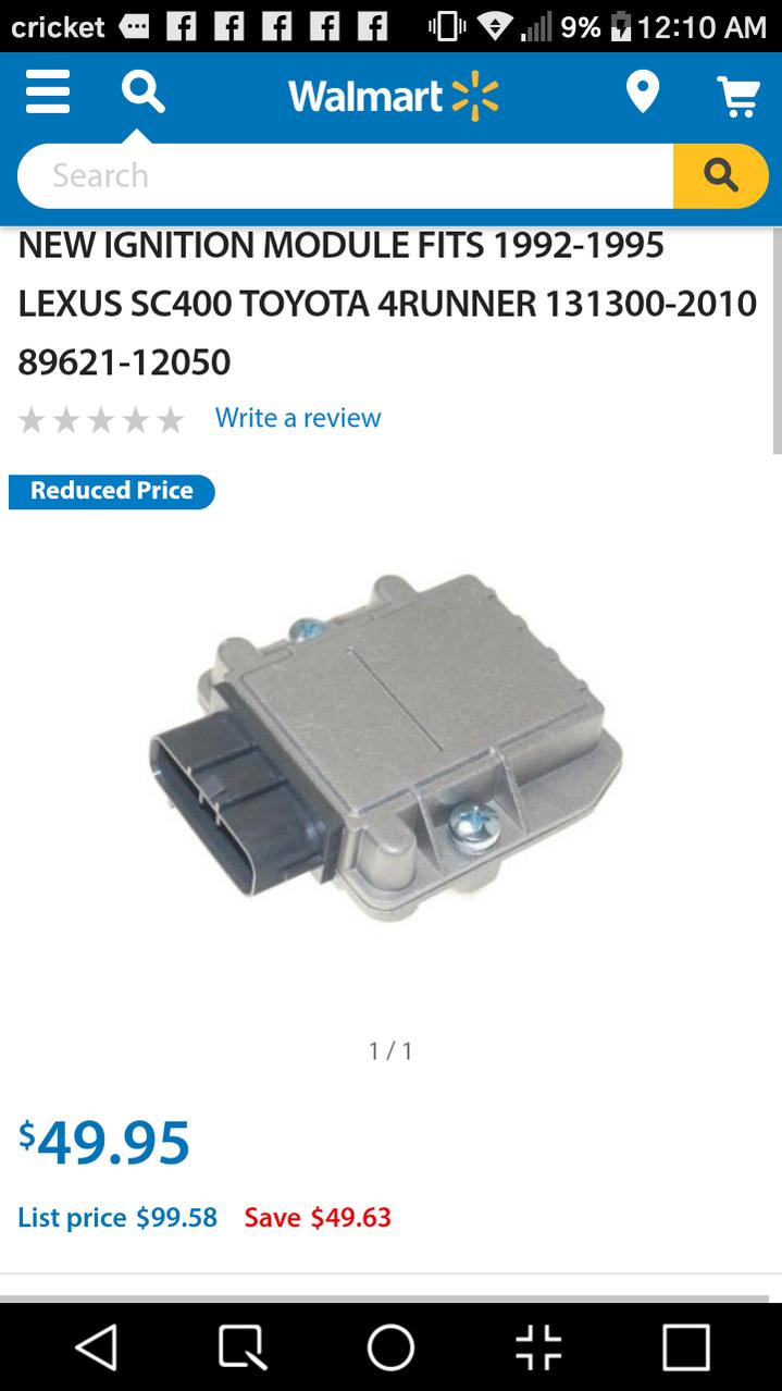

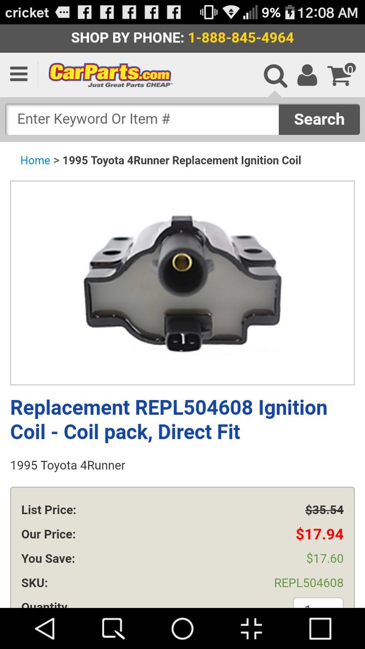

Hmm, well I remember the cost of an igniter for my '84 1st Gen was 200-300 dollars . If you need one and it is only $40 that would be great! Although maybe the other things you are doing will negate the need to buy one. Good luck!
Your "patient encounter" sounds like a scene from a WWF match. Hope you don't have any residual effects from the head trauma. More meds and some backup next time!
Sometimes it turns into a wrestling match...I wonder if it's the igniter or the coil pack... Hmm. Both arent bad in price.

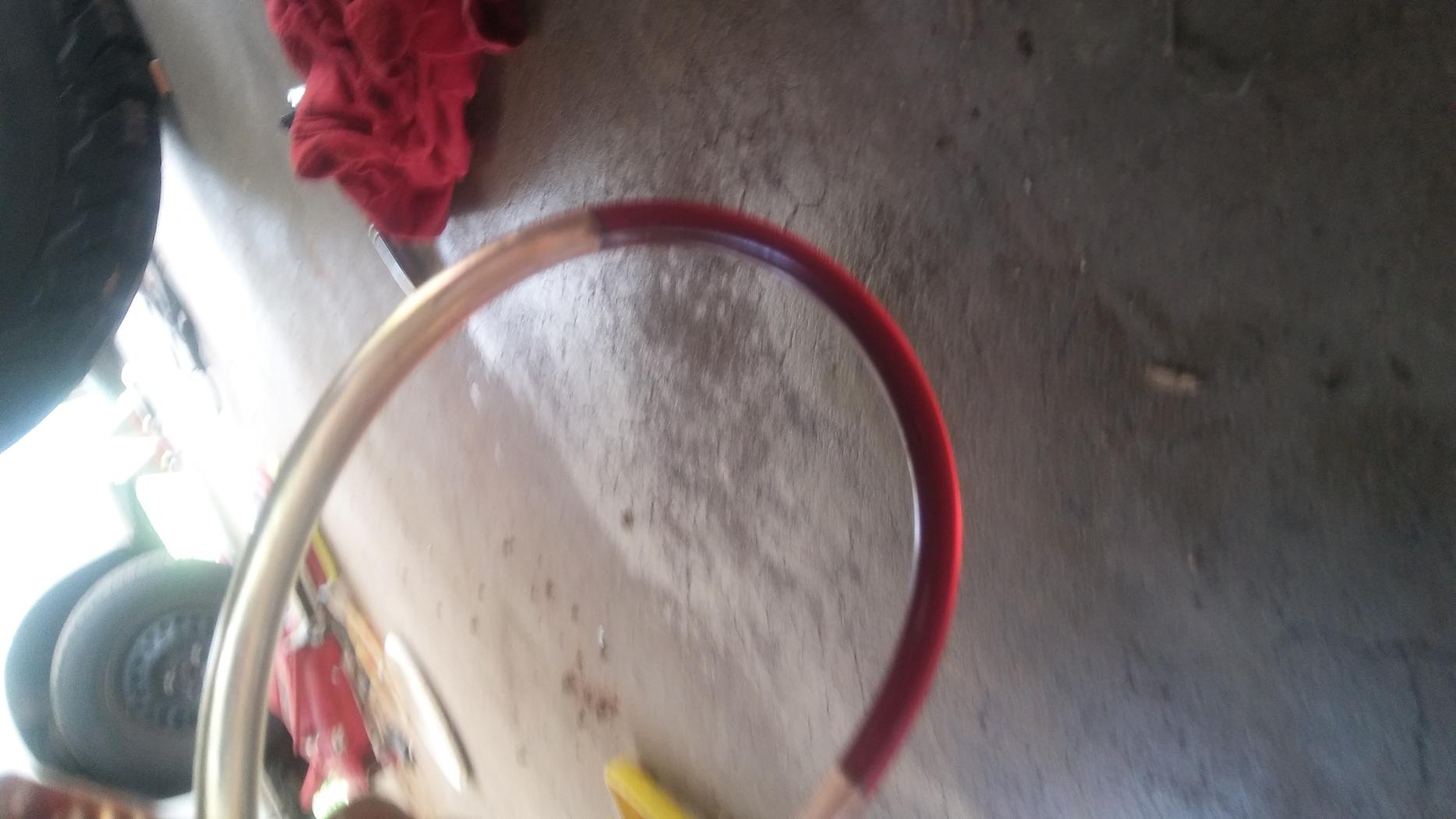

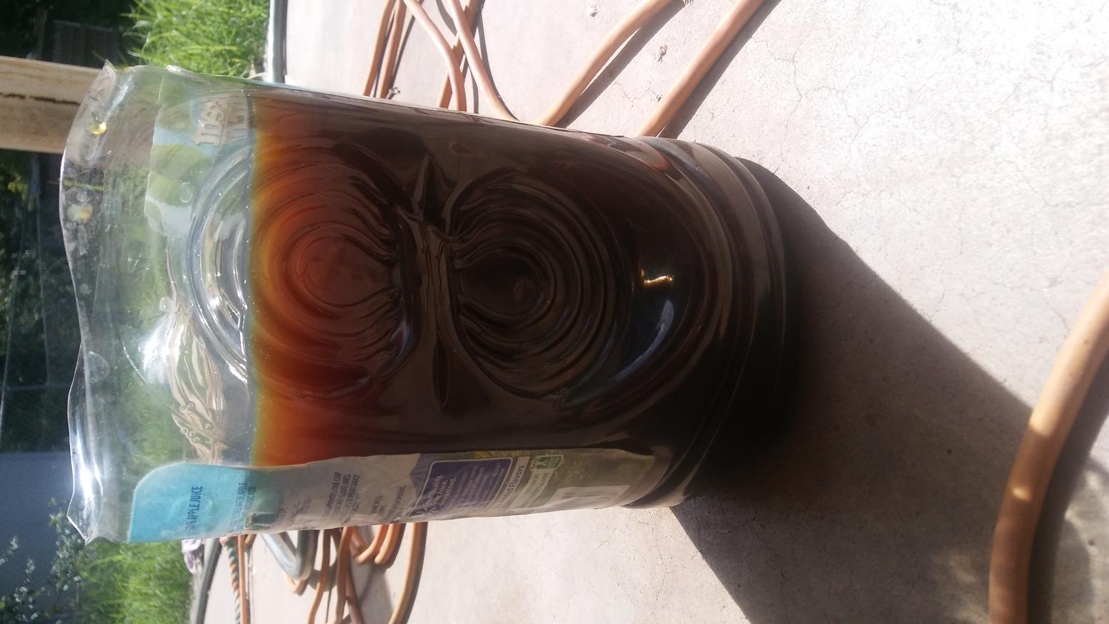

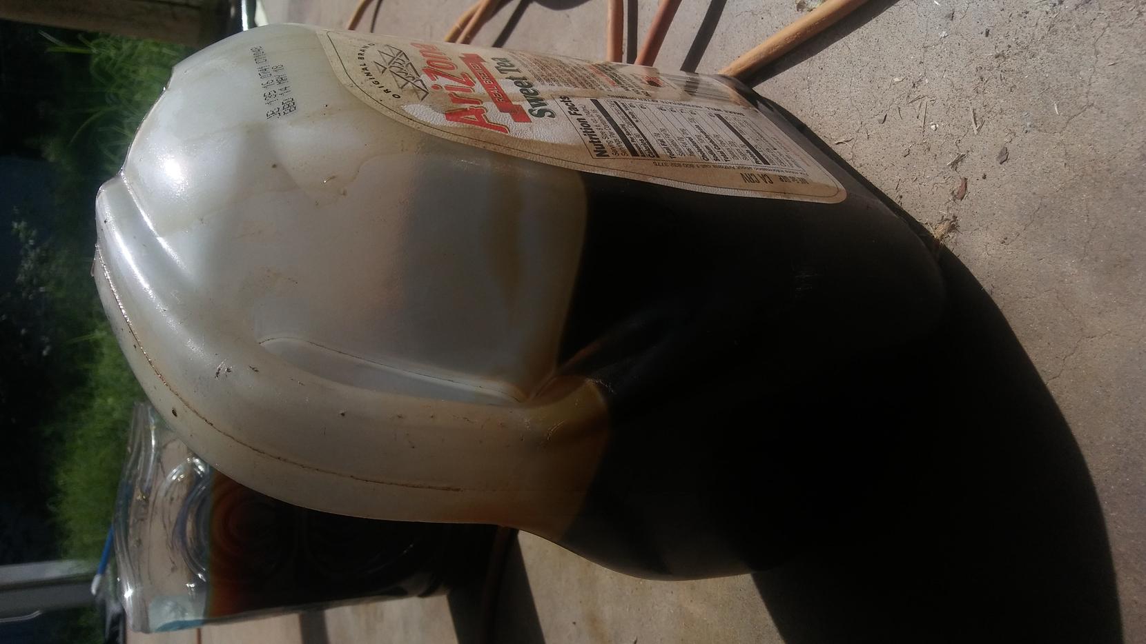

I got impatient. 1st pic is tcase sample which was good to go.
Second pic is what came from the transmission.
Third pic is what came from the front diff.
Chocolate milk anyone?? Hahaha
