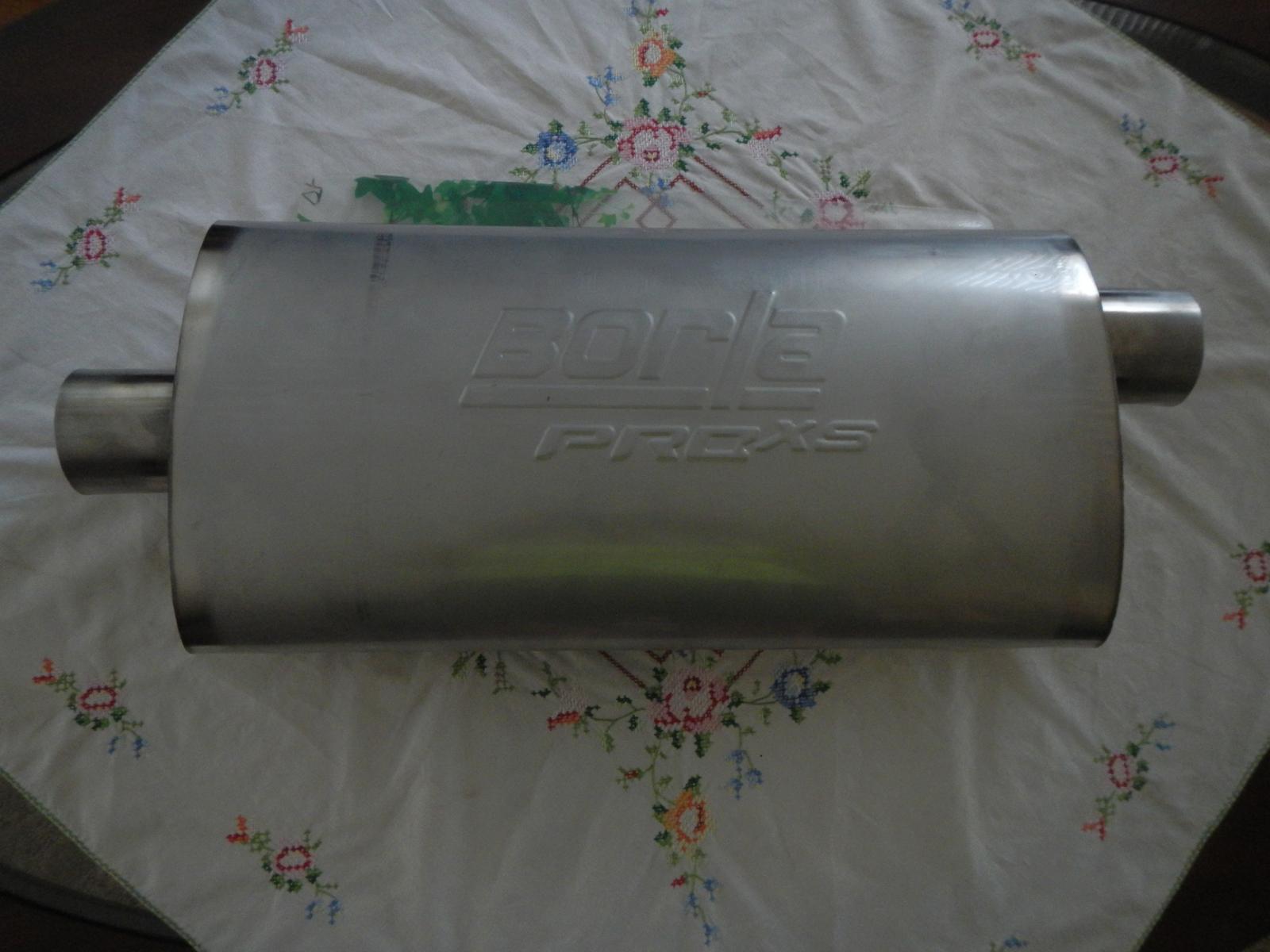

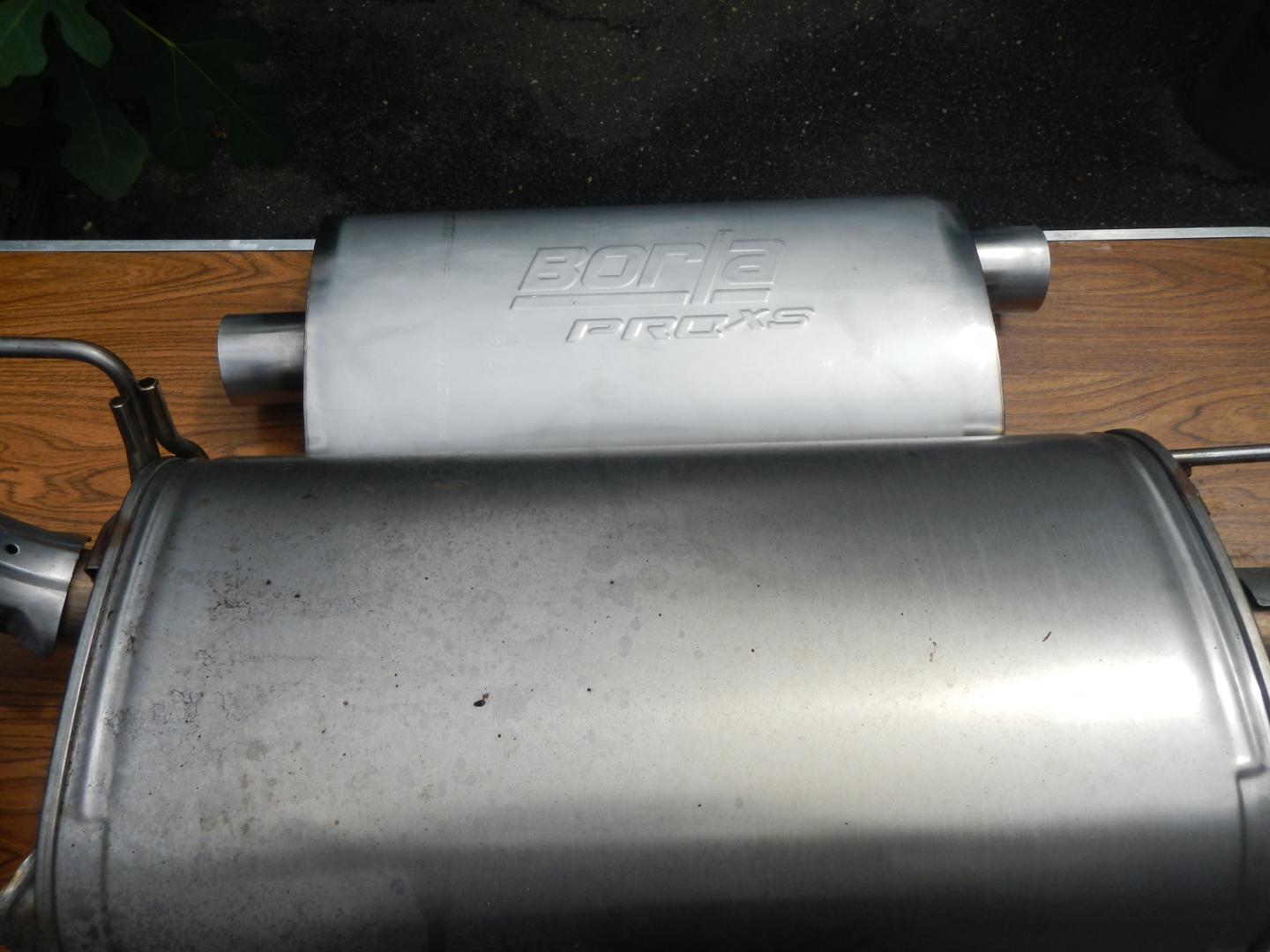

I just measured the stock muffler and it's 23 1/2". The Borla is 19" so I guess your muffler shop added a piece of straight pipe. I'm thinking before the muffler. Unless the pieces in front and back of the Borla that get welded or clamped make up that difference?
Two short pieces were added to the inlet and outlet of the Borla. This made up the difference in length and provided a solid mating surface to rejoin the existing pipe.

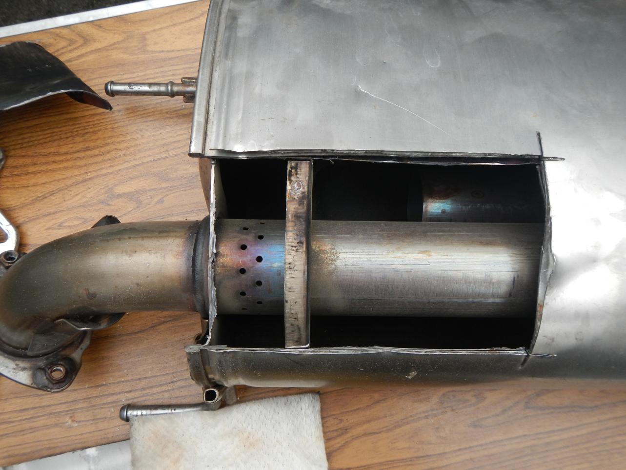

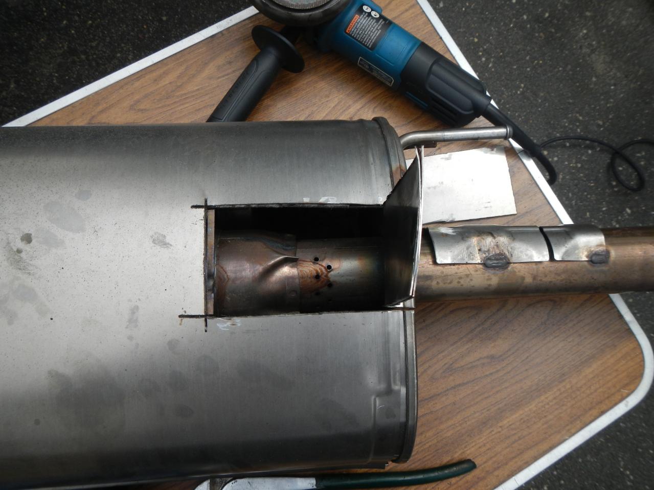

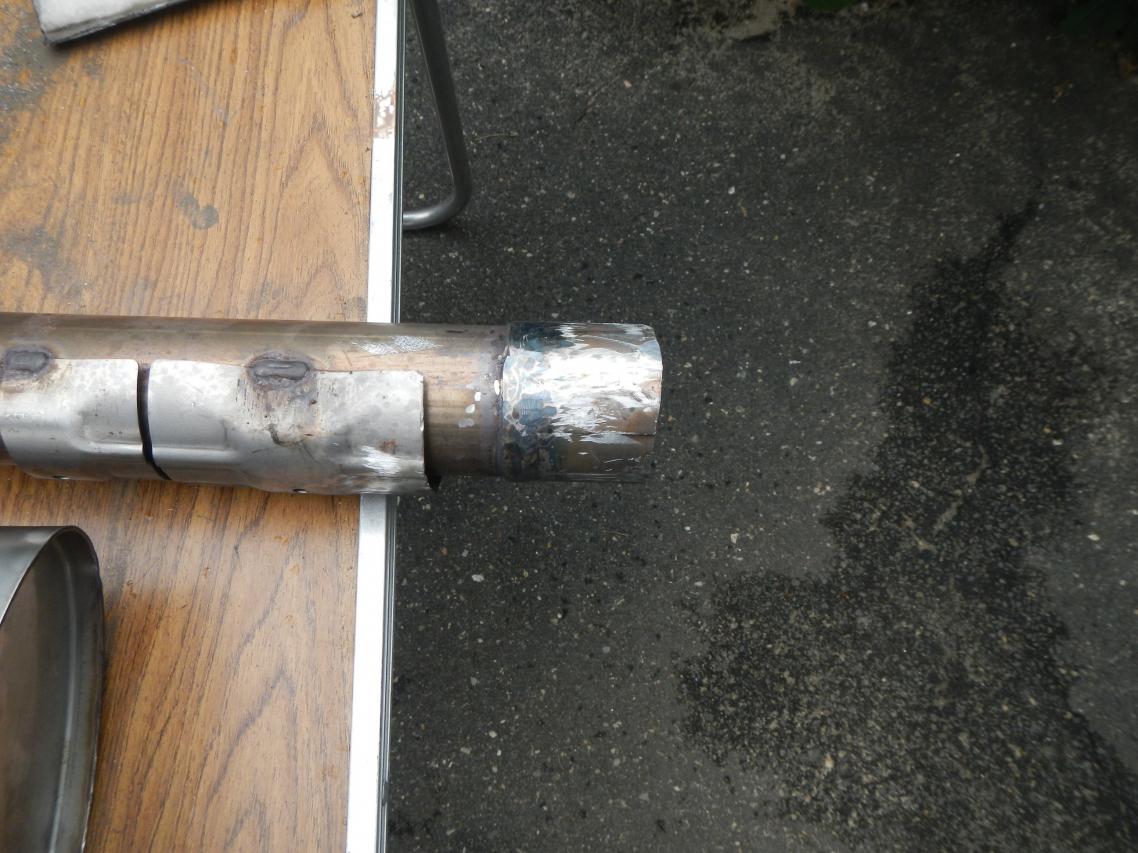

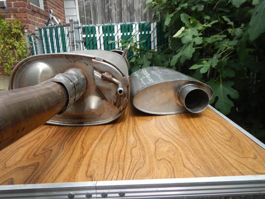

Well I got it in today. It was not fun but part of that is because of my decision on how to get the 4 inches or so you need to make up the difference in length. Please excuse my pic and video skills or lack thereof lol.

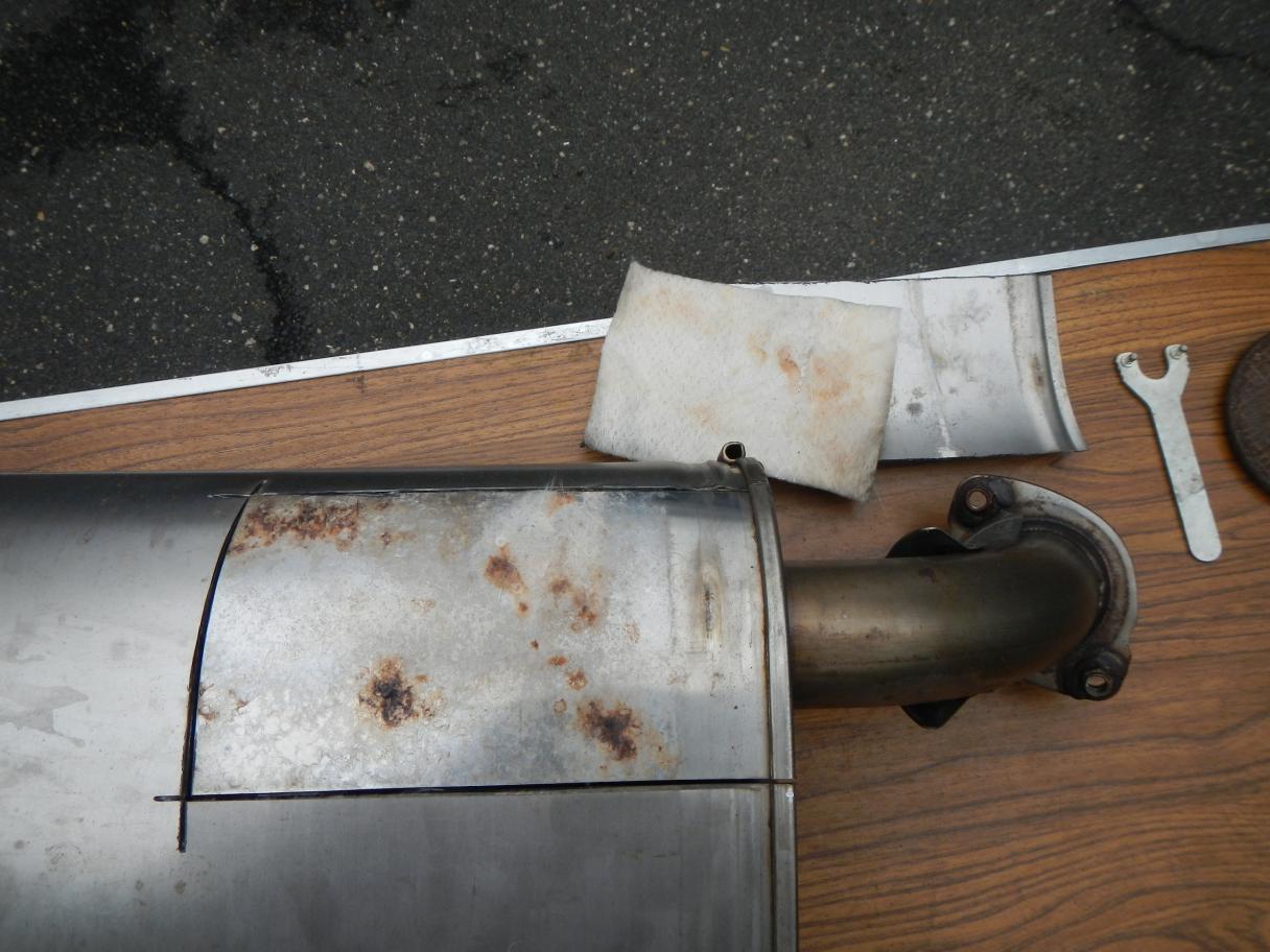

My son suggested cutting open the stock muffler and seeing if there was enough pipe to use and make up the difference. There are 3 layers of metal before you get to the innards! As the pics show there is plenty of pipe but it's perforated about 2 inches in on the outlet side and about 3 inches in on the inlet side. I cut them off just before the perforations but thinking about it afterwards I could have cut after them and got a little more pipe inside of the Borla muffler. The perforations wouldn't have mattered inside the muffler pipe. There was enough to get a good seal though. A lot of time grinding down the welds on the stock pipes but it's all one stainless piece instead of going to the parts store and getting some kind of adapter that would be steel and would rust out after a few years.

The pic of the front pipe shows the amount of extra pipe I got from inside the muffler. The shiny part is the extra part.

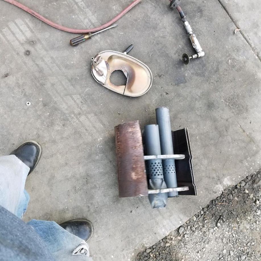

If anyone was wondering what the inside of our mufflers looks like, here you go. Cut the muffler open to remove the stock pipes and gain length needed to install the Borla muffler. Chose to do this rather than using extensions which will end up rusting and failing long before OEM stainless pipe ever will.
