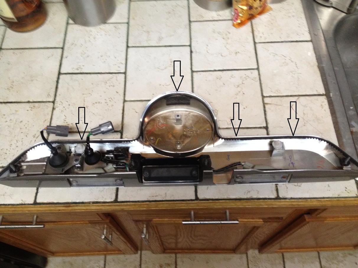

Here is mine, and the rubber grommet appears to be glued to the actual garnish piece.

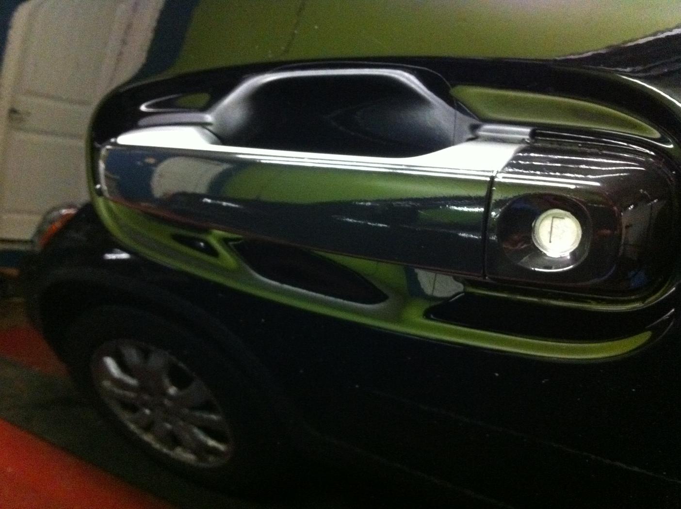

I purchased a couple of 12"X12" 3m vinyl and did a test run on a friend’s Ipad and Iphone. If you Google "how to vinyl 3m" you'll find several videos out there.
It’s easy to do and because it’s so resilient you can make a mistake and redo it with the same piece of vinyl.
Couple of things:
-Get a decent heat gun that you can adjust the temp. Not expensive
-Get a spray bottle and mix ¾ filtered water to ¼ Isotropic alcohol. You’ll use this to wipe down the item to be vinyl’d and after.
-be patient
I’ve included a pick of the driver’s door handle that I did with a gloss black vinyl and it also came out great. This just shows how versatile and responsive the vinyl can be. I did all four handles with one 12”x12” piece. the glare from the flash distorted the key hole but it's perfectly round

haha, I Just pulled mine tonight, and took pictures to post up on my thread, as I was trying to figure out how to do this myself only to find you already posted it! haha. Oh and the seal you were looking for, look on the pic of the back side, the seal is actually attached to it or built into it.

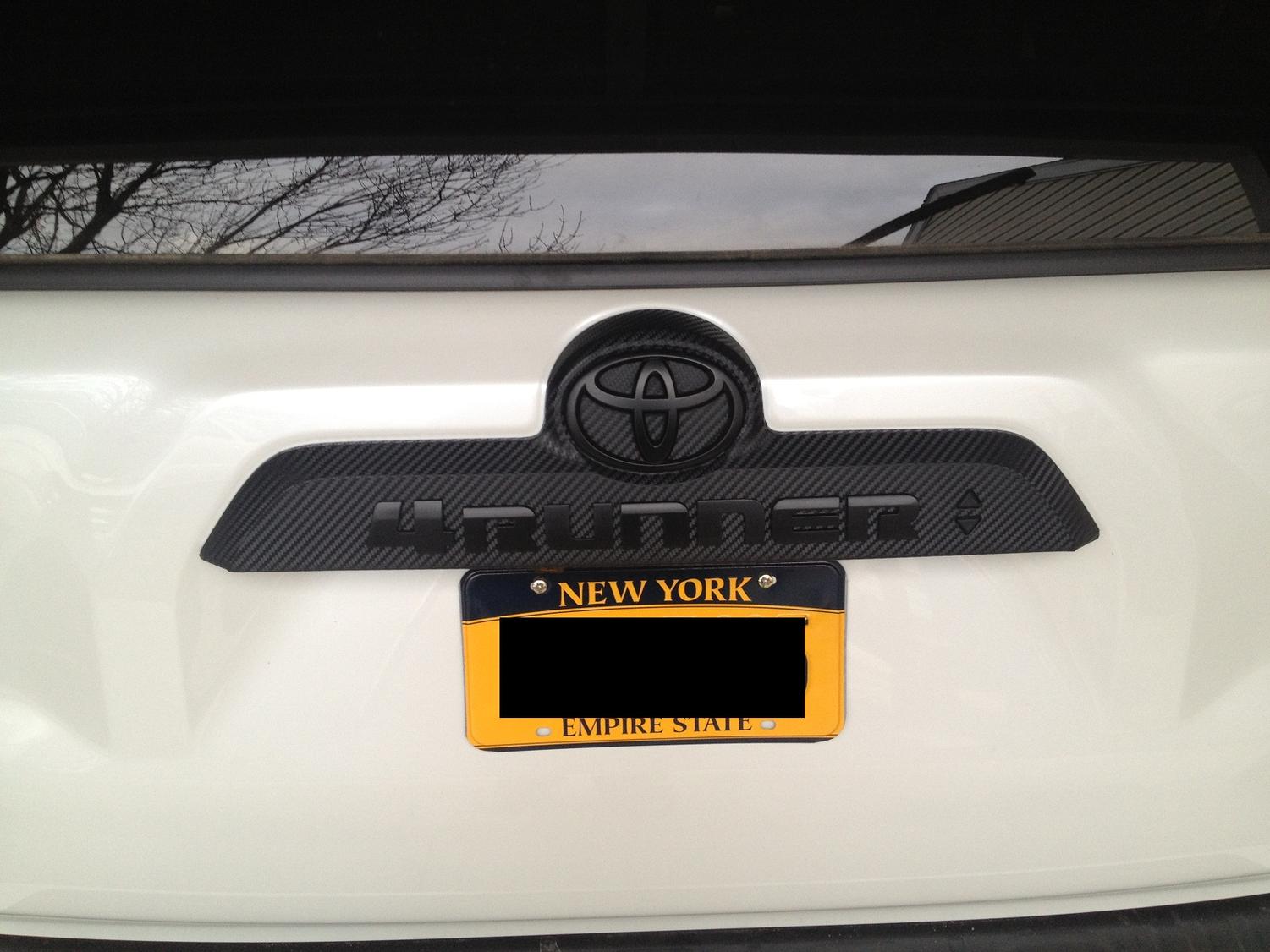

Ham, how did you line up your 4RUNNER emblem so nice after you wrapped it, and how did you re-attach the letter after? What specific type of tape did you use?
pic below of the product used to attach letters. it's a clear gum tape.

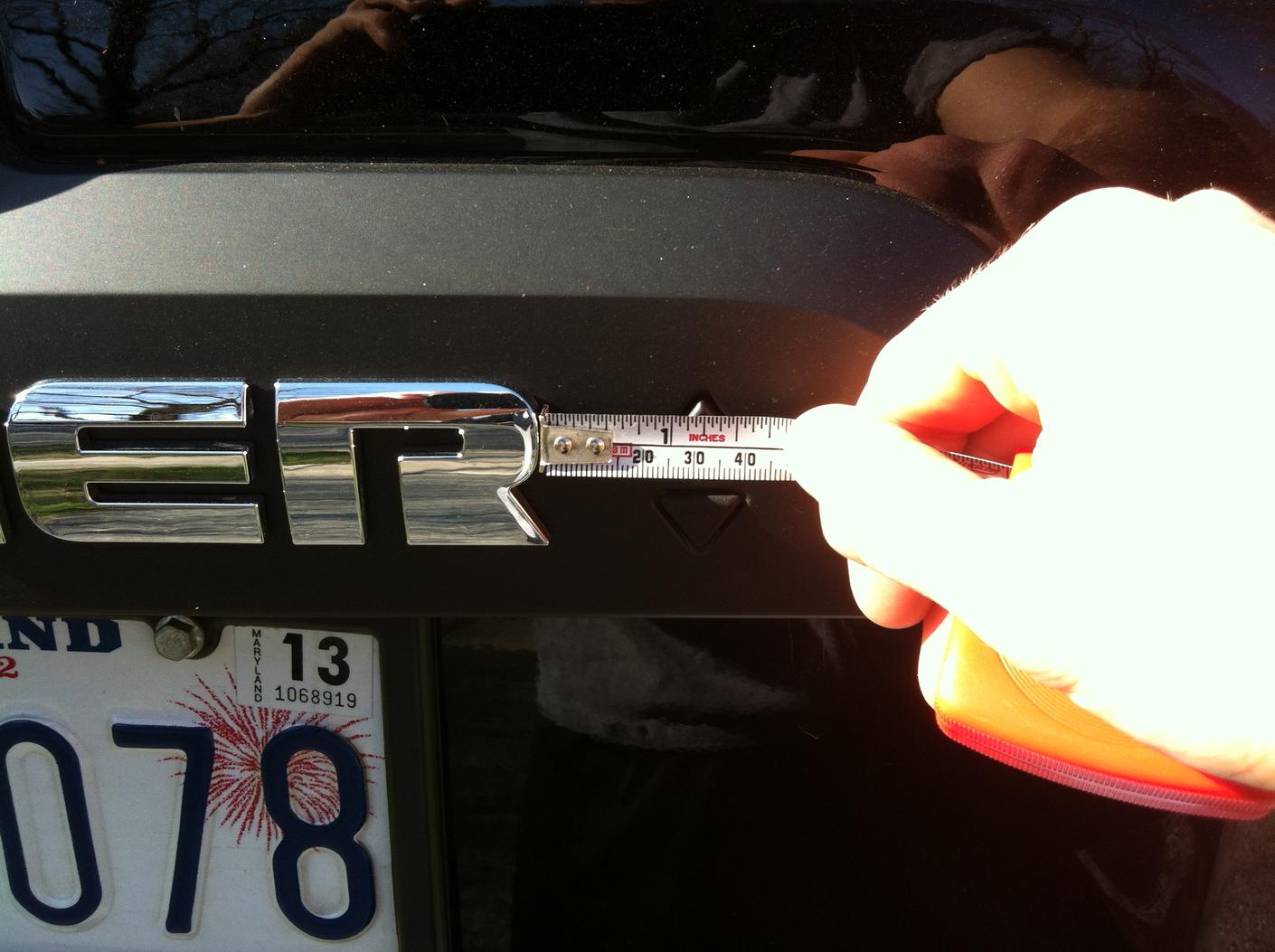

as far as lining up. I requested a picture from joemck7 with measurements (Thanks again Joe!)
1. The distance between each letter is .25" exactly
2. The distance from the "R" to the "Center of top of the triangle" is 1.25". To be clear, in the above picture, if you were to draw a line straight down from the top of the triangle, it would "hit" the 1.25" mark on the tape measure.

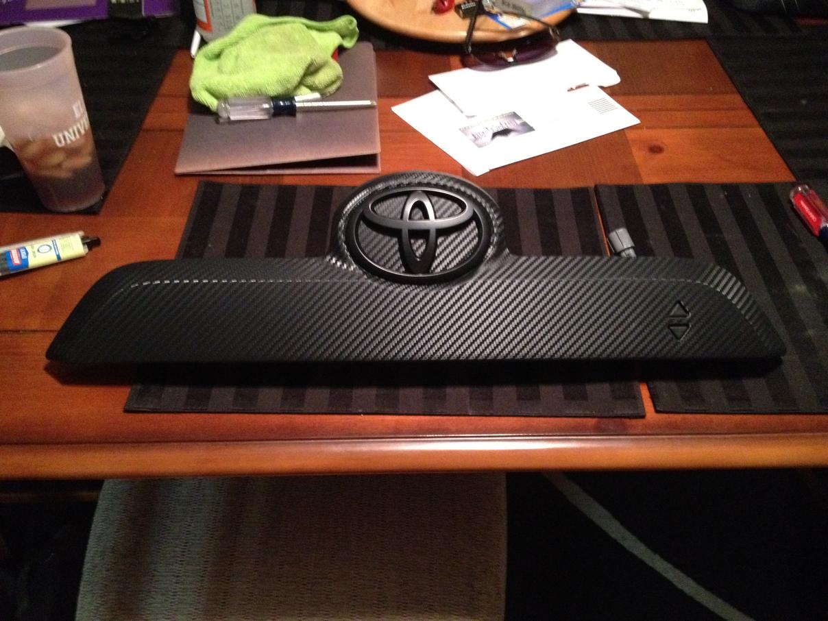

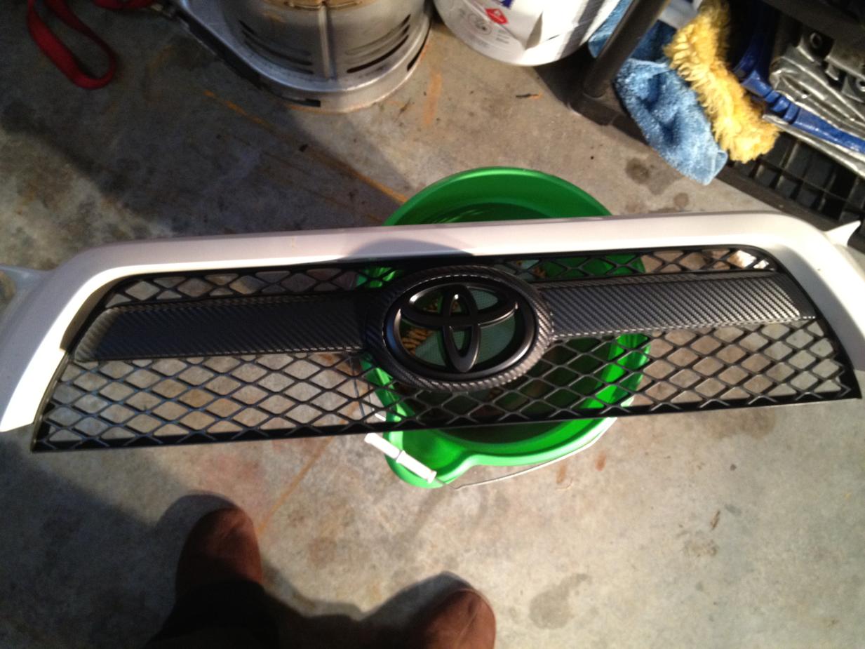

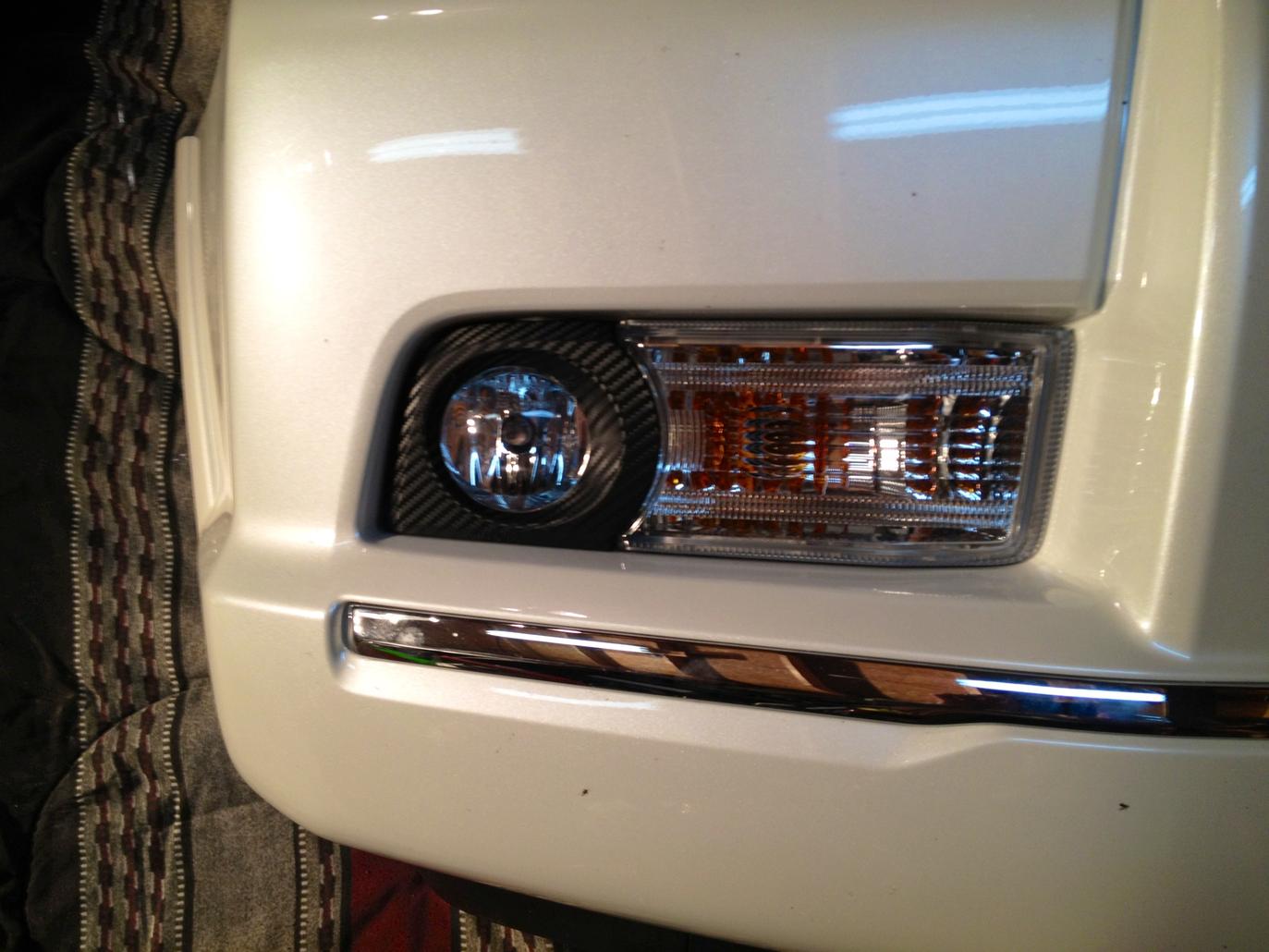

Here's what i got after a couple hours, Ham.... Have you done the chrome trim pieces yet? I want to do the front rear and both sides, but trying to see if im going to have to remove them first to do them. The front will be easy enough, as the whole front bumper is already off while the headlights are being retrofitted at TRS.
You've done a nice job! I've done the rear trim not the front. i'll be doing the front as soon as I get my Hella supertones. The rear bumper comes off fairly easy also. I would definately take the chrom trim off and wrap. Gives it a more cleaner look. my door handles are the only wraps that I tucked into the unit. If it does shrink and expose chrome i can always re-wrap and it only takes 5min.
