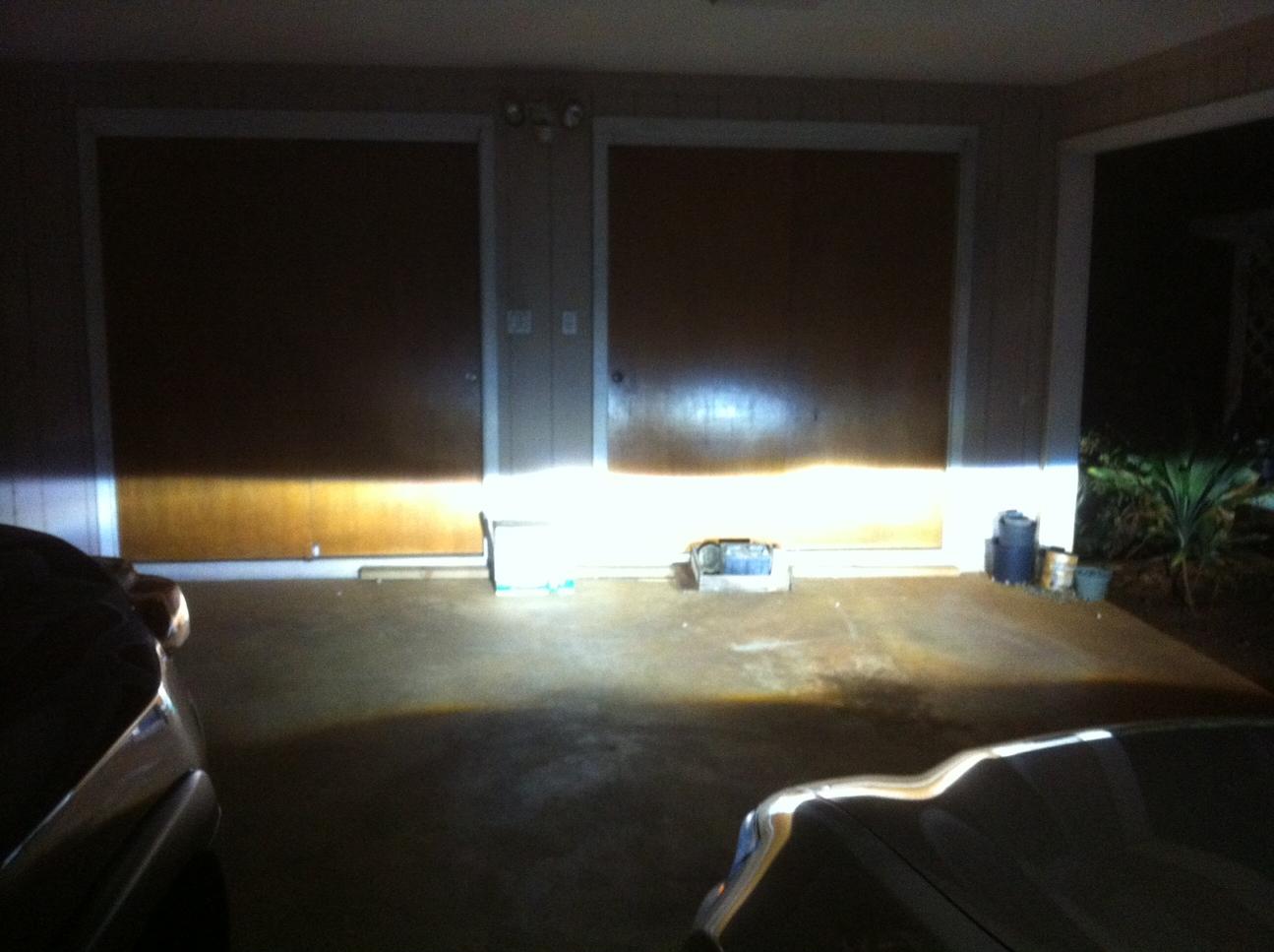

Agree with you on all counts. I was skeptical but hopeful. Returning is probably my best option. Stupid me. I double stick taped the ballasts so I would have to clean them off...

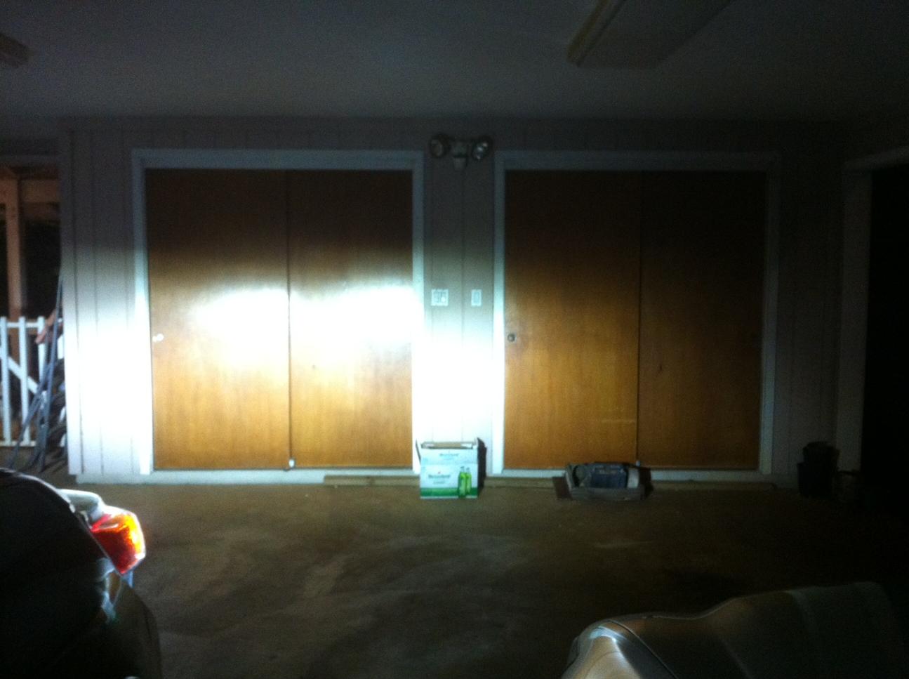

Attached are 2 photos. One of the VLED on my Runner and other is the stock HID projectors on my wifes Lexus GS350. Pardon the crappy pictures, messy garage and crappy wall. Wall is about 15 feet from cars. Lexus is shooting straight on. Runner is at a very slight angle.
