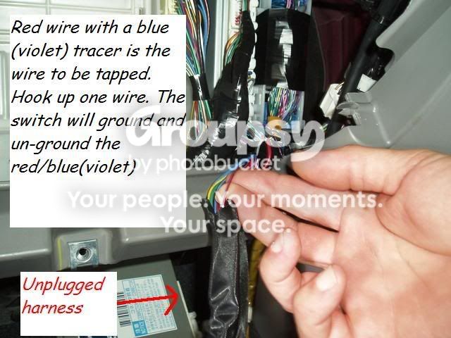

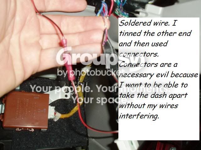

I completed the VSC-off mod on my T4R. The cool thing about this mod is the ATRAC is still active.
A great thank-you to Andries at T120. This is his hard work not mine.

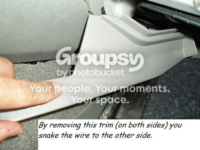

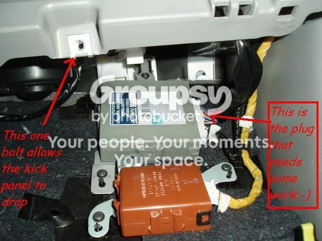

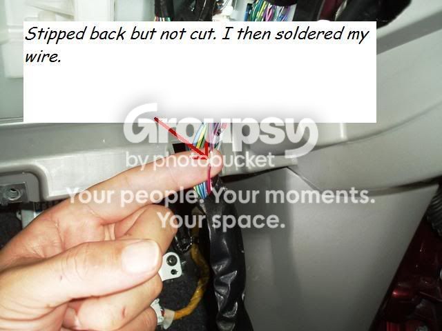

Below are some how-to pics Battery should be disconnected for this procedure! There's a TSB that discusses the risks; basically disconnect the battery. Do not turn or change 4wd mode knob until it's all back together and powered up.
1.jpg~original
2.jpg~original
3.jpg~original
4.jpg~original
5.jpg~original

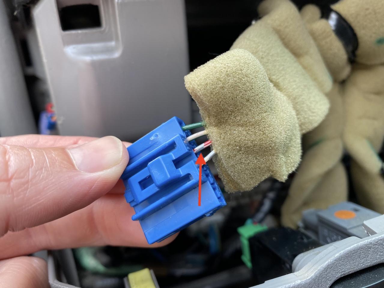

2004 checking in! Big Thanks to Wolverine for tracking down that stability control module. I was read to run a wire across to the 4x4 module from the button's plug when I finally found you post. Cut the red/white and spliced it into the Red/blue, everything worked exactly as described!!

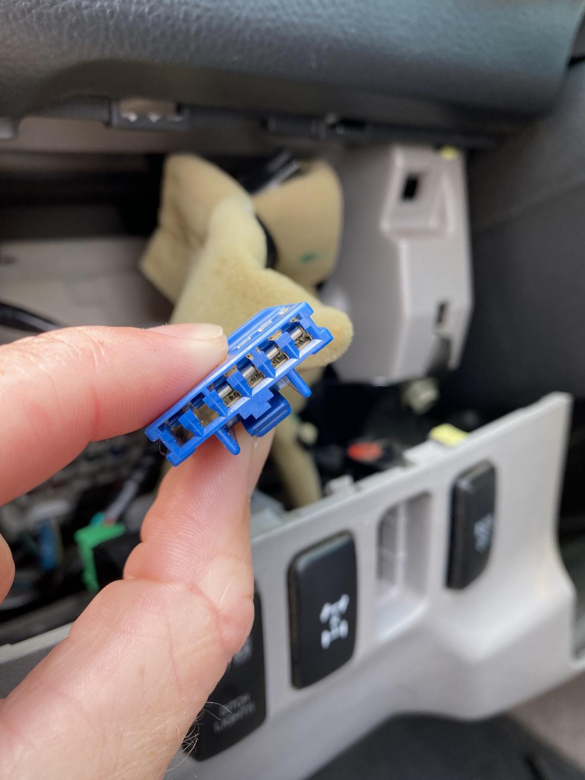

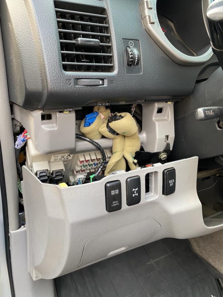

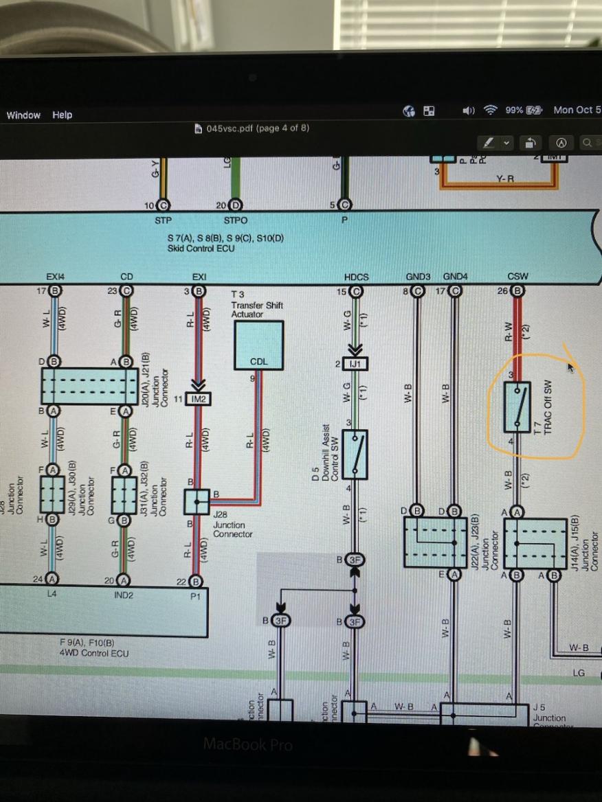

Hey Y'all,
I did some serious investigation to figure out how to cleanly defeat the TRAC control on the 4Runner. After wiring diagram searching I finally figured out that we're pre-wired for a TRAC OFF switch. I pulled the panel under the steering wheel and found the 2 clips tucked up and away above the fuse panel. There's one with a blue clip and one black. The wiring diagram shows that there is a red wire with a white stripe. That wire is in the BLUE harness clip. So that's what I'm using. Ordered a TRAC OFF switch today from eBay. Part number: 84988-AE010. The button from a 2WD for "AUTO LSD" is equivalent to this switch, just reads different. If you need that part number, its 84988-35050. But to be consistent, I wanted my 4WD to have the TRAC OFF reading on the button.

So I bought a switch on eBay. Installed the thing and it lights up. Doesn't matter what mode I put the truck in, nothing comes up on the dash to confirm Trac has been turned off... super frustrating. I'm not totally abandoning the idea, but I'm wondering if the button isn't working quite right.

I'm waiting on a 84988-AE010 switch to come in from Toyota. I think we have to take this a step further. And cut the red white wire and tap it into the red/blue wire at the skid control ECU as demonstrated by [MENTION=28616]SSt4r[/MENTION]. My skid control ECU is under the dash on the left side in my 2003. I think later years it was moved to under the hood at the ABS module.
Here's my thread on this issue. Even though it's been covered numerous times I had a hard time wrapping my head around it. I think the basic gist is all you are doing is grounding out red/blue wire which is tricking the ECU into thinking the CDL is engaged.

Ok this is pretty simple. Modify your switch to become on/off instead of momentary. This was the hardest part for me. Find your skid control ECU. On my 03 it was under the dash to the left if the parking brake. Find the connector with the red/white wire. Cut the red/white wire and tap it into the red/blue wire with a wire tap. Plug up your modified connector to the existing wiring harness in the dash. You can now push it whenever and the "VSC OFF" light comes on. My CDL light didn't come on. Only the VSC OFF light came on.
