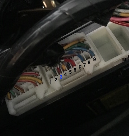

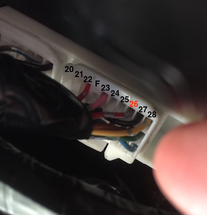

I had some time on my hands today, so I thought I'd clear this up. It's easy to get disoriented lying on your back with your head jammed under the dash :)
I just checked again, and there is definitely no blue stripe on your wire. Again, SSt4r's post, sourced from the wiring schematics, locates the red/blue wire at position #3. "I originally used copies of the 2003 wiring diagram. For that year, the red/blue wire at the skid control ECU is listed at position #3 & the red/white wire is at #26.". The plug has three rows, row 1 has nine positions, row 2 ten positions, row 3 nine positions. For the position numbers of the wires to match SSt4r's schematic, the position numbering must be as outlined in the table below. I hope it's clear that the red wire you identified is at position #6.
Note that rows 1 and 3 have only nine positions due to plastic fins used to correctly orient the plug in the socket. I designate these fins with an "F" as they are not counted as wire connections. The blue number designates the red/blue wire and the red number designates the red/white wire.
I included a few pictures which more clearly show the wire positioning.
My final evidence is that, when I spliced these two wires as described in this thread, the mod works correctly.

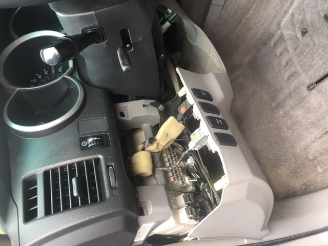

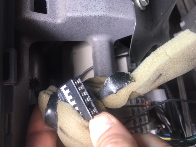

Hey guys, so I have a 2006 v6 4x4 SE. I'm looking to do this mod or the fine-grained vsc mod. I'm kinda in the planning stages and trying to get my bearings.
I didnt see the blue plug that I was expecting to see, but I did see this black one...is consensus that this plug is for the 115v inverter feature? I just read that its not compatible with the 08 "skid" button/switch, so does this mean that I am SOL for using one of the nice clean factory switches?
Also anybody find the wiring diagrams for the 06?
TIA!

I did this a couple months ago on my *new to me* '05 V6. I used Kliv's mod (fine grained VSC mod) so his device could do the grounding of the wire and also turn off the lights in the dash as needed. It also turns itself off when you shutdown the vehicle so you don't have to think about it yourself. Nice bonuses vs just grounding the wire with a switch.
I would bet that black connector is for the 115v feature, but that doesn't mean you're out of luck. I bought the fj VSC off switch off ebay and a blue harness from the dealership (part number 90980-10933). When I ordered that blue harness they asked if I wanted the wires already on it or just the blank harness. I didn't know I could get it with wires already installed, and I had already bought the little connectors (from here - link) so I didn't opt for the blue harness with wires, just got the blank one.

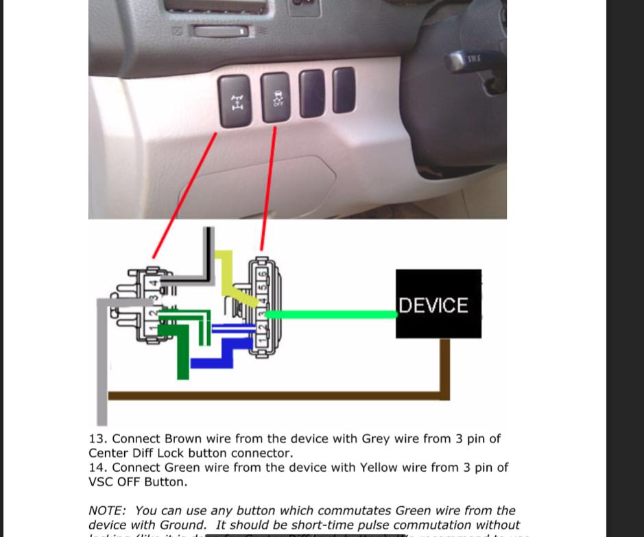

Alright, so I'v been referencing info from this thread and Kliv's fine grained VSC thread, and I'm just hoping to get some confirmation here before I start splicing...
I'm planning to use a factory switch(converted to ON/OFF) and Ill tap the red/blue wire at the 4wd ecu (under glovebox). I'll ground it out to the bolt that is referenced in the first page of this thread (under steering column).
To light the trac switch I'm also planning to splice into two wires feeding the CDL switch (basing this off this diagram from KLIV's install guide).
So in the end I would be splicing:
pin 1 (vsc) to pin 1 (CDL)
pin 2 (vsc) to pin 2 (CDL)
pin 3 (vsc) to red/blue (4wd ecu)
pin 4 (vsc) to ground
Does this all sound reasonable? I appreciate any input!
