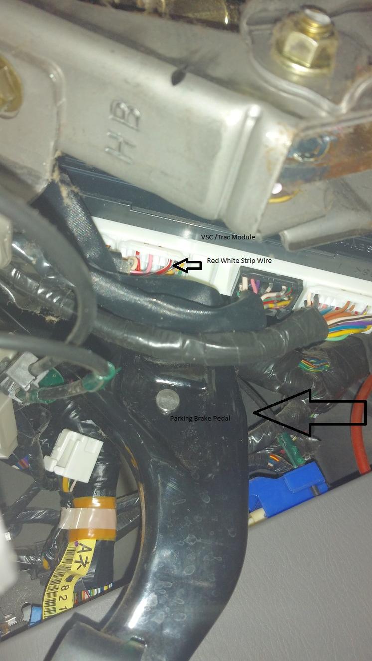

So this will do what you want; it disables the VSC & TRAC (throttle cut) but leave ABS and A-TRAC functional. I wouldn't tap into the pressure sensor as that will disable all ABS functions AND require a re-start to re-enable them. I would like to find a way to momentarily disable ABS separately but haven't found a way to do that (again without turning off & re-starting).
Cool! Thanks for the clarification.
In your second picture, do you mean that you need to splice and connect the red/white with the red/violet?
Yes, you do exactly what SSt4r did in post #42 of pg. 3 of this thread - his module was in the engine bay (05' V8) but ours is under the dash - (03/04).

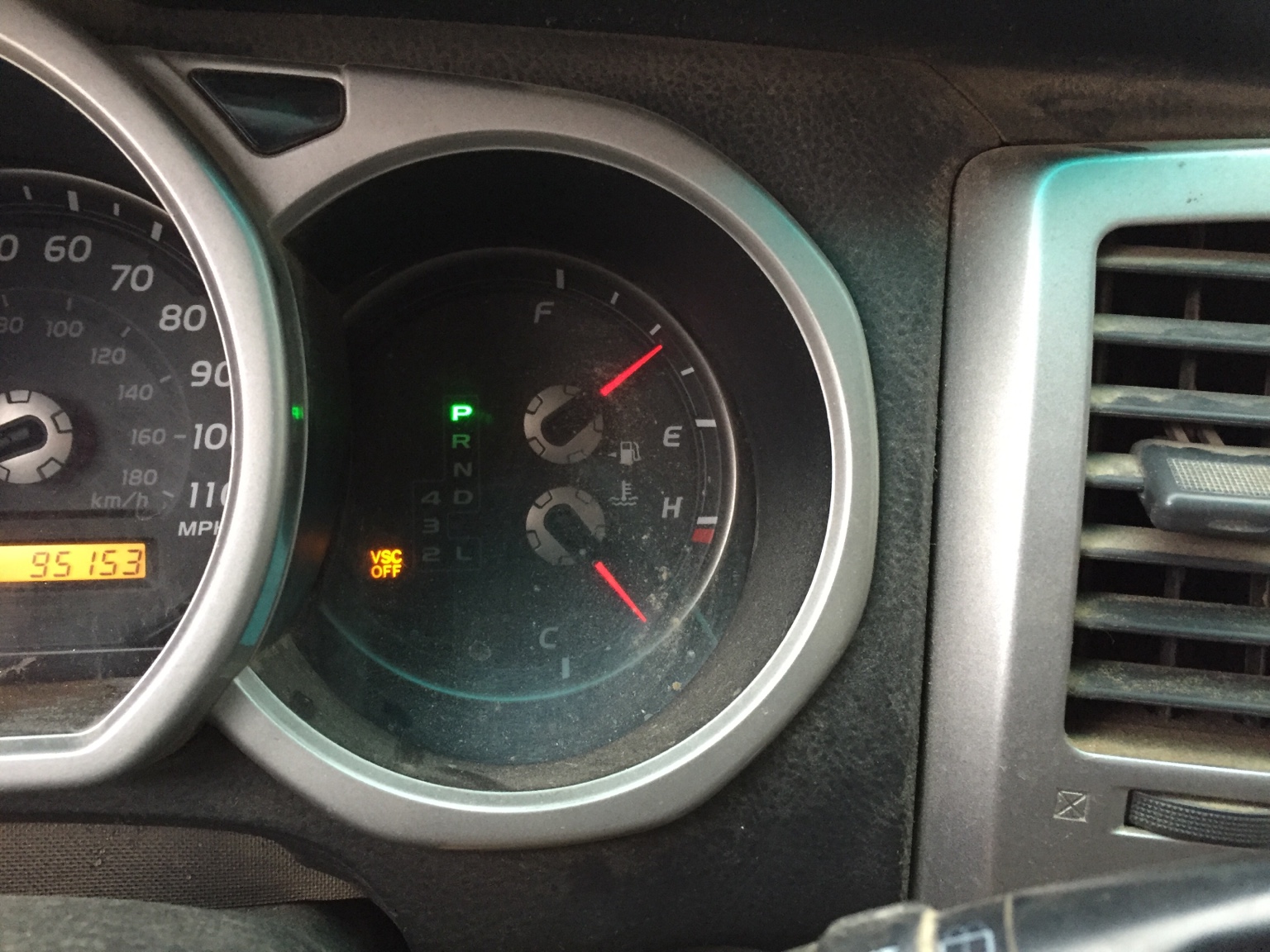

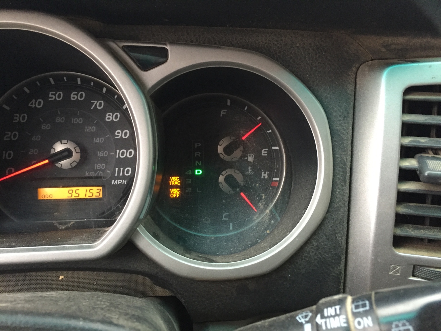

Here is what happened.
When I turn the engine on and am in park, all is well. When I press my VSC switch the VSC Off light turns on (center diff light does not come on like others have mentioned). {pic 1}
Then when I put my car in drive or reverse and move my wheels more or less one rotation, my VSC Off and VSC Trac lights come on (whether or not I have engaged my VSC switch) and stay on and do not go off until I turn my car off and restart the ECU. {pic 2}

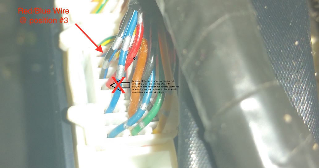

Thanks to Bulldog, CJ3Flyr, SSt4r, and WOLVERINE for the legwork on this. Finally wired a factory VSC OFF switch this afternoon and all seems well.
However, I'd like to point out that WOLVERINE's Red/ Blue wire is located incorrectly on his second image. The wire indicated by his arrow is solid red and the location of the correct wire is as indicated in the edited image below. It's hard to see in this particular image, but it's there. This was confirmed by SSt4r's identification of the 2003 location at position #3.
