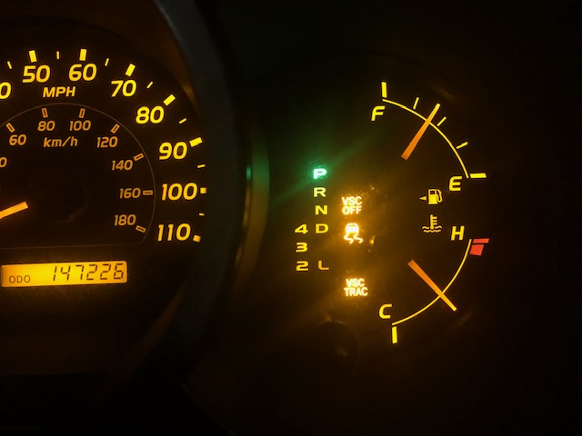

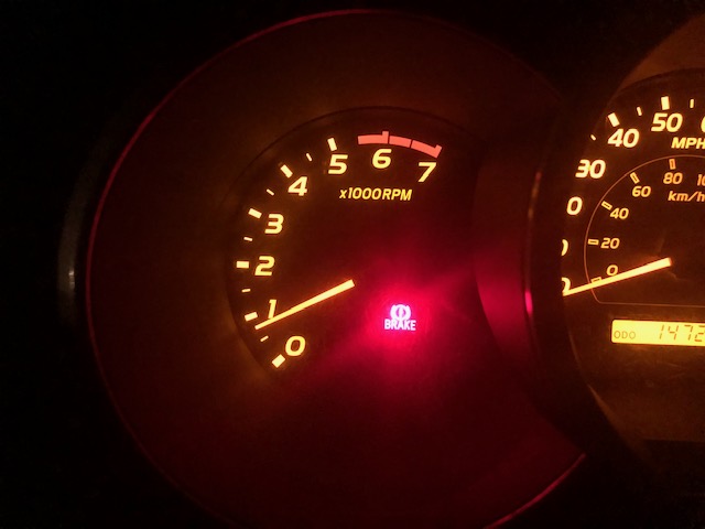

Similar problem here. 2007 V6 2WD/4WD sport edition. Gas attendant forgot to tighten cap and a day later i get a check engine light and the below 3 lights to the right. I tighten the cap and a day later the lights are all gone. 2 days pass and i get vibration going to work. noticeably worse when i brake. i pull over and notice a burning smell from the front passenger wheel. i drive the truck back home after work and no vibration what so ever. 30min in i park and shut off the engine. i turn it back on 5min later and i get the the same three lights, break light, but no engine light. pull over again to check the front passenger wheel. the wheel is slightly warmer than the others with a slight burning smell. not as bad as the morning. i did some reading but cant come to a conclusion. any suggestions? should i just bring it to the mechanic? thanks
Found the issue: I had a break leak. Had the lines replaced. Issue didn't come back.
