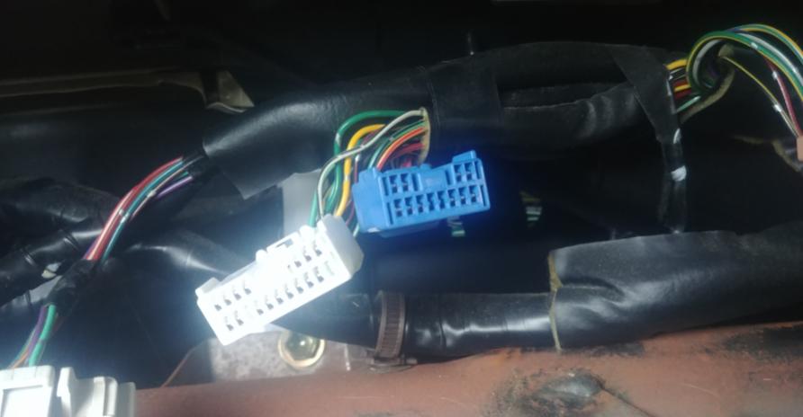

Ok so in an effort to narrow the issue down - I have found that the problem resets just like pulling the dome fuse if I pull this blue plug from the back of the cluster - guess now cut each wire next time it happens?? I will look back at the diagrams and see if the color of the plugs is labeled.
Also - pulling ABS fuse does nothing and unplugging the fuel tank plug does nothing.
This is that plug that when pulled, resets it.

That blue connector is "C28" or D on the Combination Meter pages.
Pin Color Function
1 Gr-L Raw speed signal from ABS ECU
2 B Tachometer signal from igniter
3 G-O Conditioned speed signal out to ECU, etc
4 Y-R Fuel Level Sender
5 O Fuel Level Sender
6 Br-B Ground for Fuel Level Sender
7 B-W Neutral signal
8 Couldn't find this on the diagrams, probably unused?
9 Should be unused
10 G Illumination power (10A Tail fuse) and other unknown functions
11 W-G Illumination variable negative voltaget (to rheostat)
12 L-Y To 15A Dome fuse (door ajar light and other unknown functions)
So, next try pulling these fuses individually:
- 10A Tail
- 15A Dome
And see if either/both reset it.
-Charlie

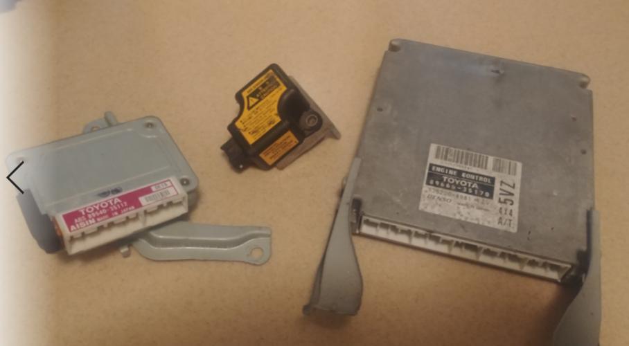

I am going to pull a main ECU tomorrow from the yard. Will it matter if it is from a wrecked 4runner? It's another 2000 (no airbags went off) same one I got the body ECU from.
i don't think an ECU from a wrecked 4R is a problem. typically given their location they are fairly well-protected from front and rear impact. that's where i got mine, for my 3slo conversion in my pickup, and that ECU still works great after six years (can't say as much for the engine, which self-destructed last fall). so long as the body matches your 4R's body and probably the transmission is a match, too, i don't see an issue. definitely see if anyone else has concerns.
Ok. I am going to spend a while at the yard today tearing apart this 2000 for all the electronics I can find.

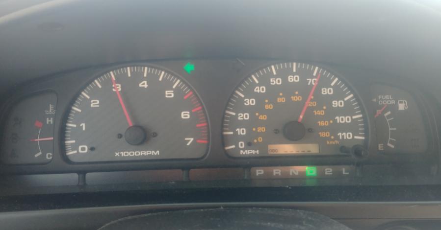

Was greeted with this joyful occurrence only a few miles into driving yesterday.
Thanks for all the advice this far guys. I don't want to throw the towel in yet.

Just got back with the loot: main ECU, ABS ECU, and this little ABS thingy
Which should I install first? Any bets?

And/or that ABS thingy would be second guess.
Hoping...
Cahil
fwiw i'd definitely swap in the ECU first. that kind of mindless behavior by your instrument panel, behavior that defies ten kinds of troubleshooting, starts to make me think the ECU's got some damage. make sure that you do that with the battery disconnected, and i'd also be (probably needlessly) thorough and pull and re-insert the ECU relay.
