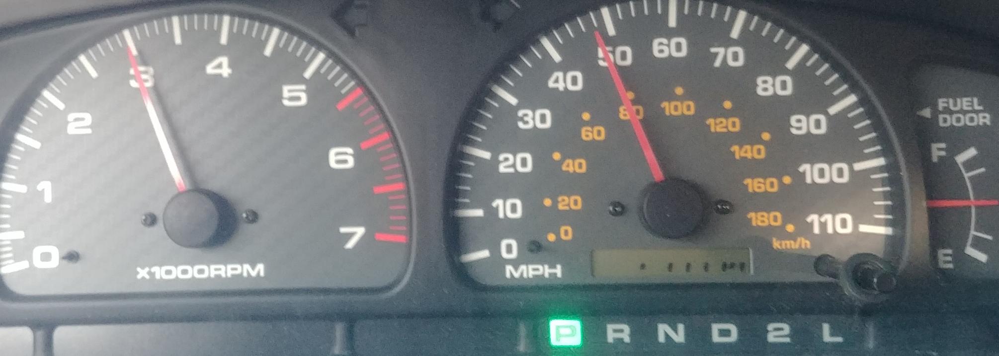

All locks and I believe lights work when it happens. Definitely head lights/dimmer
Happened again today close enough to home to safely make it without fixing it. I found that pulling the 15 amp DOME fuse has the same effect as taking the battery negative terminal off and back on. It fixes it just like the battery method.
Not sure if this gets us any farther???
Guess its something on the DOME circuit?
The pic is what it looks like when it happens, first time uploading pics please let me know if it works.
Thanks!

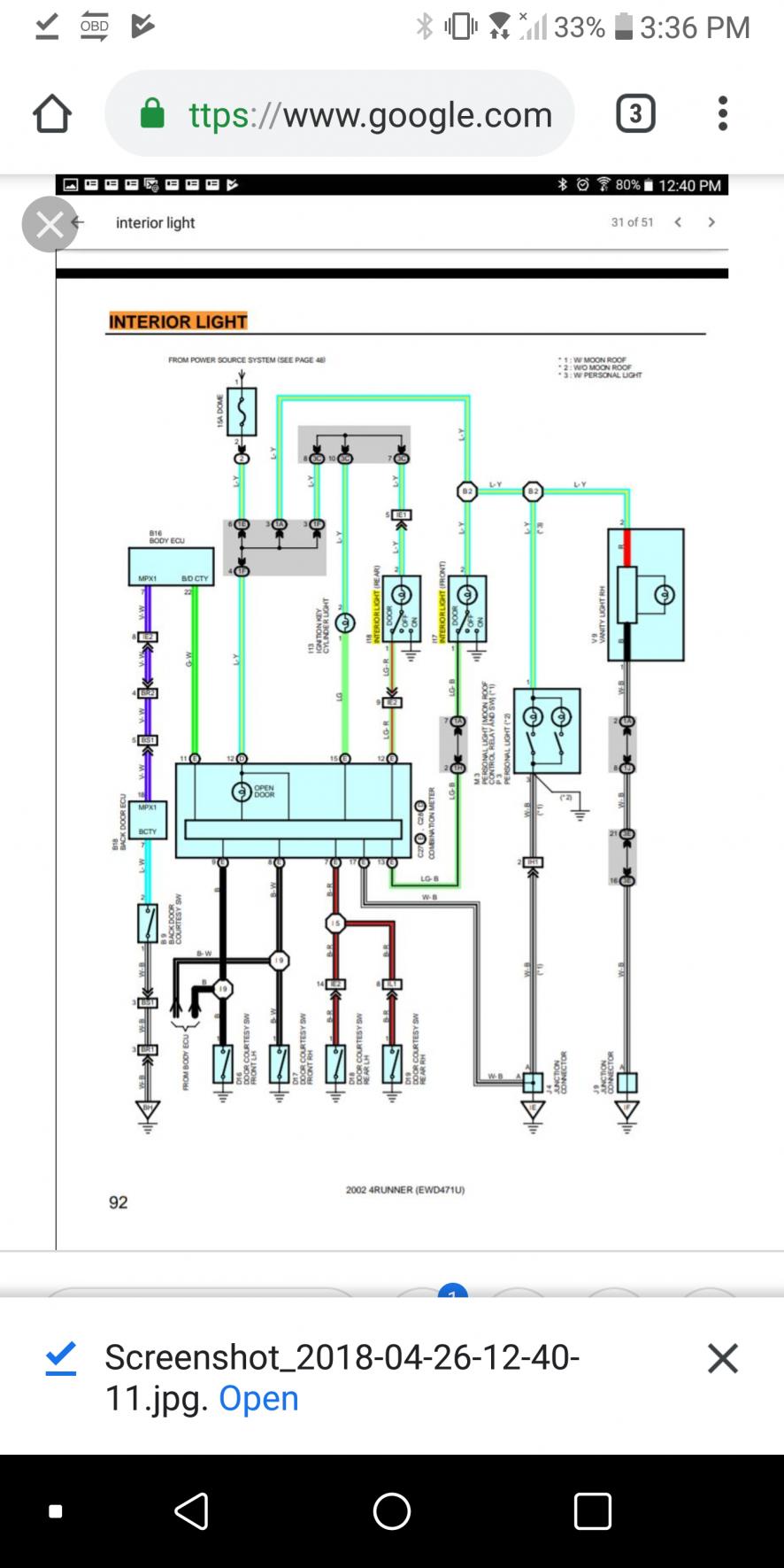

Does anyone have downloadable copies of the instrument cluster wiring diagram?
I've been using this one which shows the 15 amp DOME fuse circuit. Just checked the sunroof and dome lights as well as the door courtesy switches.
Does the cluster receive power only from the DOME circuit? Or from other places once the engine is started.

Is the body ECU on the DOME fuse?
The body ECU has connections to many fuses - MPX-B, ECU-IG, POWER, HORN, WIPER, ACC and probably others.
You are on to something here through - it might be worth trying to remove individual fuses instead of the battery main ground to try to see which one resets the cluster.
A replacement body ECU might be worth trying to see if that can do it too - I did finally find one direct connection between the Body ECU and the Gauge Cluster (Combination Meter) on the multiplex communication bus pages of the diagrams - it look like it could be some sort of communication between the two.
