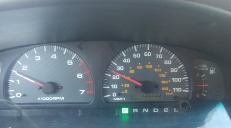

I have never swapped ECUs, is there anything I should know? Other than take battery terminal off?

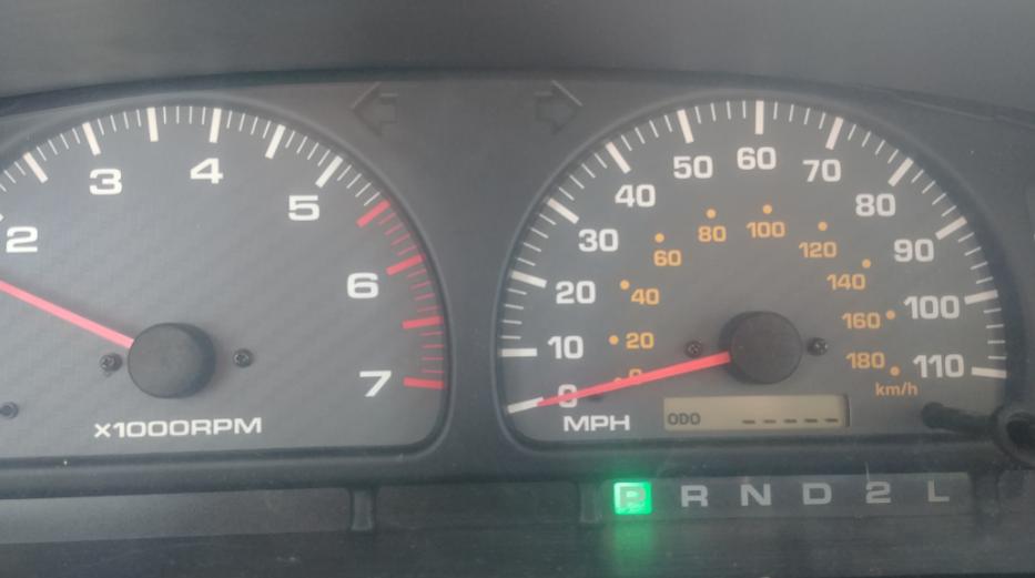

None of the parts at the yard made a difference. New ECU has no effect at all.
Would there be any issue if I just put the pin on the plug that resets it on a toggle switch so I can reset it while the truck is still running? Or would it get angry?

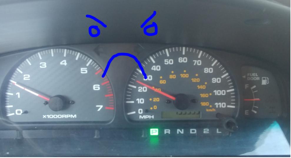

Hello once again guys, as much as I'd like to put my thread to rest, my 4runner persists on giving me this gauge issue. Hope everyone is healthy
So some updates
1. I have the pin on the plug that goes into the cluster that resets the issue on a switch now so its not a HUGE pita to fix the issue when it happens, engine does have to be shut off though
2. I have replaced the alternator with an OEM reman one, no change to the issue
3. I believe we can rule out the relatively recently replaced ABS tone ring on the right rear because I can confirm the issue has happened while vehicle is not moving.
4. It DEFINITELY seems to happen under hard acceleration/downshifts to pass other vehicles (I drive like an old man, but it still definitely happens much more commonly under these conditions than not)
