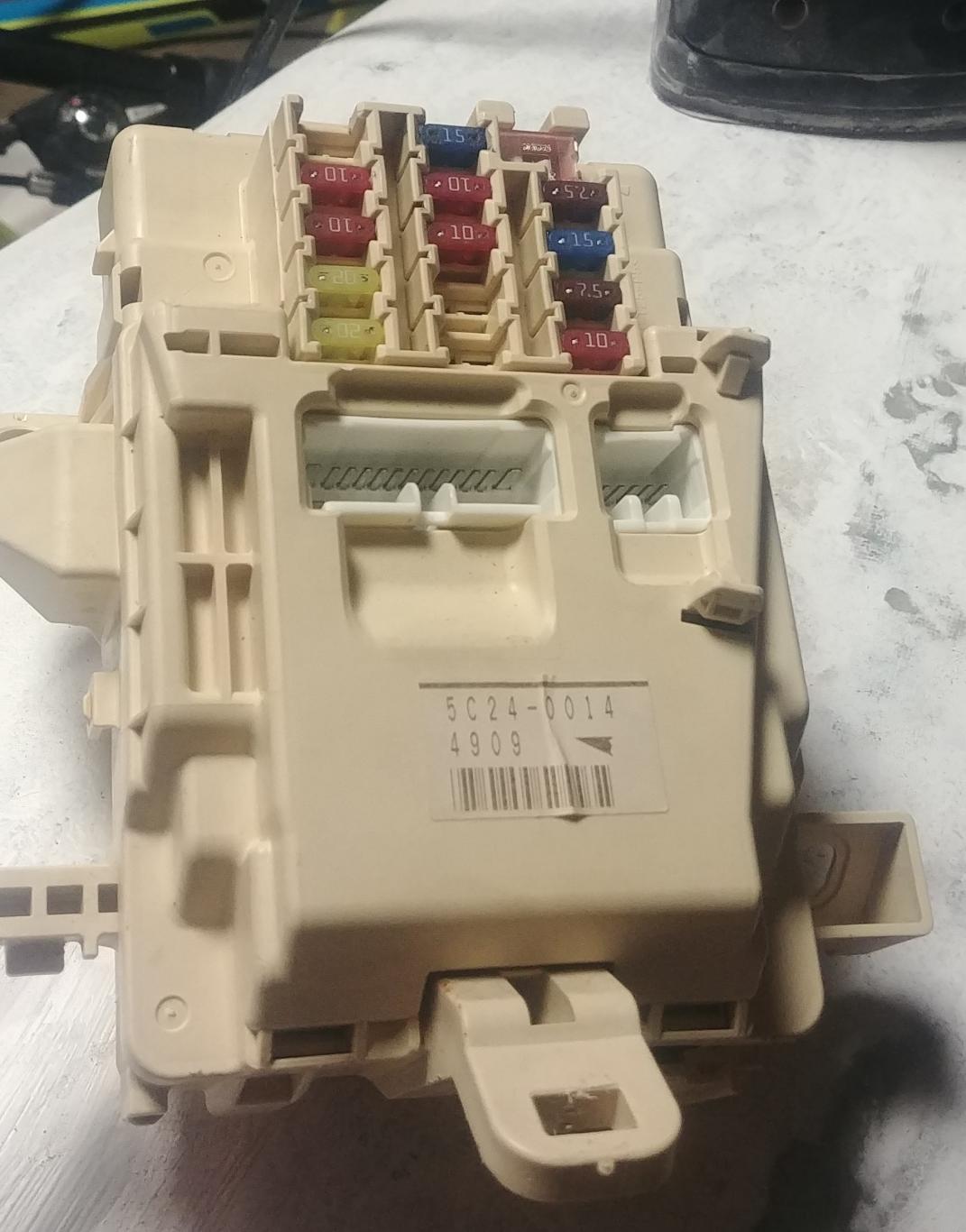

Found this at the yard for $20 yippee
Will swap out the other 2 relays on the back of it first and if that doesn't work i Will install it

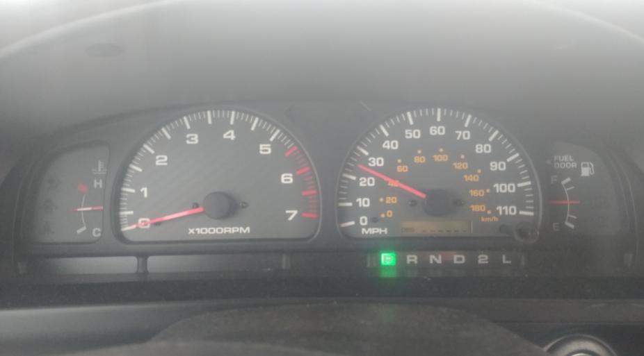

Ok folks, so I installed the "new" becm and the symptoms changed only slightly - instead of broken digits in the odo, when it happens I get this
I guess that means the BECM is connected to the cluster after all - but the issue persists.
I am at a loss at this point. main ECM?

So if I'm viewing that picture correctly...
In park.
Speedo registers 25 mph.
ODO weird characters.
Known good cluster. Swapped, problem remains.

The new diagram contains the problem. Minus super weird stuff, circuit interference, frequency overlap... Bleh. Uncommon for Toyotas.
Taking a snap shot 'right now' and your prior comment of 'happens less' in heat...

Possible next time this happens as in the picture above to unplug the speed sensor.
Any change in the cluster?
Same basic principle you did before with the battery cable but this time do it with the speed sensor.

Thanks for the input Piney, I will look over grounds once again - but am led to believe it is related somehow to the becm because the symptoms changed slightly when I changed the becm unit - now when it happens the odo reads _ _ _ _ _ _ instead of broken digits as it did before - am I correct in assuming this means the becm is connected to the error?
