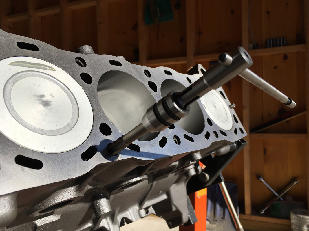

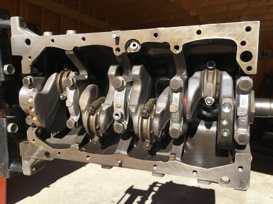

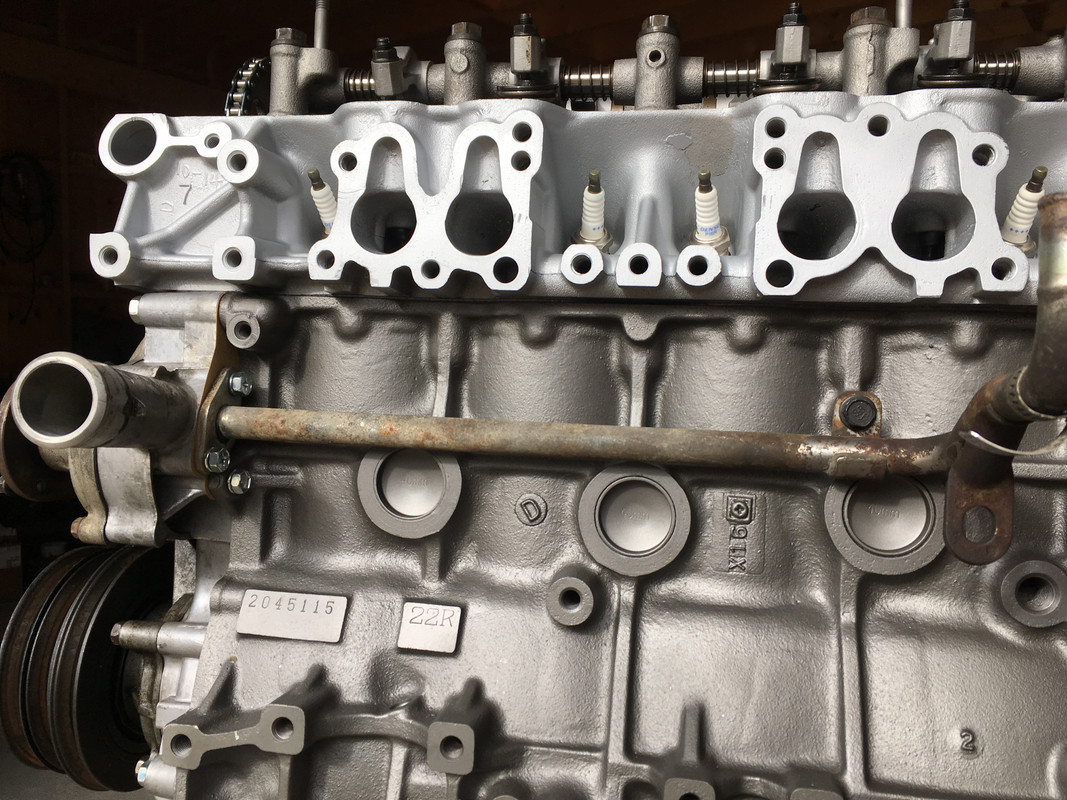

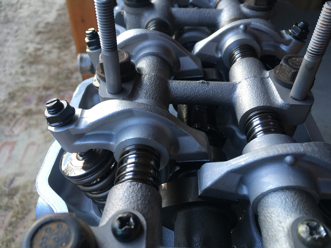

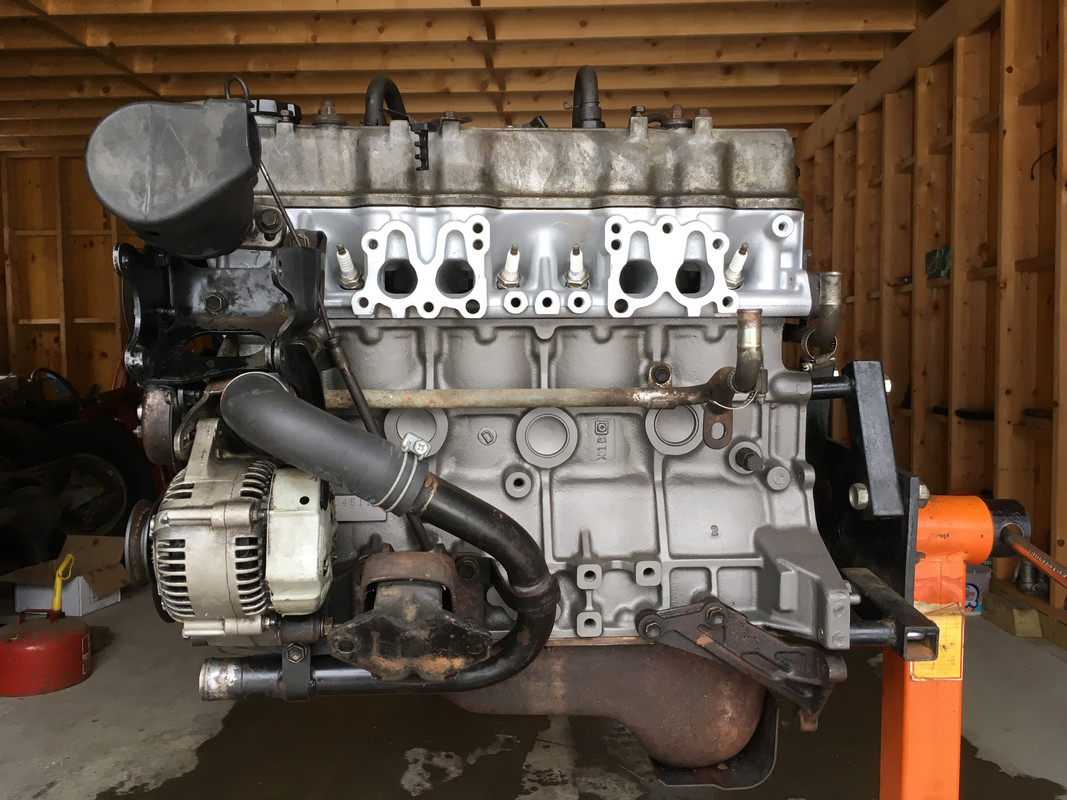

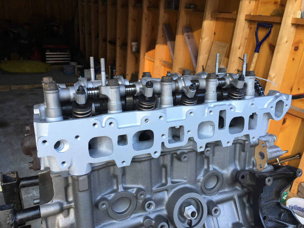

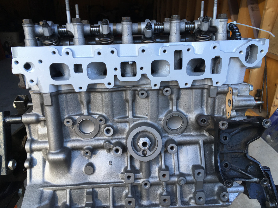

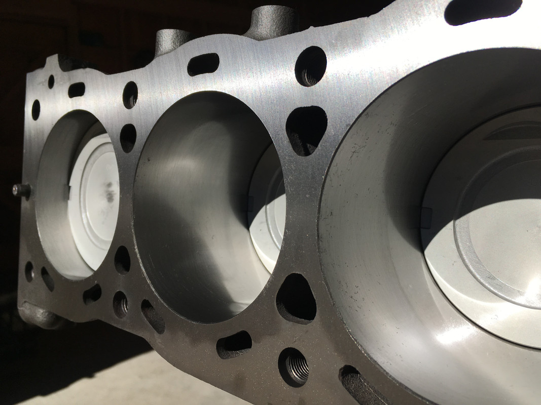

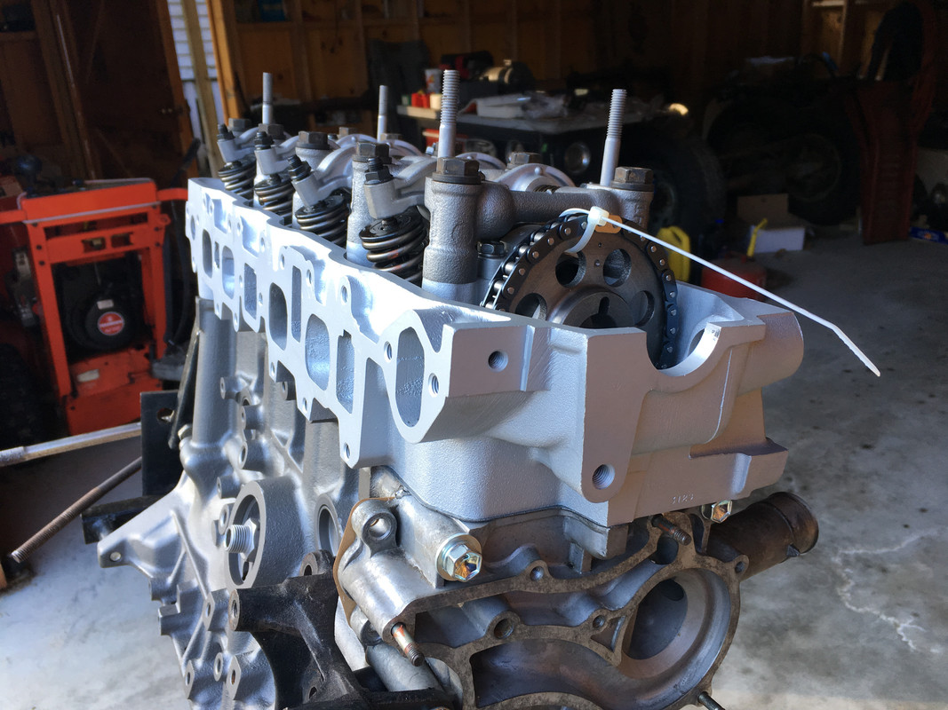

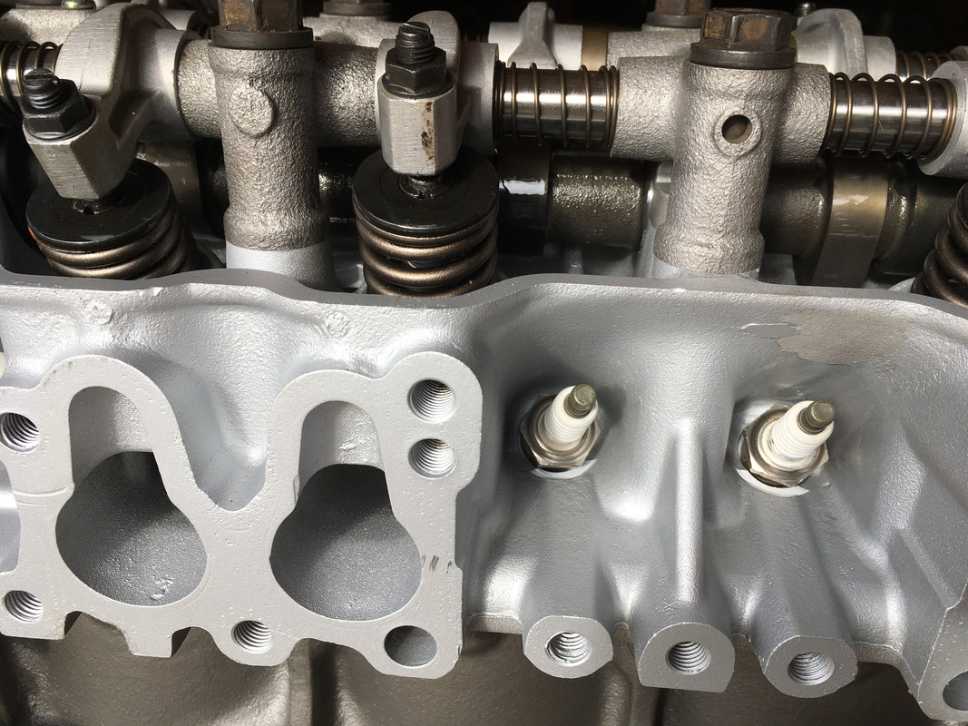

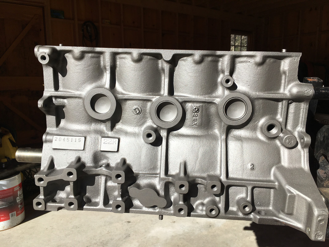

rebuilding the 22re from my other '87 4runner, a white sr5 5-speed, 242K miles. after pulling the engine, it was clear that a previous owner used "stop leak" or similar snake-oil to try to solve/hide a problem. so i decided to rebuild the engine, as it appeared to be in decent condition. had the block and head cleaned and checked for cracks; solid report. so, the block got decked (along with the timing cover and the original toyota head was reused with a new valvetrain/cam installed).
pulling it:

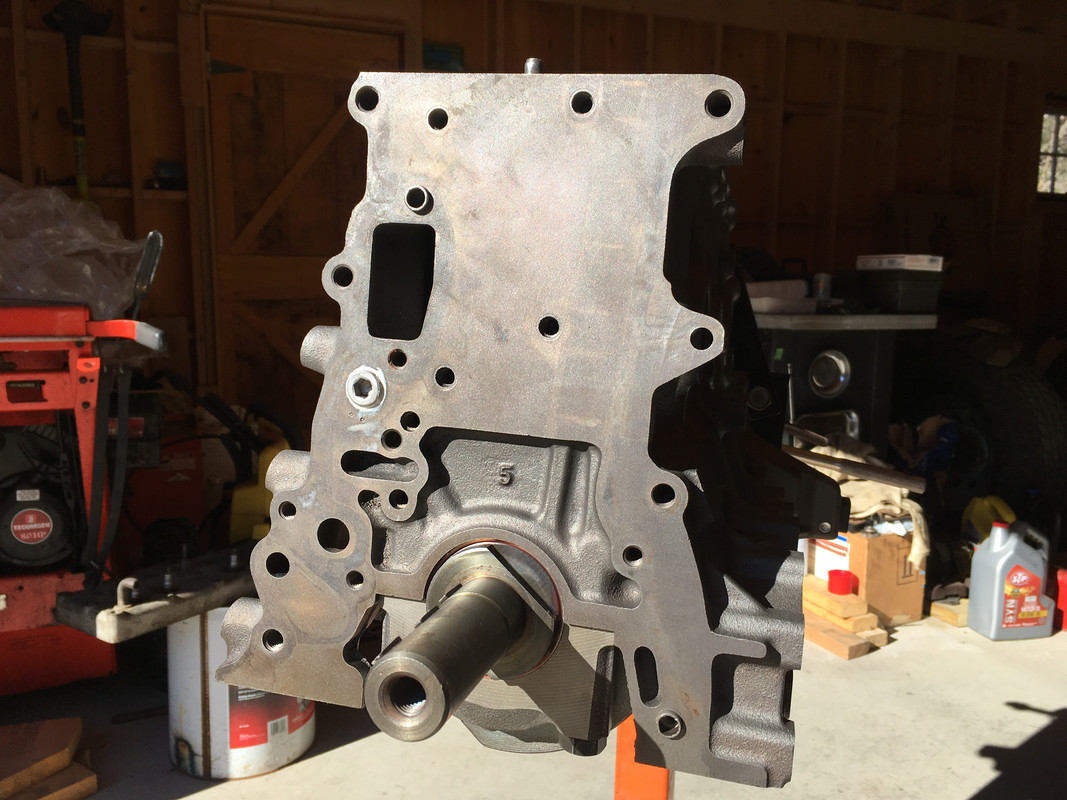

back from the machine shop:

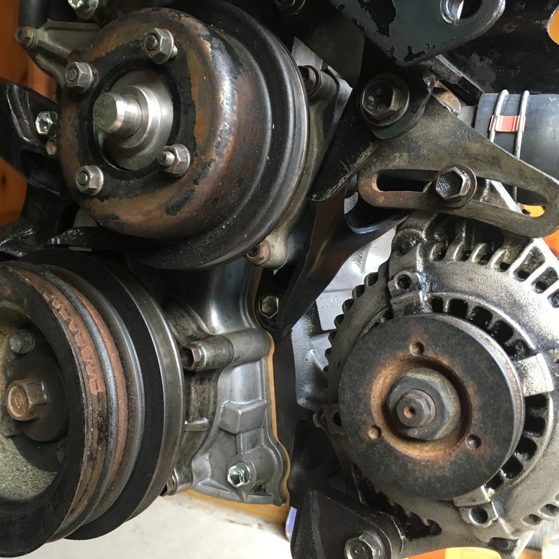

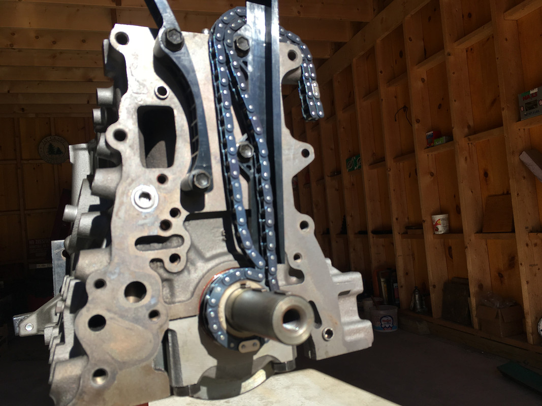

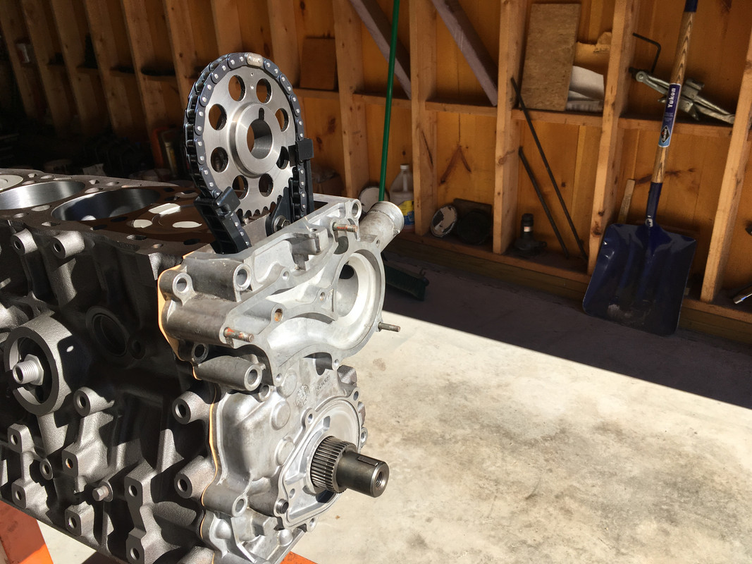

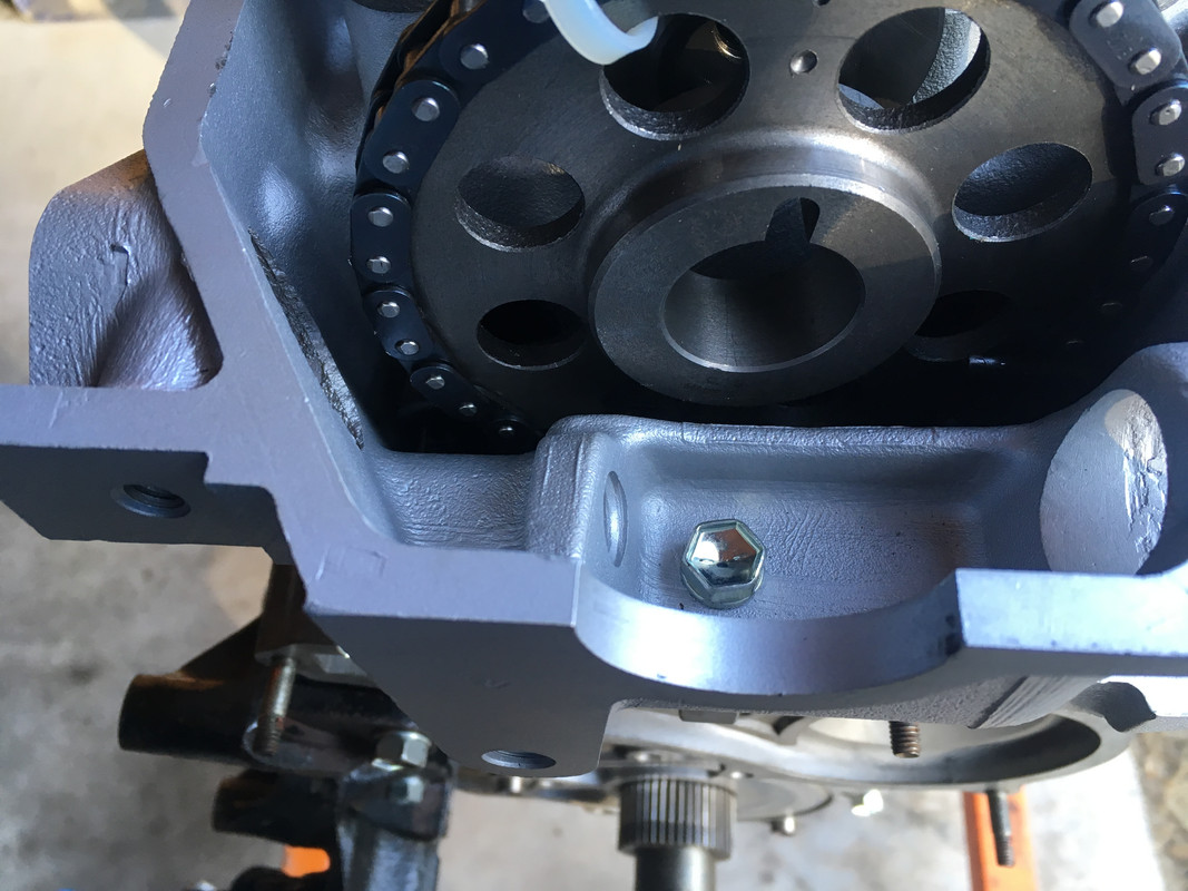

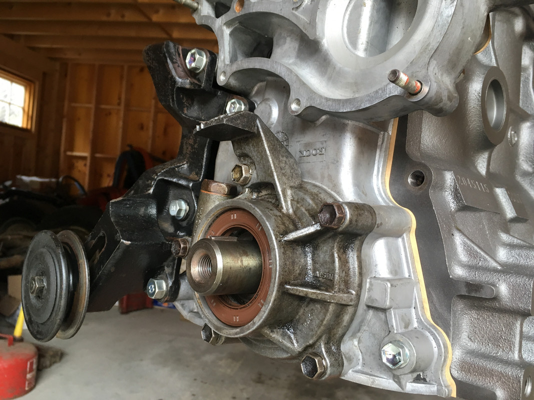

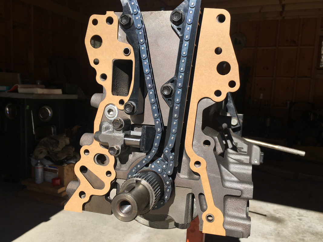

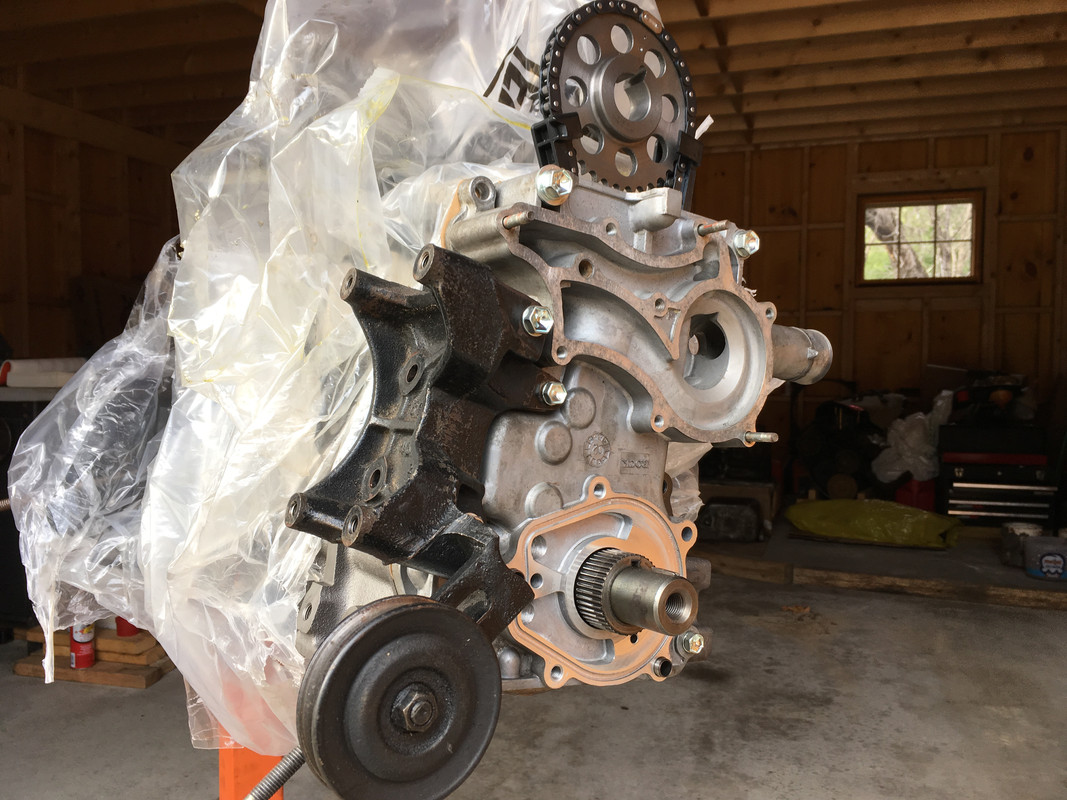

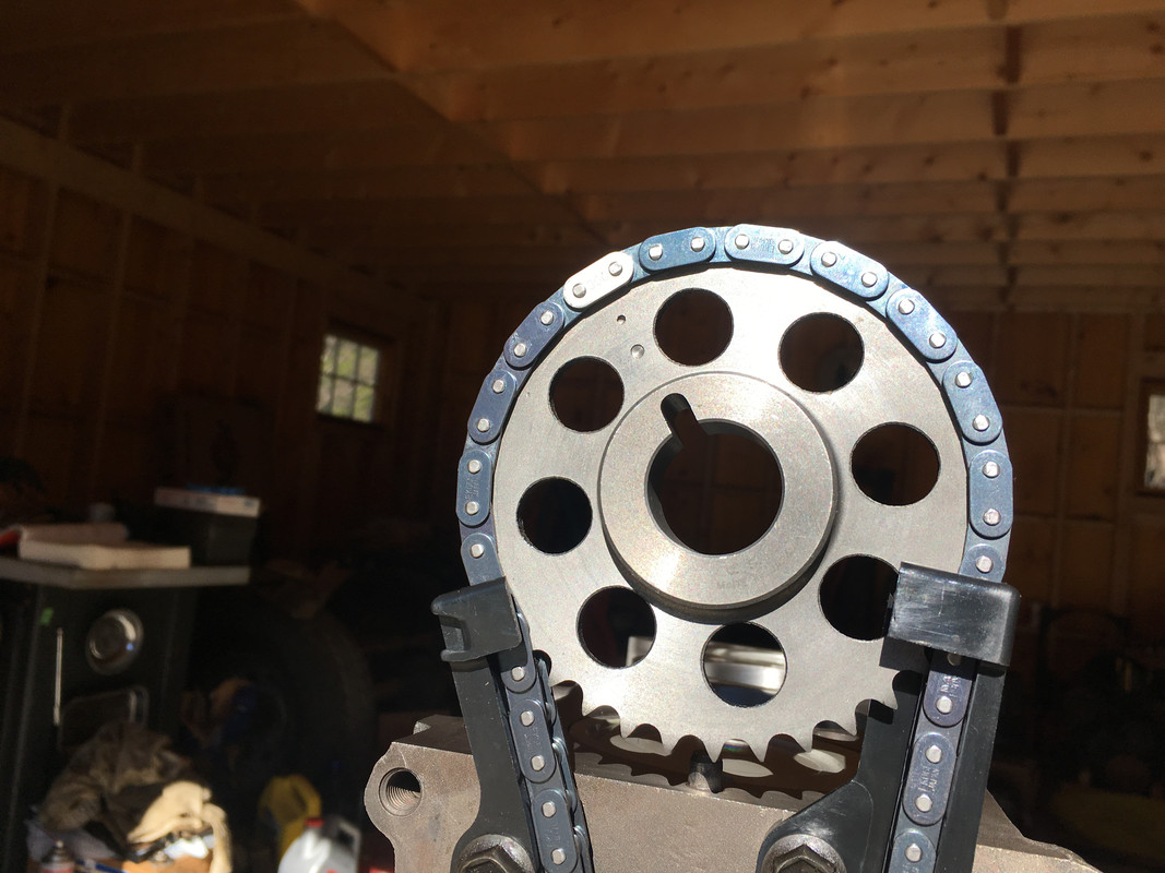

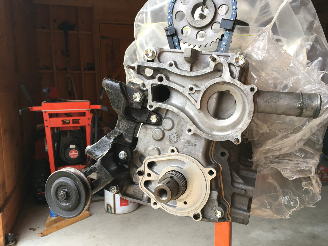

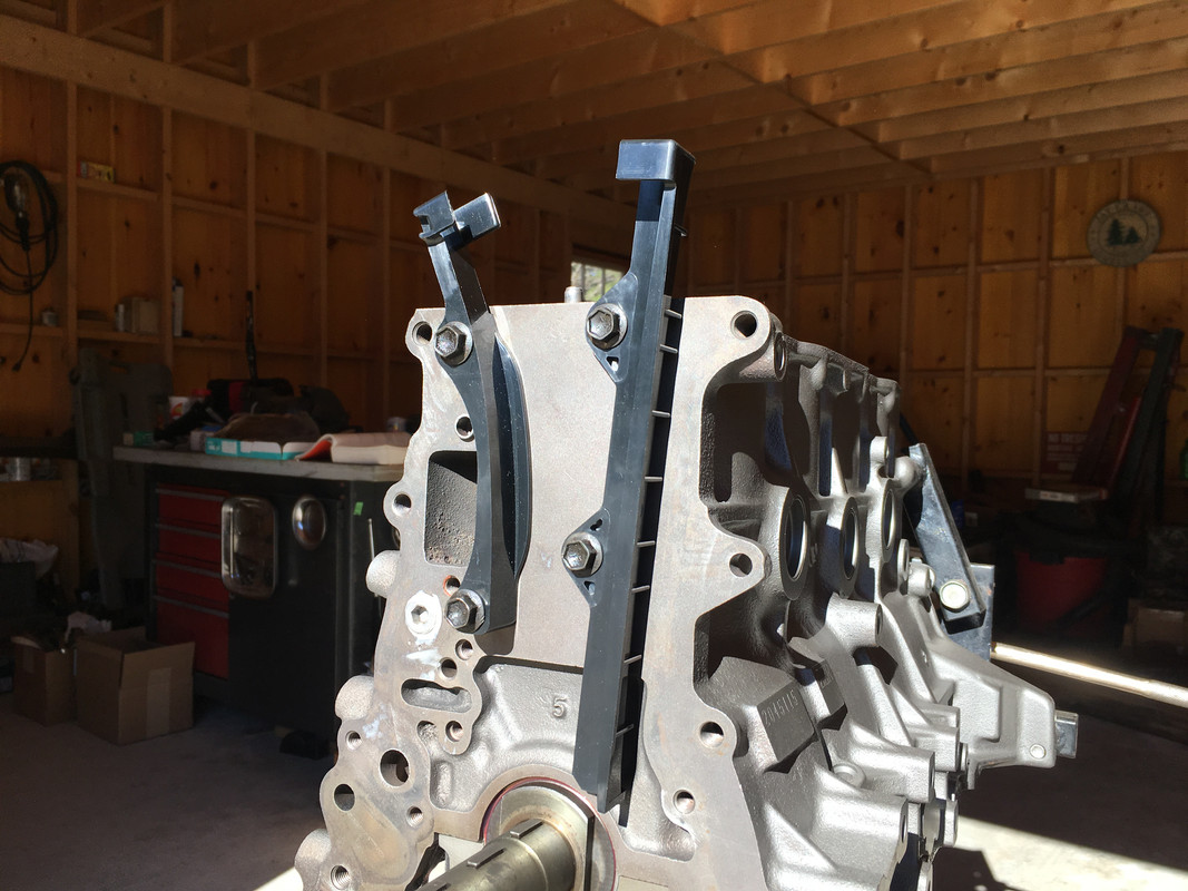

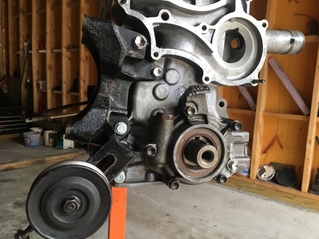

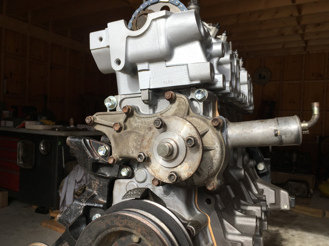

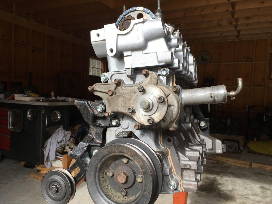

new timing chain set added, although reusing the timing cover.

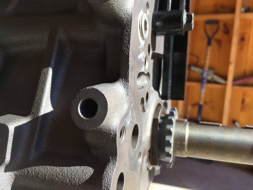

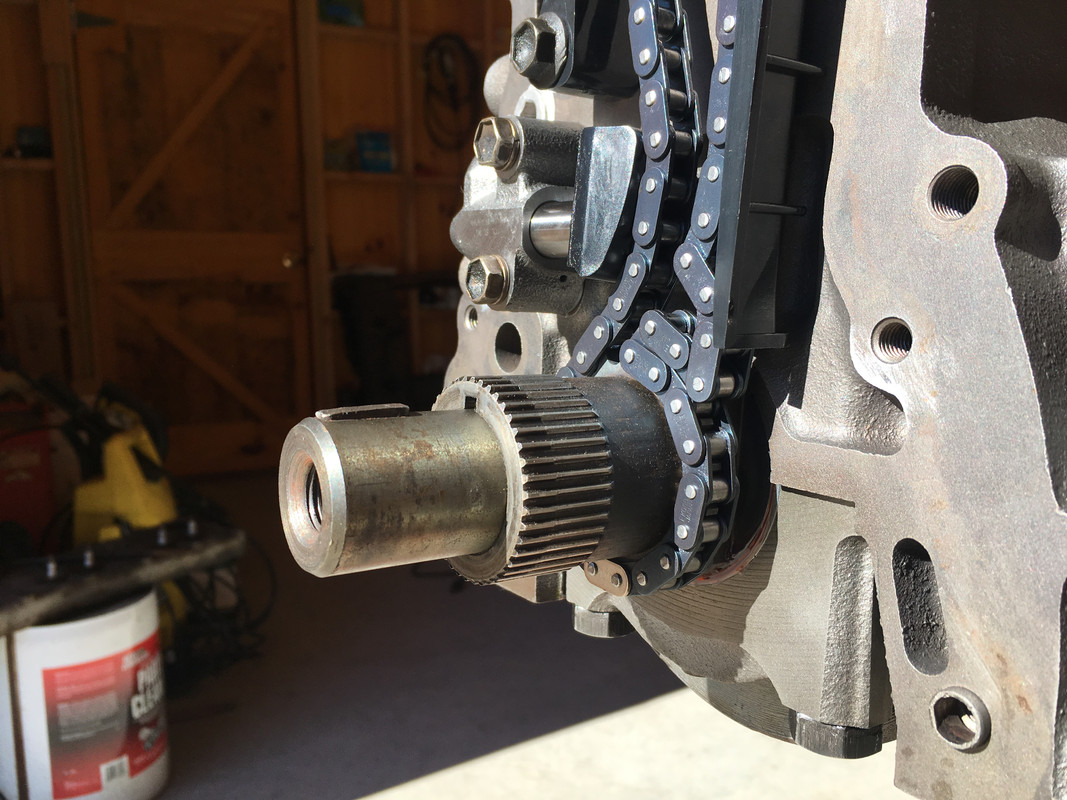

used a rubber mallet to tap the timing crank sprocket on
prior to installing the chain components, i tapped the threads with appropriate sized taps to clear and clean the block threads, and used CRC drilling/tapping oil to lubricate the tap. i also purchased a new set of timing cover bolts from 22re performance - a nice kit, and each bolt came in its own bag with a label, along with a diagram showing where each fits on the timing cover. torqued the bolts using torque wrenches. 29 ft-lbs for the 10mm bolts, 109 in-lbs for the 8mm bolts

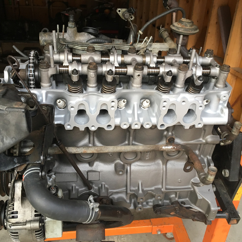

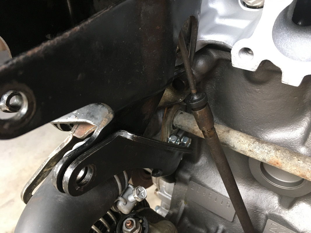

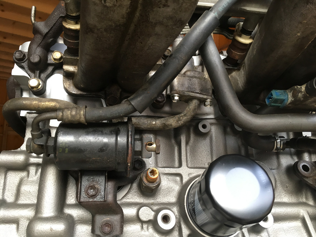

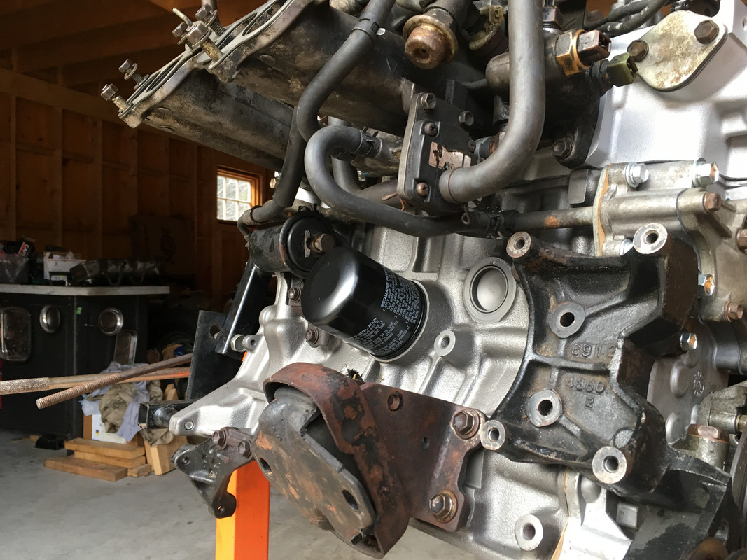

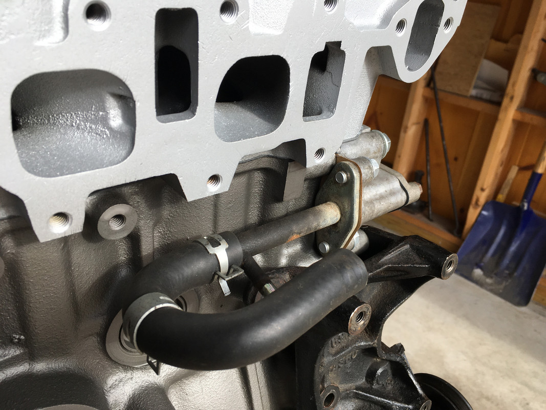

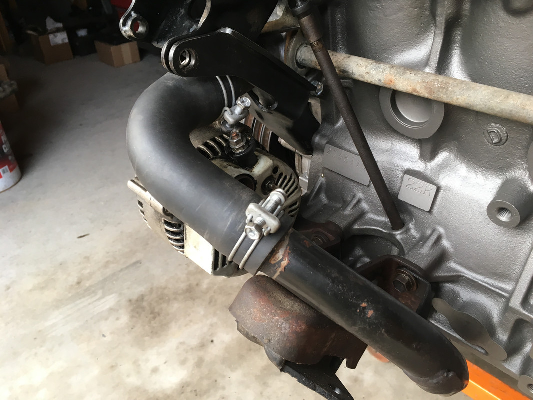

more pics coming, but i got the engine installed back in the 4runner. started on the first attempt at cranking it, and took about 5 seconds. ran a bit rough at first, but it quickly smoothed out. still need to adjust the clutch pedal and put the hood back on.
a few coolant drips needed to be addressed; all were solved by tightening the hose clamps.
battery was good enough to start, too. hasn’t been used since january, but it has been on a solar charger.

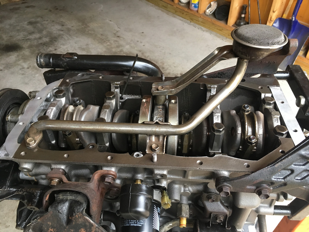

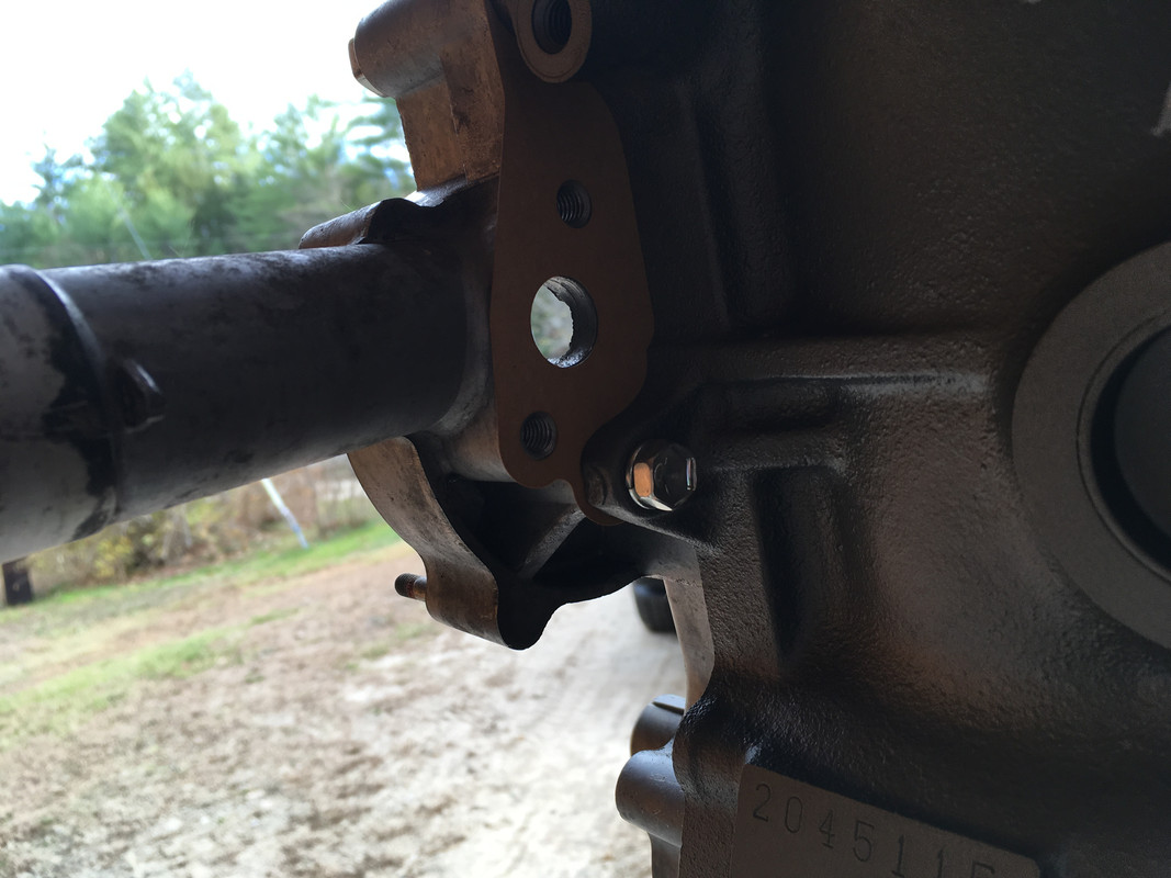

oil strainer/pickup installed
motor mount cushion

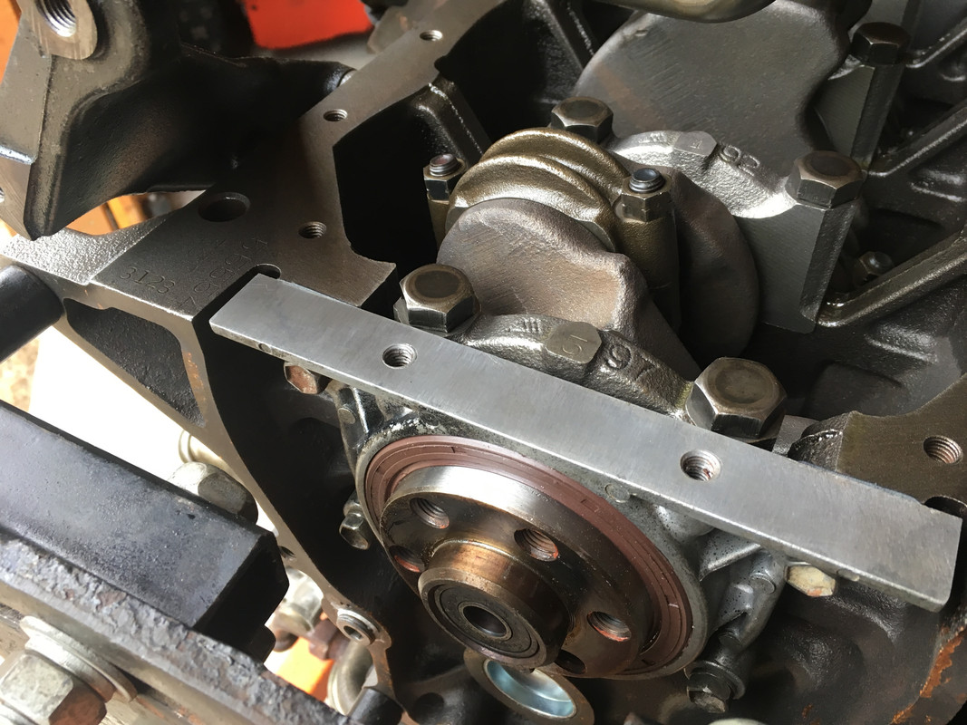

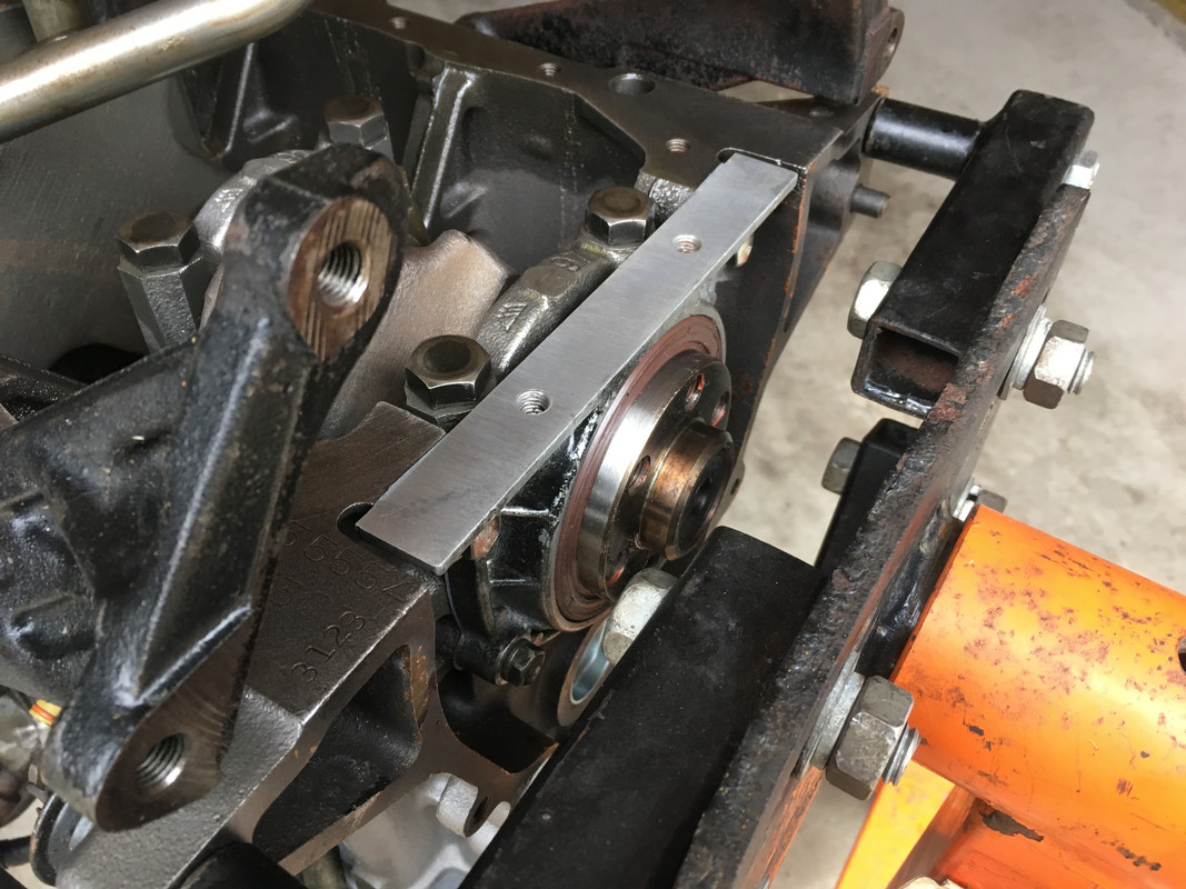

rear main - note that it is possible to install and torque correctly even mounted to the engine stand
