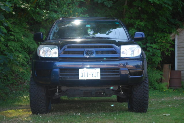

It actually came out pretty nice. I didn't take any before pictures but here are the afters. The tail lights were already blacked out.
Yes I know my runner has some cute little scuffs on it.
Nicely done!...looks good...I did the tails last spring and still trying to find some time to do the rest.

Dame, that looks good. I even like how you blacked out the 3rd brake light. I was thinking about using window tint myself, but this looks pretty good.
i blacked all mine out with VHT night shades all of the back and all the front except my headlights
