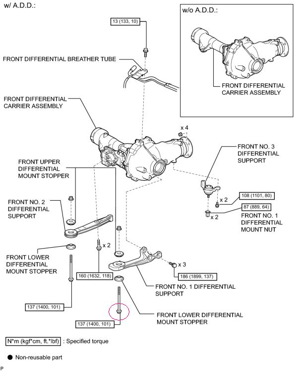

While installing my front diff drop over the weekend I encountered something that concerns me a little. When I loosened the driver side diff mounting bolt a yellowish liquid started dripping from the bottom of the bolt. It turned out to be slightly rusty water that was trapped behind the bolt in the hole. The passenger side didn't have any. Since there are skid plates blocking splashes, etc. and I haven't driven through deep water and it's been two weeks since the last car wash I am surprised that any water could get in there let alone be there after two weeks.
The rust in the water concerns me since this is one of only two mounting points for the diff. When I put it back together I coated the bolt shaft and head with anti-seize for added rust protection but who knows...
I'm not sure what to make of this and am just posting it here as info to others to watch out for.

I have a hard time visualizing where you are talking about, but could you drill a small pilot hole to facilitate draining without compromising the strength of the area holding the bolt?
Just a thought...
Okki
I don't think a drain hole can be drilled without compromising the diff mount. The red circled bolt head in the diagram below shows where the water came from as soon as I loosened it. I think it got in between the upper and lower "mount stopper" (aka bushings) and was trapped there. It was only about a tablespoon but any water retention is a concern for rusting.

For argument's sake, would it really matter if those bolts rusted out? Based on the diagram you posted, it seems like the upper nut is removable along with all the misc bushings and washers, so in the event it was heavily rusted couldn't we just replace all the pieces and call it a day?
Not that I'm suggesting that you should've just left it alone (since preventative maintenance is the best maintenance IMO), but I am curious if there's other detrimental effects that I am not realizing?
Good catch! Going to remove mine, pack the hole with grease and re-assebmble. One less thing to worry about down the road...
