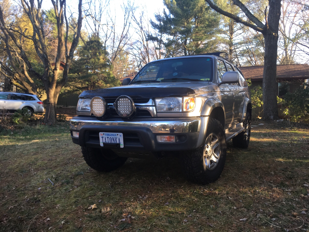

I love my '99 Tall front springs with the 5-way height adjustable perch Bilsteins. I'm on the 3rd perch of 5, and think I am at about 2.25" lift. Rides and handles awesome.
The rear is Superflex coils(3.5" lift without the in-coil bump stops/coil isolators), and they also ride and handle awesome with 5100 Bilstein shocks.
Looks like less lift than that(~2.25" & 3.5"), but that what it measures out as.

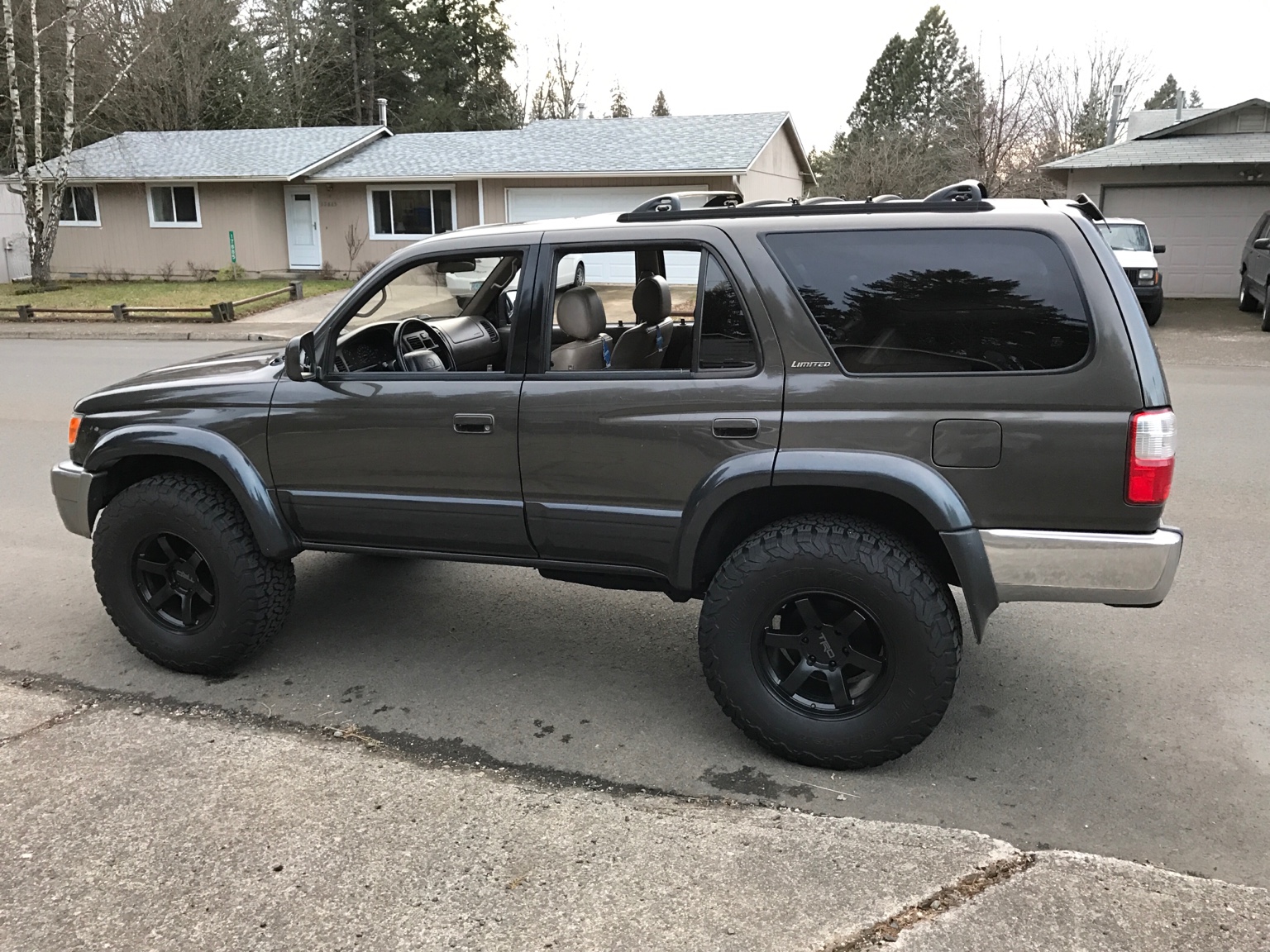

Ugh I remember when my 4runner looked that clean... when the sun hits mine right, it looks more like a raisin than a 4runner.
