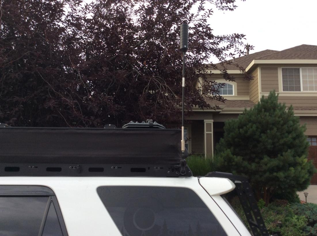

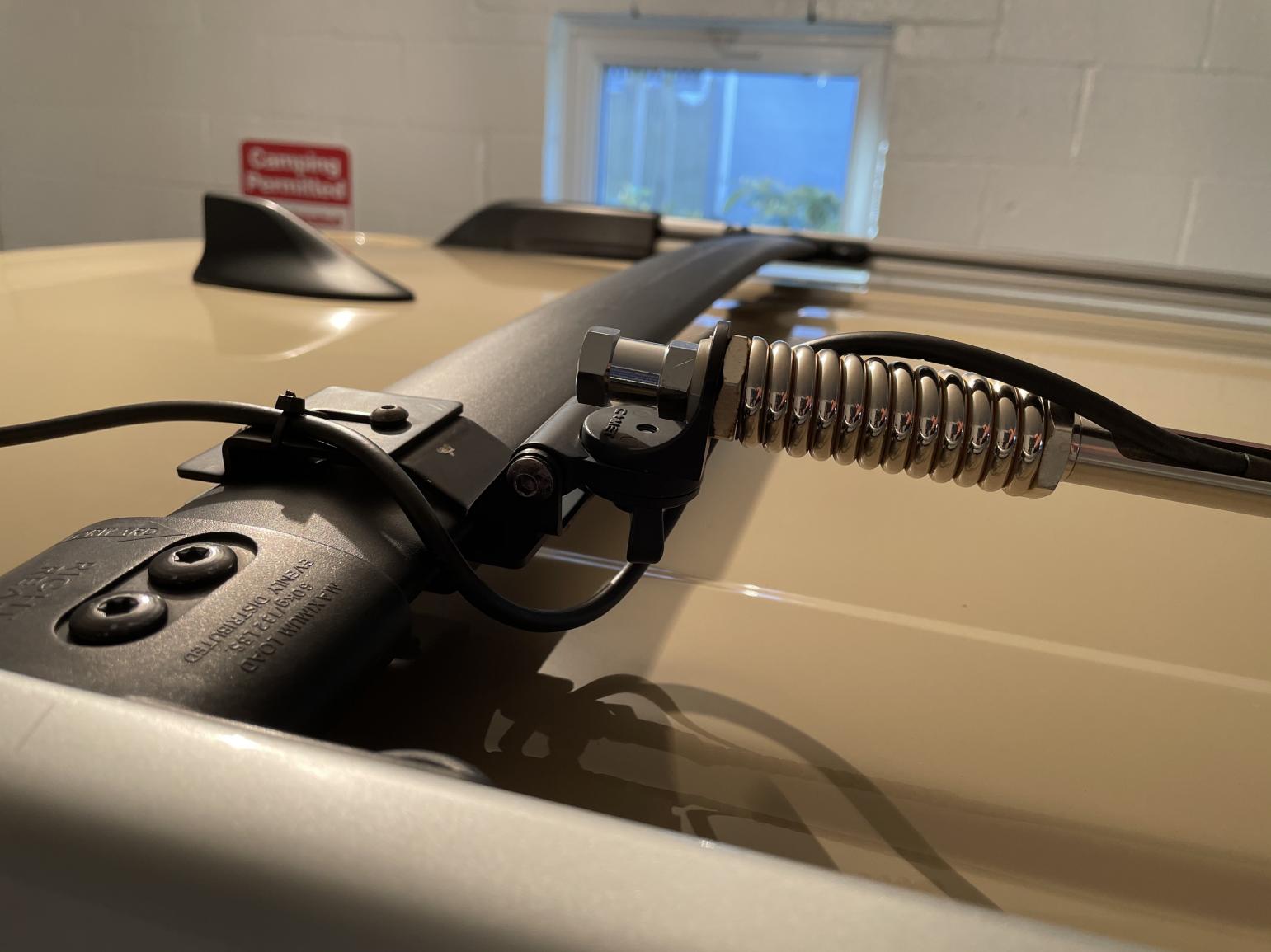

I bought a Weboost and I am finding it a challenge to mount.
I have a RTT and awning. I don’t want to fold it all the time. So really I am left with the side of my Victory rack between the RTT and awning. Finding a mount for this has been near impossible. Adding to the challenge is that it should be above the roof line.
Ram makes a B size swivel mount with a ball socket on the other end. They also make a ball I can attach to the end of the antenna. This would make it pretty clean and easy to fold down.
Thoughts on using a Ram Mount? I only found one person using it for an antenna
...I have already read and watched all the opinions on the Weboost.
Update:

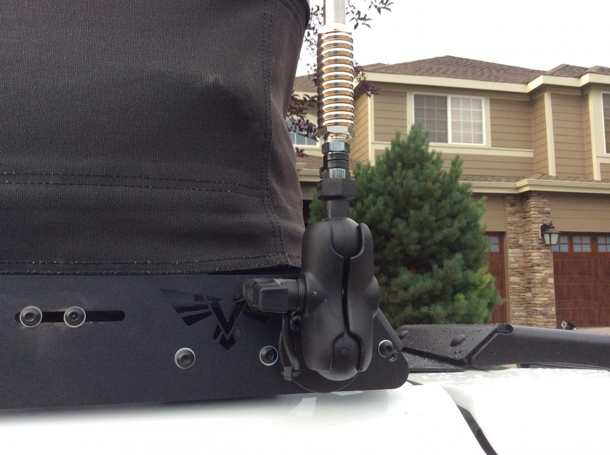

So after some trial and error this is where I landed. The parts above out of plastic had way to much flex and would not hold the antenna horizontal.

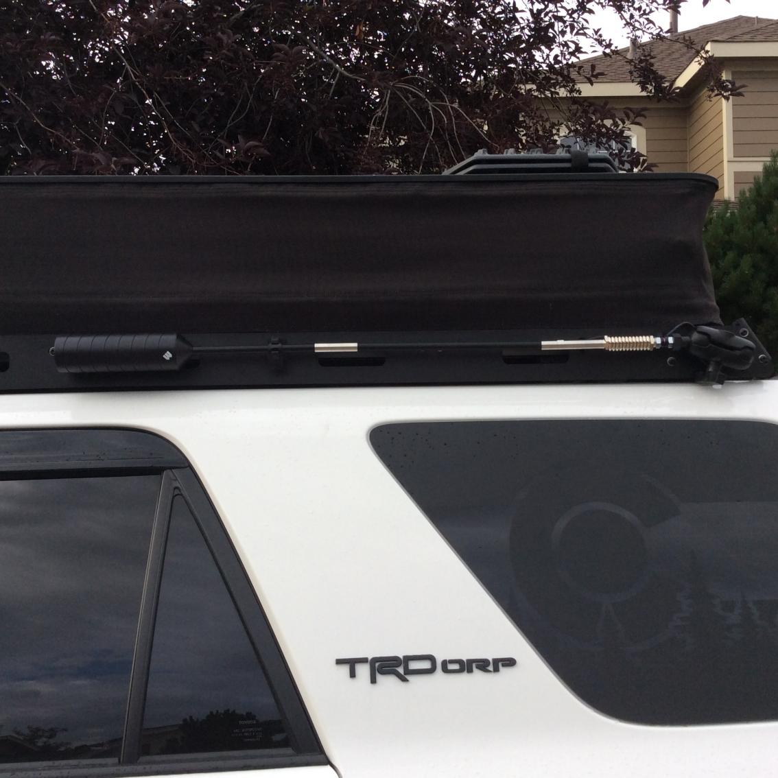

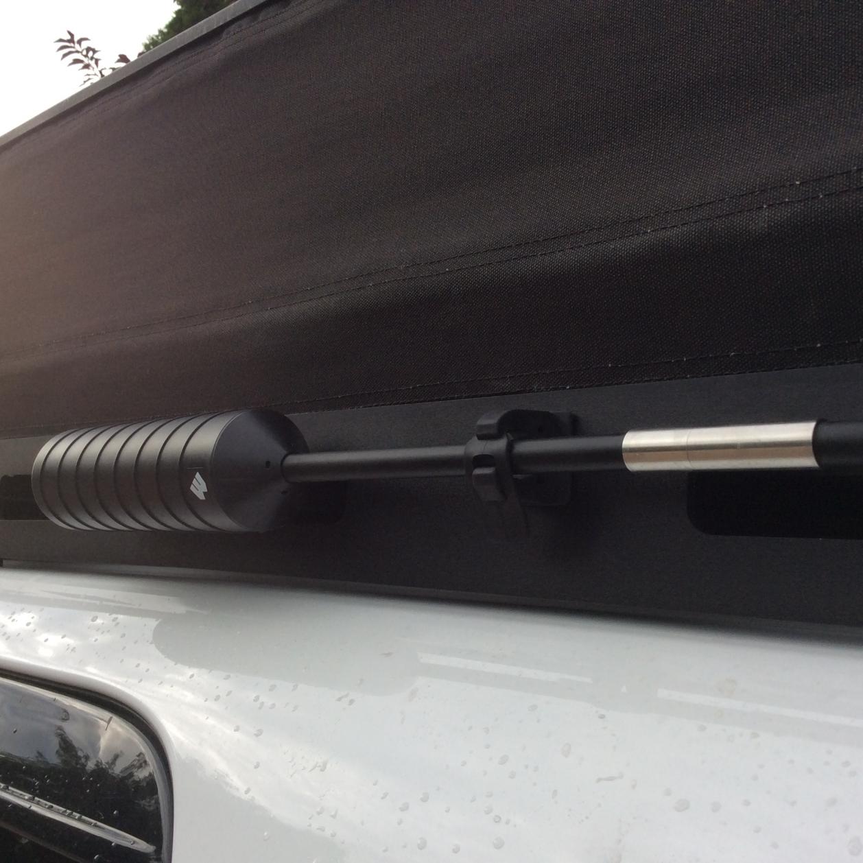

I went with 1.5 inch parts. Aluminum reinforced ball mount, short aluminum double ball arm and the direct thread on ball for the antenna. Used 3 holes to mount and one hole as a pass through for the cable. Extra small Quick Fist for the stored position.
Works great! Clean and easy. I do think I will remove the extension though for less height of the antenna.

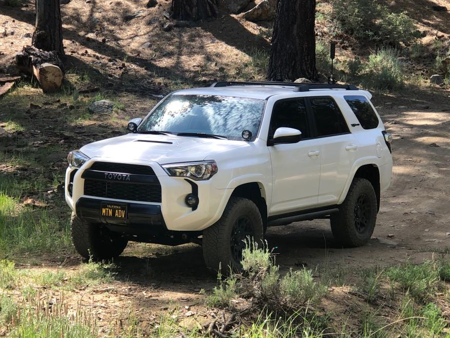

WeBoost works great as well. Even my driveway only gets 1 bar. With it on 4 bars. Same for any place I have driven even no bars to 3 bars.

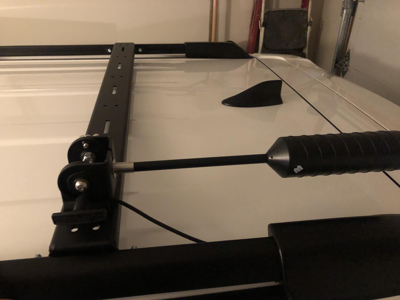

I went through the same thing.
Started with a Comet clamp mount to the stock crossbars, it wasn't great.
I then bought a couple Victory 4x4 crossbars and mounted a Rhino Rack Aerial Folding Mount. Perfect set up for me. Super stable and tool free raising and lowering the antenna.

I bought one of those and I agree it is well made. But with my RTT I can’t mount it to a rail.
Keep an eye on that RAM mount. I don't think they are UV resistant. It may become brittle and you will find your antenna beating around up there.
I picked up one of these Comet RS-660U mounts and can't seem to get it to fit on the stock 2020 crossbars without immediately falling off when I give it a few pounds of lateral torque. The instructions say it will go up to 56mm but the crossbar measures 65mm across (2-9/16"). I tried without the rubber padding and can't get a fit. Am I doing something wrong or will this simply not fit? Thanks.

I gave it another shot and did get the comet bracket to fit around a cross bar. It is an extremely tight fit that required loosening and tightening until it finally stuck in place.
I ran it up and down the mountain and the bracket stayed on for the entire ride. That said, I can see why it's had mixed reviews. I had the antenna in an upright position and had to stop a couple of times to retighten the bolt holding it in place. After the third time, I gave up and left it in its more aerodynamic position, flush with the roof.
So long as it's only being used while stationary, the comet mount seems to work well.

Does not appear to work when on roof in horizontal position.

The bolt can't seem to hold the antenna upright above 60mph so it leans back about 10 degrees where the bottom nut strikes the crossbar. Got to figure something out with that.
