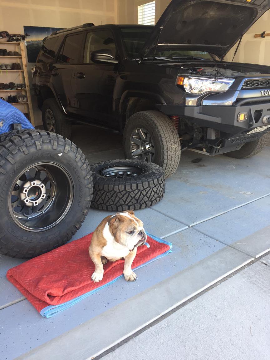

Nice, your 305's look great! I need to get a taller floor jack to mount mine...:cry2: tried last weekend but stacking 2x4 blocks on the jack didn't seem smart. My assistant wasn't helping either!

Any reasons you didn't go for the 3.5BS and drop the spacers on the F5?
I forget the actual numbers, but the 17x9 F5 was the equivalent of running a 35mm spacer on the regular 17x8.5 F5. I wasn't too keen on having to deal with clearance issues in case the 305's didn't work with the 17x9 wheel.

Nice! I haven't been able to air mine down and put them through their paces just yet, probably won't be able to until I hit Nevada next month. I did notice pretty immediately that these are a lot stiffer than the KO2s. I had to drop down to 35psi on my chalk test and to get some similar ride comfort from the 285/70 KO2s.
I usually jack from the center of my engine skid with a floor jack. I did max mine out on the rear diff getting the back tires on though.
