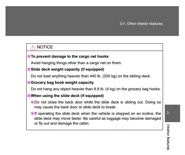

Does anyone know the max recommended weight capacity of the sliding cargo tray? I did search and read a couple threads mostly on folks removing these.
Not sure it would be of much benefit but I'm wondering if this can hold something like a snowblower when fully extended. I'm guessing it's for bikes, tools, smaller stuff.

300Lbs extended if memory serves me right. It's listed in the manual.
Okki
:rtfm:

I can tell you it won't hold up to 3-4 hundred pounds for extended periods, even if you never extend it.
Mine holds an ARB fridge and recovery equipment, has been extended maybe a dozen times, and from driving offroad has bent both of the slide rails and is a rattly piece of shit. At some point I plan to source the regular SR5 model parts to get rid of it.
