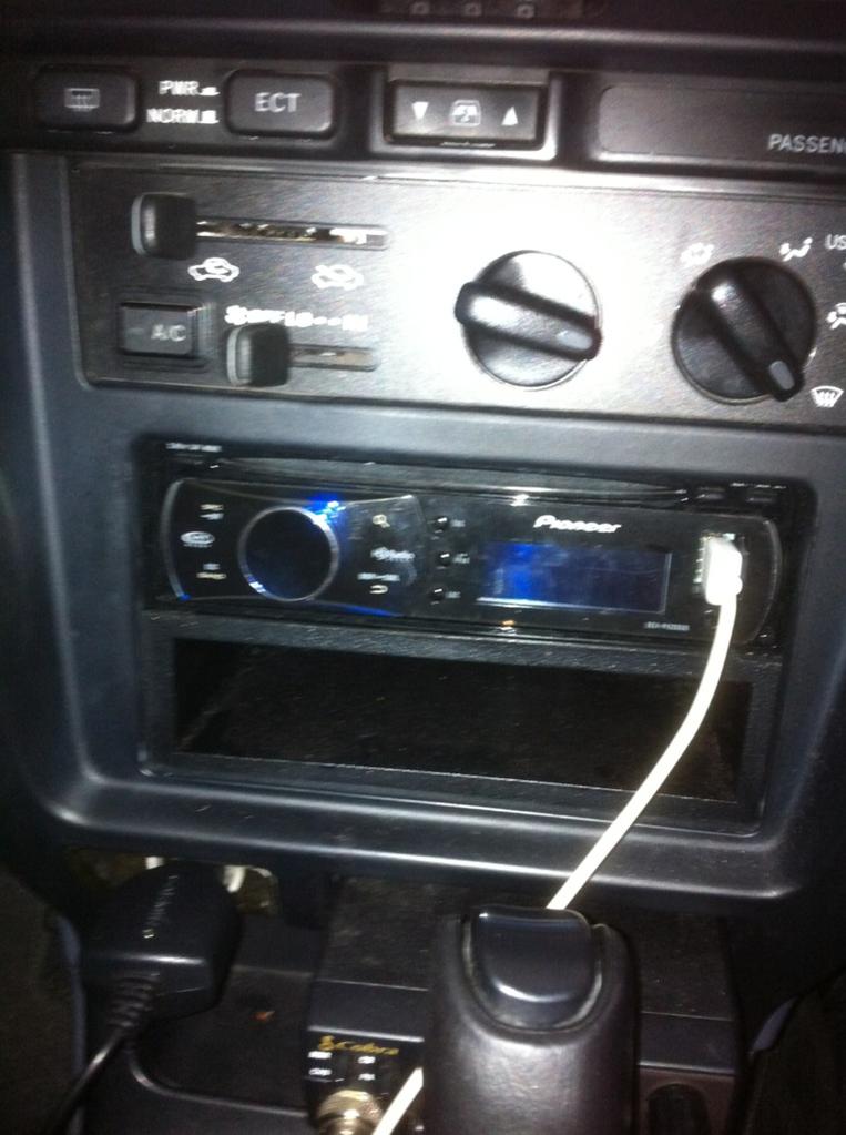

I didn't replace any speakers (the subs were more important and now I'm just saving up for speakers since I have the subs) so far but I will shortly. I put in a Pioneer DEH-4200UB head unit. I had that bad boy in my old 86 runner (loved that car) and got it out and slapped it into my 99. I attached an image of it, it looks great in it.
With the new headunit, I have MUCH better sound (only comparatively speaking to the old head unit and that crazy static with my iPod) and it actually charges my iPod when I plug it in (in the picture you can see my iPod chord). And for security, I can just take off the faceplate of the head unit and it is pure black so no one can even tell I'm supposed to have a radio in there! If you got any more electronics questions I can help you out.
