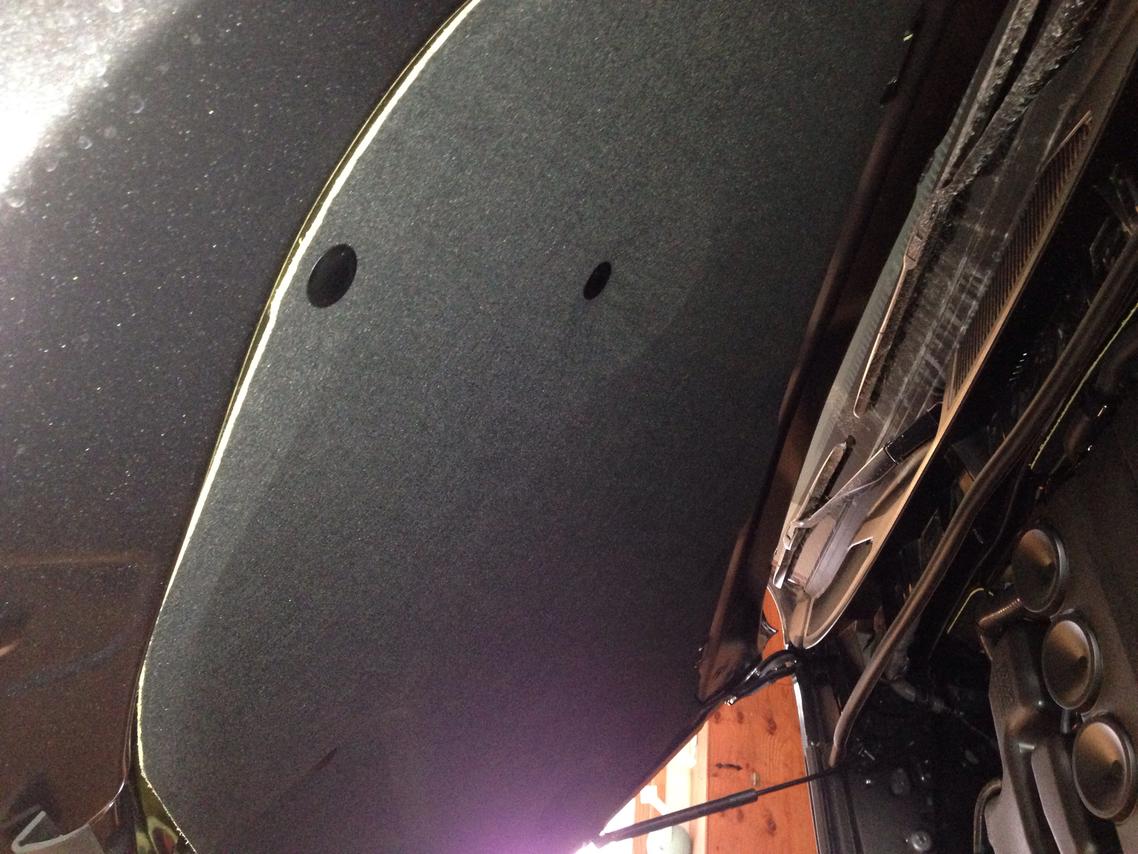

So they left the oil cap off from August to November. Correct? How many miles? There is no hood insulation on the TE or SR5, only the LE.
Did they just change this? My SR5 P. Has hood insulation.
You are correct. My previous two did not have and neither did anyone else as evidenced by this thread http://www.toyota-4runner.org/5th-gen-t4rs/89759-hood-insulation-missing-te.html. I just checked and my new SR5 does have insulation. Note to everyone who has a 2010-2013: Go buy a new 4Runner. They have hood insulation.
By reading the linked thread you will see nothing has really changed here in the past three years...
Wow! Hope this story has a happy resolution. I'd be stressed. I always check under the hood right after a service anyway just to make sure all is well including the fluid levels. Then do recheck at least a couple times a month. But I'm a bit OCD especially when it comes to my wheels. ;)
EDIT: I do not have hood insulation on my '12, came this way.
Or you can spare yourself from having a "Poop Front End" and buy hood insulation for a 2010-13 limited like I did.
Weird. My 2014 SR5p does not have hood insulation.
Wonder if it t's one of those dealer options or something... What is it for anyway? Keeping heat from the paint and premature aging or noise or ???

Anyhow... he chdcked my vin and my vehicle did not come with hood insulation. I guess its vehicle dependent?
