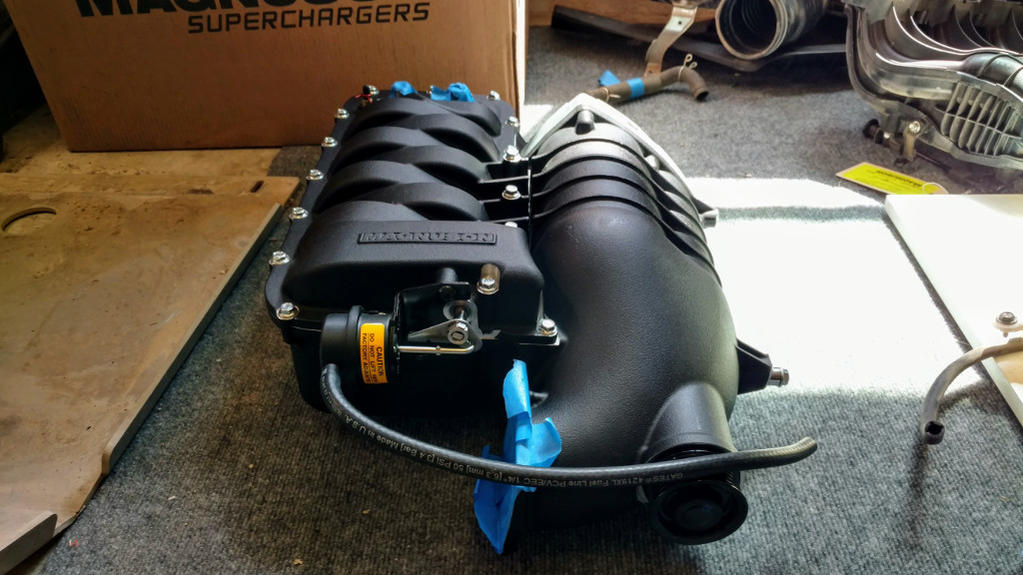

A little more info on the kit and blower...
Attached is a picture of the meat of the blower. This includes the compressor itself and the charged air cooler/intake all in what is basically one piece.
The actuator with the yellow sticker on the front is the bypass valve. This closes to produce boost. Otherwise it just recirculates air back into the inlet side by opening a butterfly valve.
The blue tape on the front is where the throttle body goes.
The two ports with blue tape on the back are where coolant goes in and out of the water->air cooler.
It is a very well thought out compact design.

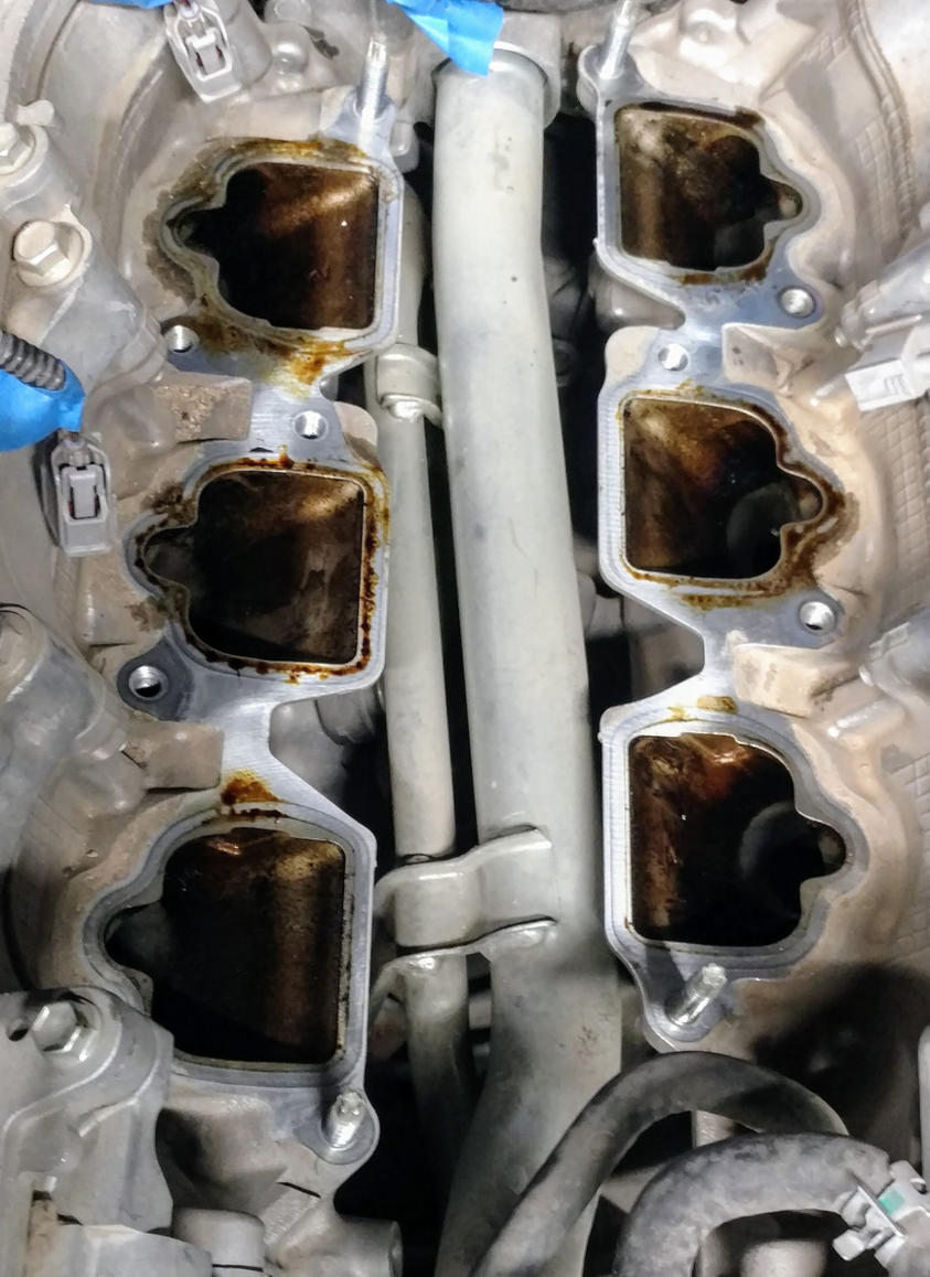

The next few steps in the install involve stripping off the intake system. Normally you just remove the plastic intake parts exposing the aluminum intake ports (which the blower charged air cooler box bolts directly to).. However, I found quite a bit of oily grime down in my intake runners/head ports and decided to pull that and give it a good cleaning also. It was not difficult to pull, but not fun job since some gas has to spill out of the fuel rails... To clarify, that step is not part of the normal install and it added quite a bit of time. I just had trouble not cleaning it up while I was in there.
The oil comes from the PCV and it is really not a big deal, but does kill octane and I wanted to start fresh and clean. My truck also spends a lot of time in very dusty conditions offroad, so it was extra nasty. I hope the snorkel will help with the dust ingestion. My guess is most would look bad in there...
I installed an oil catch can on my 4th gen and was surprised on how much oil it “caught”
Most places I read that N/A wouldn’t benefit from it. I guess the proof is in the pudding.
I have a Moroso catch cam on my supercharged tundra. It’s a must do imho.
I already have one on the truck I think you may be able to see it in a few of the pictures in the earlier posts over by the drivers side fender (which may need to move since that is where the intercooler reservoir mounts with the kit) .. It helps for sure.. but it can't get it all. I put it on about 10k miles ago. Truck has 70k on it.
Even with 0 blowby (which is impossible on a modern engine) you will still get circulation via the PCV. It is expected..The main downside of the oil in the intake is carbon buildup in the chamber and effective octane deterioration in high airflow scenarios where the oil gets pushed down into the cylinders and contaminates the fuel.
Attached is a picture of the actual head ports that I took before I cleaned them. The crud was not wet at all.. it was more sticky and stringy than anything else. Especially into the head vs up higher in the intake. Cleaned up pretty easy, but was also a bit glue like. A bit more baked on one side of each port (figured it was related to how the water jackets are configured or how the VVTI works).

As far as the bypass valve goes - is it default spring open or spring closed? The reason I'm curious is relates to the situation where you do find yourself with only low octane fuel. Could you do something as simple as put a ball valve inline on the vacuum tube to effectively "turn off" the supercharger while you run low octane fuel? I was assuming it's default closed so high manifold vacuum means it's in bypass mode and low manifold vacuum results in closed butterfly - high boost. Would that harm anything? Is the ECU tune capable of handling that unexpected scenario? In the alternative could you put some other option like a simple spacer block that holds the butterfly open to accomplish the same outcome? Might make an easy, simple, and reliable option for the circumstance where you want to bypass the boost for a temporary time.

It's something I had planned to test out... I'm pretty sure the default position is open and positive pressure will close it....but I have asked the contacts I have at Magnuson for clarification. It could sit in the middle and use vacuum to open all the way up....
[EDIT] after getting a response from Magnuson... it is closed by default open with vacuum. [/Edit]
From my past experience... the bypass is typically not enough to completely eliminate boost... although you can bleed off most, it will still make a few psi under WOT... but I'm not sure in this size... all my previous setups were capable of at least 600+ hp.
Remember the throttle blade and RPM are still very much in play... in terms of airflow.. You have to have the TB open to give the compressor enough air to make boost. But once it is fully open and RPMs are up... the bypass can't typically keep up.
On the tune side.. The MAF should still be very much in charge.. My guess is the majority of what they tweak is timing and some base targets. Total guess though... these engines may very well run in a closed loop mode at all times with the wide bands being available...

So, I had it wrong earlier.. The bypass is closed by default. Opened with vacuum. Adjustable..but not recommended to mess with the set screw or spring.
You could zip tie it open.. to limit boost, but I'm guessing you will still get some.... I may or may not test doing that....

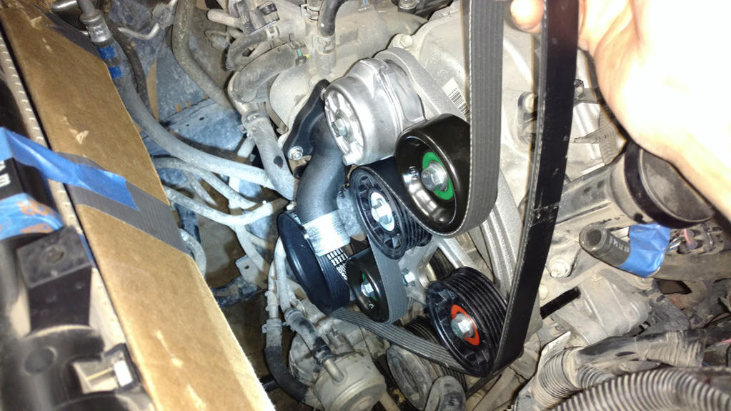

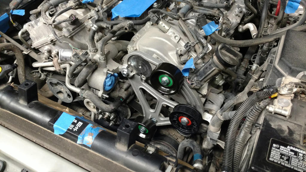

Had a few hours tonight and got the pulley system on. It's all aluminum and extremely lightweight. The grooved pulleys are actually a composite (like the tensioner)
Next step is the blower itself...
Only slow down I had was the thermostat housing bolt in the back. Took 30min to torque one tiny bolt. (had to use all kinds of crazy extensions...).. but I will get them to update the instructions to do that before the bracket (which should make things much quicker).
BTW, you replace the thermostat housing with an aluminum one. It has a different neck shape to clear everything. They include a tool to pop the old valve out and put it into the new housing. Super quick and easy.
FYI on the second picture below I have the tensioner on backwards... You will see the correct orientation in later posts.
