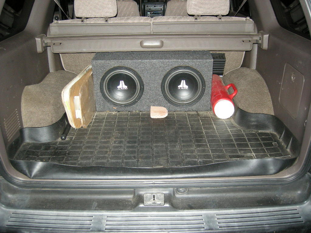

do they have to be mounted under the seat? why not on the rear of the middle seat?

I use my cargo area frequently enough to not want anything permanently mounted. My rear seats spend about 5% of the time laid down.
My sub box will have a single quick-release Speakon cable connector. So I can quickly/easily remove my sub box.

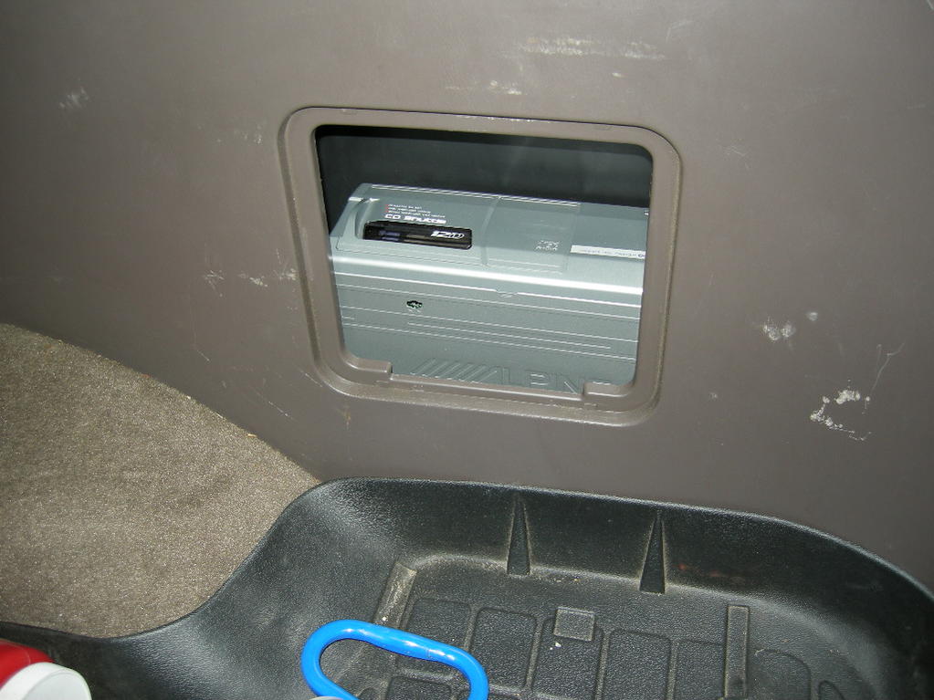

OK.. Thanks for the reply.. i'm just the opposite my seats stay up all the time... i might have to get me a sequioa anyhow... need a V8 - i tow stuff.... thanks again..
just incase you were interested.. this where my CD changer is..
