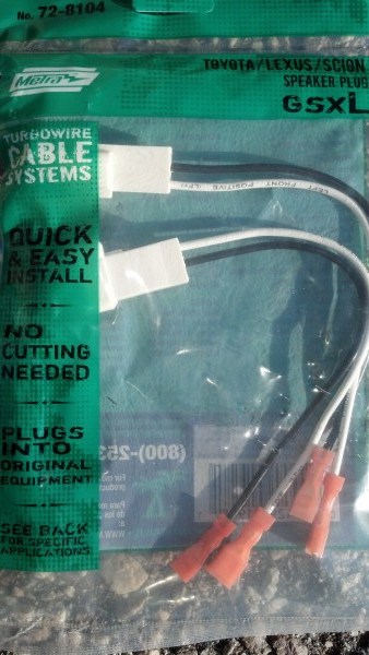

Metra Speaker Adapter Harness #72-8104
Installed dash speakers about 3 months ago and they sound great. Many thanks to OP for the great write-up!

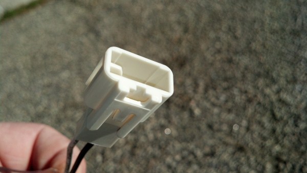

UPDATE: No need to cut factory speaker wires or pry off OEM connector, Metra has an adapter that plugs into OEM connector, part #72-8104. They are not listed to fit on the 4Runner on their website, nor would they confirm when I called.
I can confirm that on my 2012 SR5 (NAV, 8 speaker, non JBL) adapter works for all speakers, just replaced doors (4) and hatch with Kappa 3-ways..........OMG it sounds great!
Got 4 sets of adapters from Amazon for $4.89 ea with free shipping. BB has them for $14.99 a set...........ouch.
Next step is to install CAP's on dash speakers, now when it's cranked up, they start to crack. Gonna install 133uf capacitors as listed in another post.

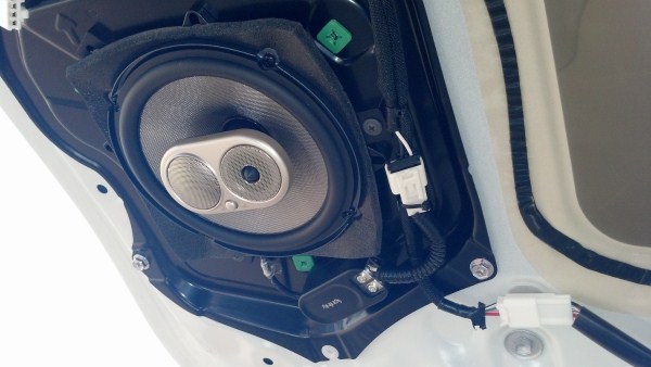

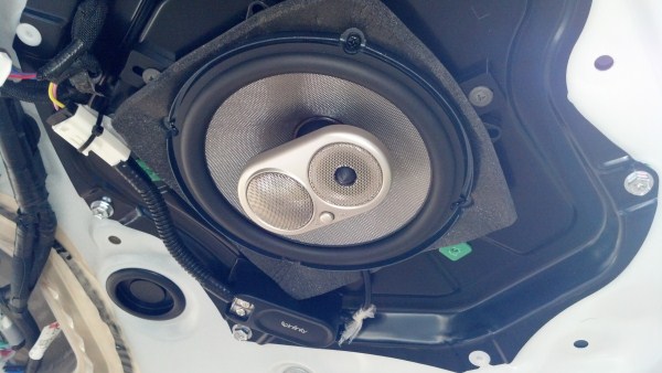

Pix of plug and rear speaker install. Was getting dark (and cold) when I completed doors thus no pix, plus it was beer thirty..... :beer:
