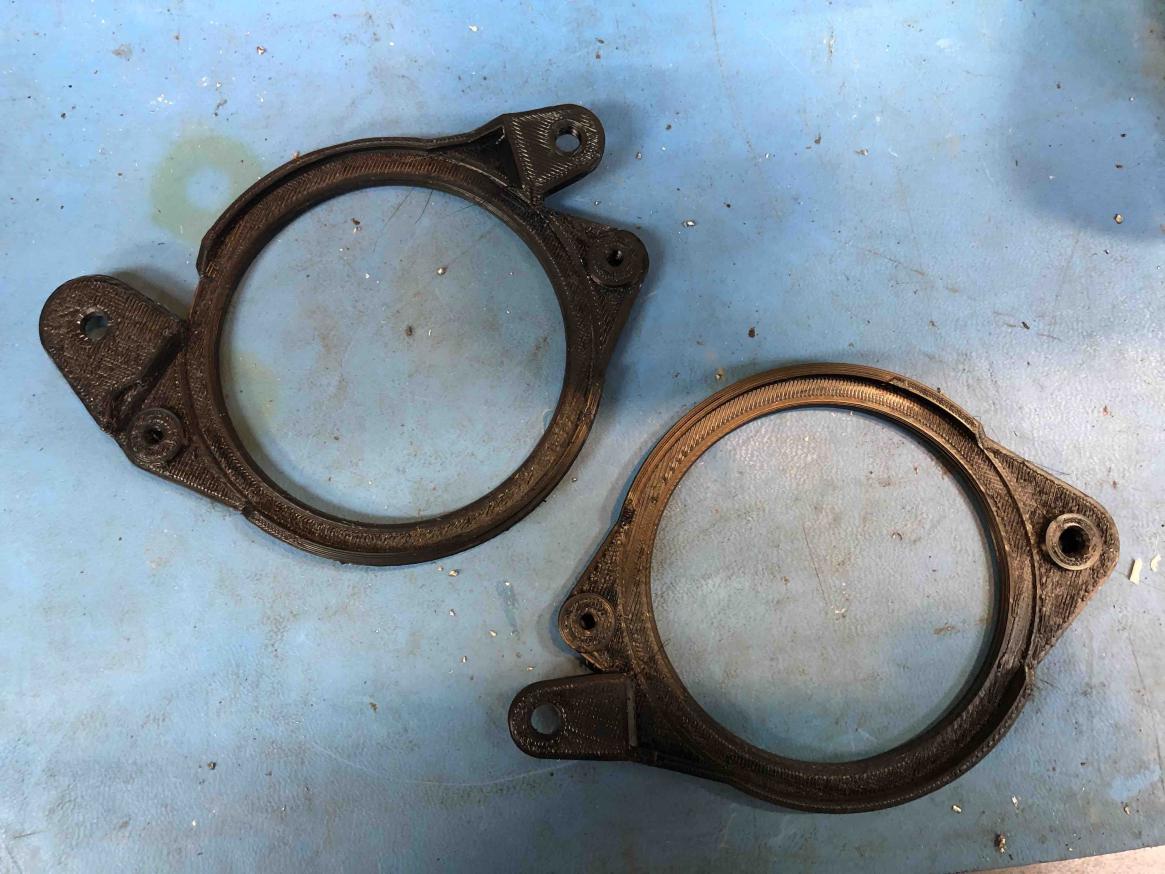

Sorry, just noticed this! Here's the link to the files: PrusaPrinters
I also included the STEP file which will be much easier to edit than an STL which is a mesh file.
Thanks!
I just got done printing a set in ABS. My 3D printing skilz aren't that great but these should work just fine.
No one will be able to see them anyway, so I didn't spend much time cleaning them up.
Now just waiting for the speakers to arrive....
