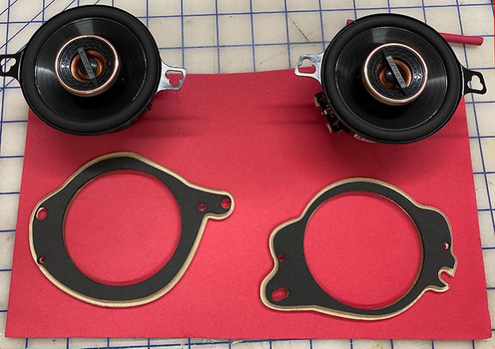

Thanks to everyone for such a wealth of information for this upgrade. I had all of my speakers upgraded over the course of the year in anticipation of a new CarPlay headunit. Which, once I installed it earlier this week I stumbled onto this thread. It made me realize I HAD to change them out and in my install I figured I'd return the favor with my approach:
1. Made a new wiring harness that allows me to plug into the existing factory harness with no cutting as I am on a lease, and I love upgradin.
2. Created custom adapters from Plexi + EVA for the 3.5 and 4" speaker upgrades. so you just have to bolt/screw your drivers to the adapter, drop it in, tighten and you bumpin! (as much as lil drivers can)
I am always conscious of weight and heat/cold living in Colorado and plan to test these versions out this winter, but contemplating plasma cutting some outta steel for the most bombproof installations.
