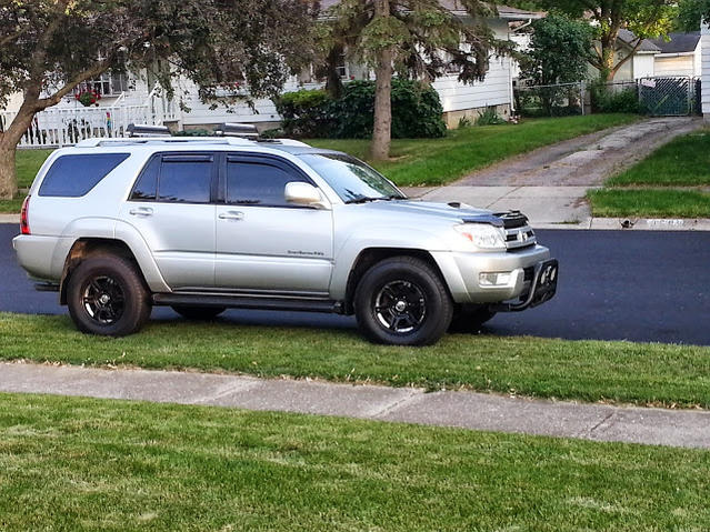

Nice, I didn't realize you were running them either. I did the same on mine as well...no caps and painted the rear hub. I tried the caps all 3 ways: stock, blacked out and off. They looked a lot better blacked out but I still prefer them off as it makes the lip appear deeper on the wheel. They could blow apart tomorrow but, to this point, I haven't noticed anything odd/overly-cheap.
Thanks man. I've done a few things to it...nothing major. The most $$$ being the suspension/tires of course. I really want a full roof rack but trying to convince myself otherwise. Ha. The tires are 285/70/17s.
