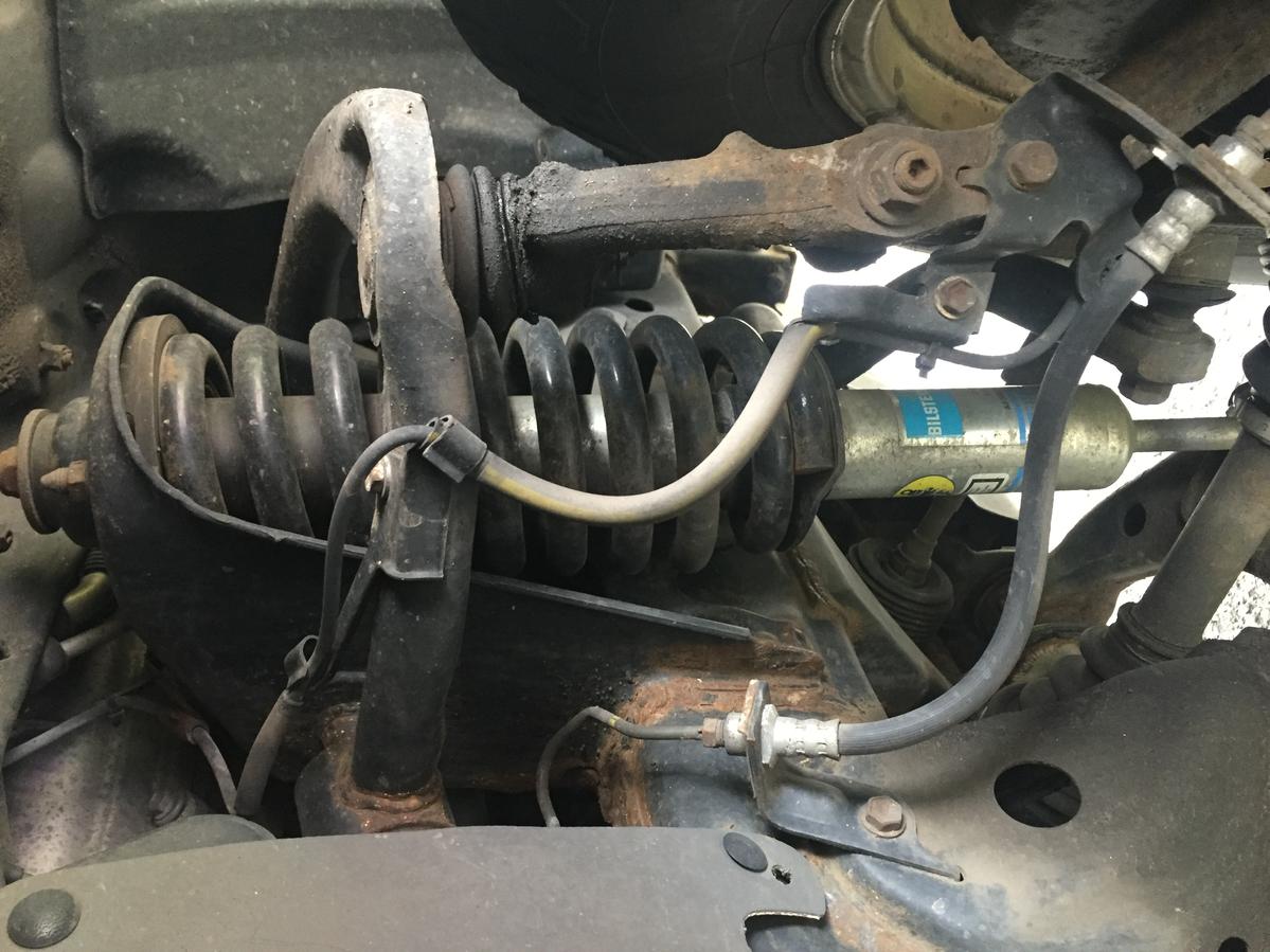

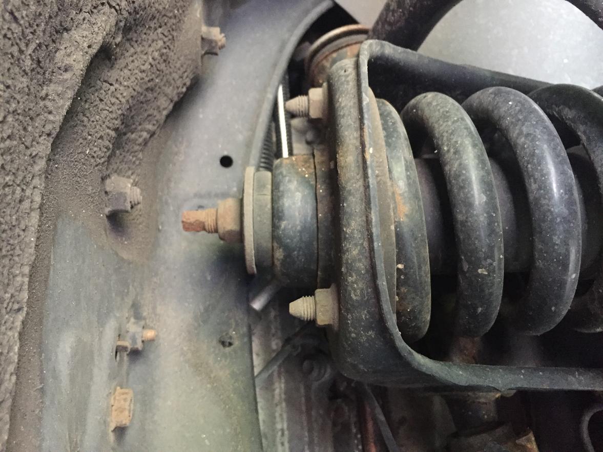

and this is what my shocks look like.
i am not able to do what you suggested because this rain will never stop here,but i managed to take couple of pics.
[MENTION=78378]beliy25[/MENTION] From the amount of grease that is on your spindle where the UCA ball joint attaches, I would guess the UCA ball joint is probably worn out and causing the issues you described previously. I would get new UCA's installed, a new alignment, and go from there. I would think after that you should be good to go, if not it will give you a much better position to trouble shoot further.

if it is possible,would you please provide me with the alignment that is suppose to be with new UCAs so i could show it to my mechanic and match it as close as possible?
[MENTION=78378]beliy25[/MENTION] You really just want to get it within stock specs, that is what you are trying to achieve by installing new UCA's after lifting. Here are my alignment numbers when I had mine setup like yours with 5100's / FJ coils with front set at max and a 1.5" spacer in the rear with new eBay UCA's.
