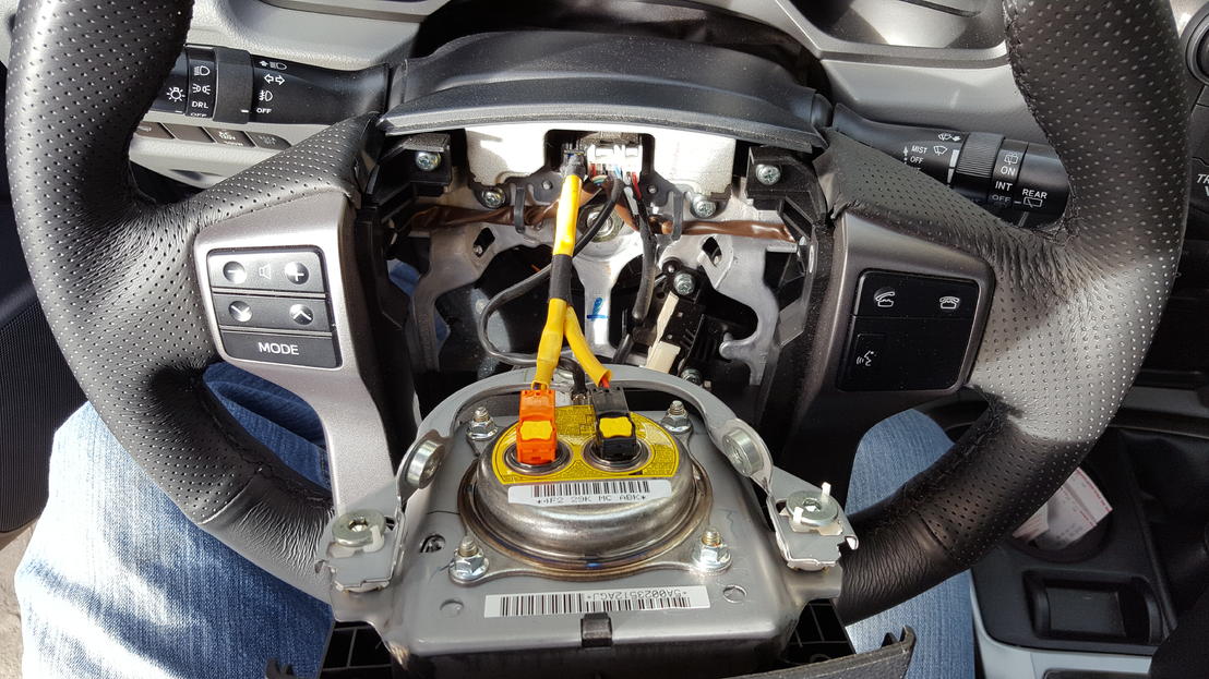

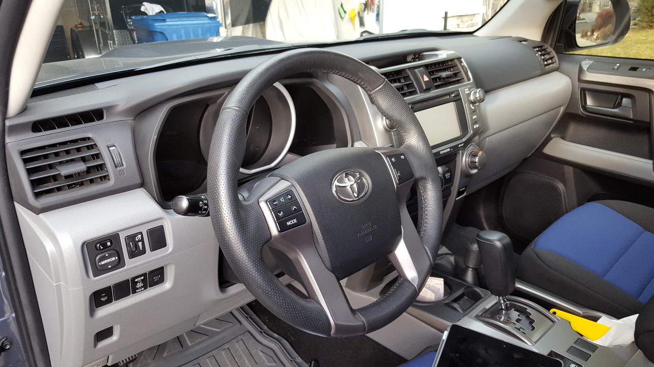

Back in the day (2013), the Trail Edition came with a plastic steering wheel (shocking, I know). This time last year I spent several hours sewing a leather wrap on my stock wheel which turned out good, however, my fingers always seemed to find the one or two imperfections. Today, I installed a "new" wheel bought off eBay ($225 shipped.) it came off of a 2016 Trail, wrecked at 9000 miles. Install was pretty easy: disconnect battery, remove air bag (2 Torq screws), disconnect 2 electrical connectors, pull the wheel; assemble in reverse order. I used my original control panels since they were a color match. Happy with the outcome or the new owner will be... if I pull the trigger on that 2017 Pro in cement:lalala:

See above
...here's the original wheel with the airbag before detaching.
