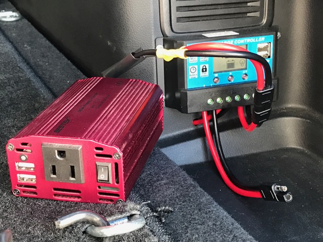

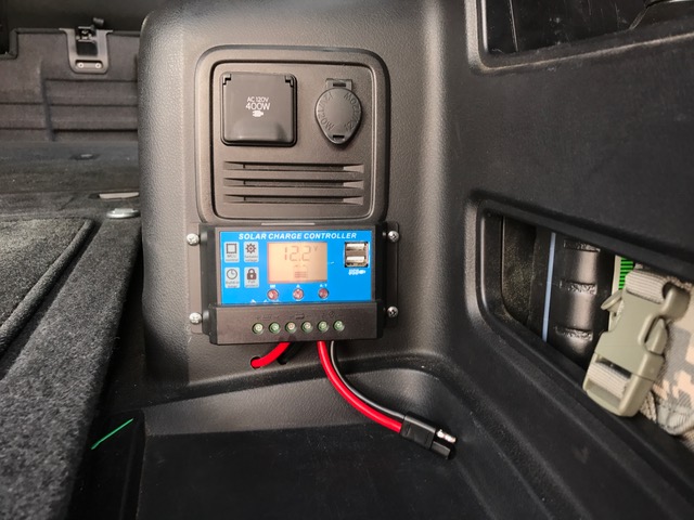

Wired up a solar charge controller. The left pair goes to the solar panel, middle pair for battery and right pair to any accessory. I've worked it with a quick disconnect. Second picture shows example device using quick disconnect and aux output. Solar charger also has USB. I will eventually wire up a 12v cigarette plug as well. Using one older 50 watt panel for now. Solar charger also has ability to cut power to accessory if battery voltage drops below a certain level. Sorry for crappy picks.

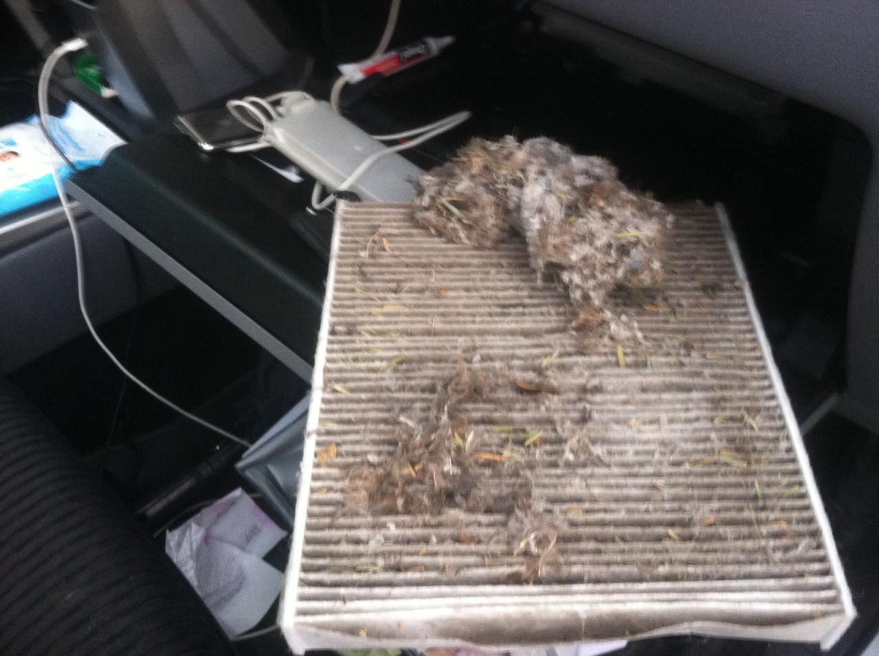

LOF then ROLFing when I pulled the cabin filter........I don't remember wearing a sweater when I changed it last summer? Haha I pulled the front windshield cowel and nothing but mesquite needle rubbish, sucked all them out and put some double sided tape on the heater clip(dash noise hopefully solved)

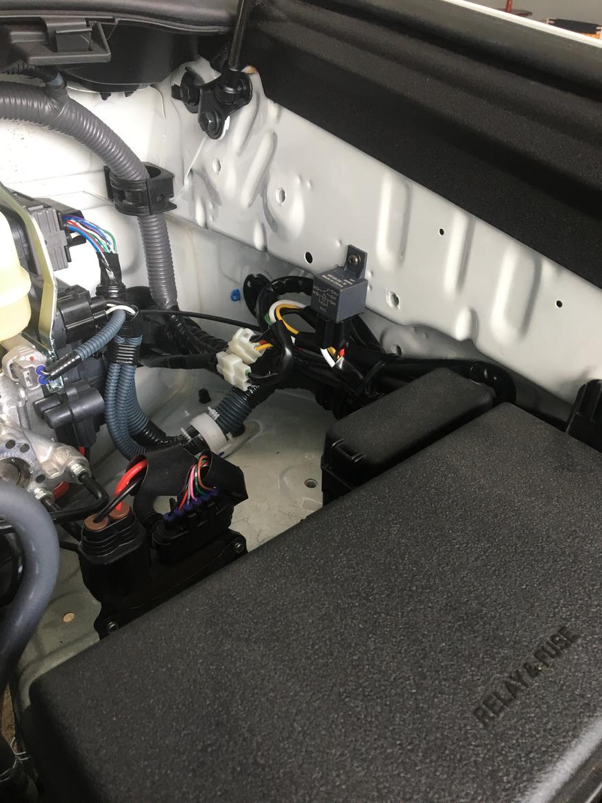

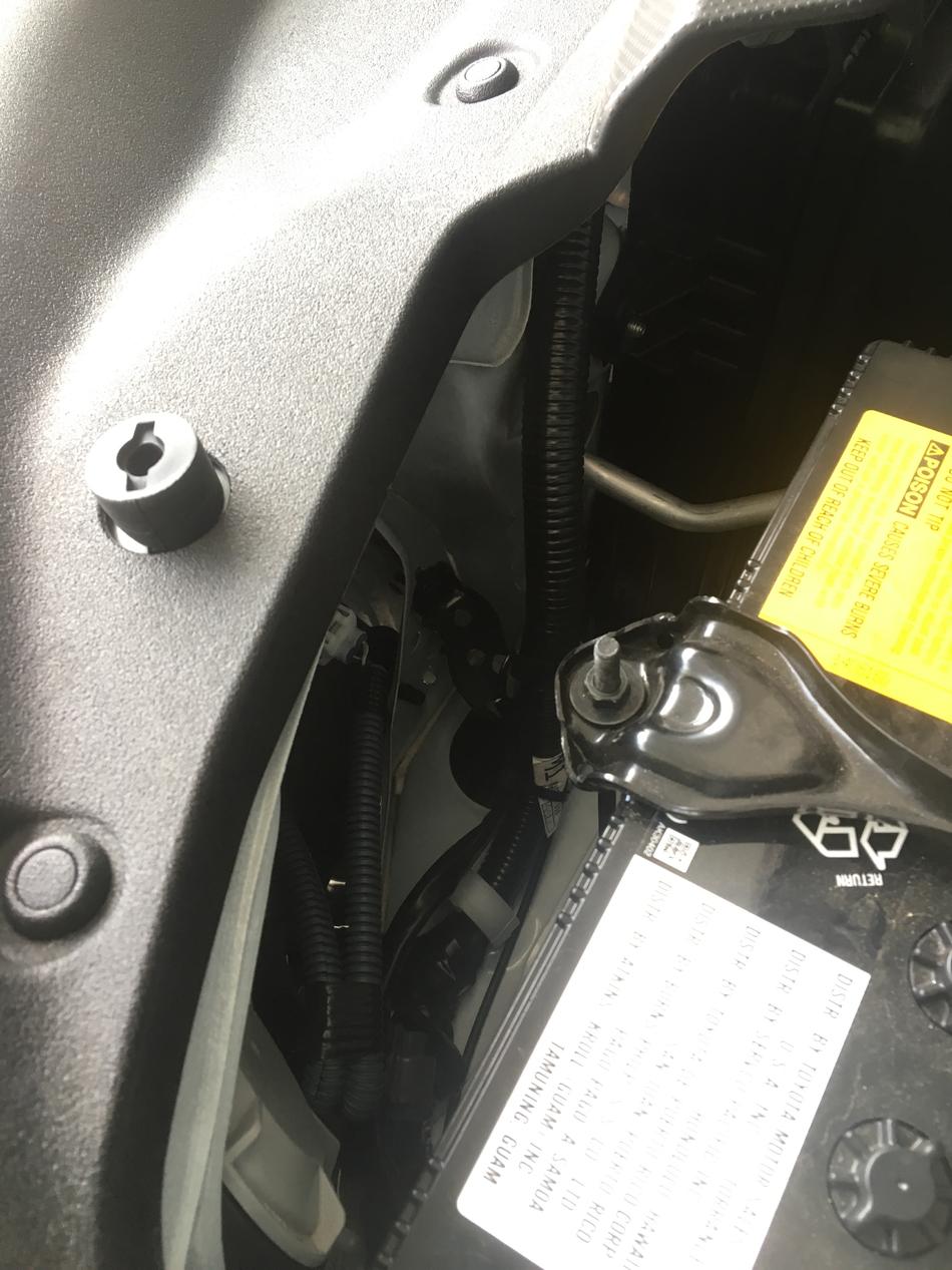

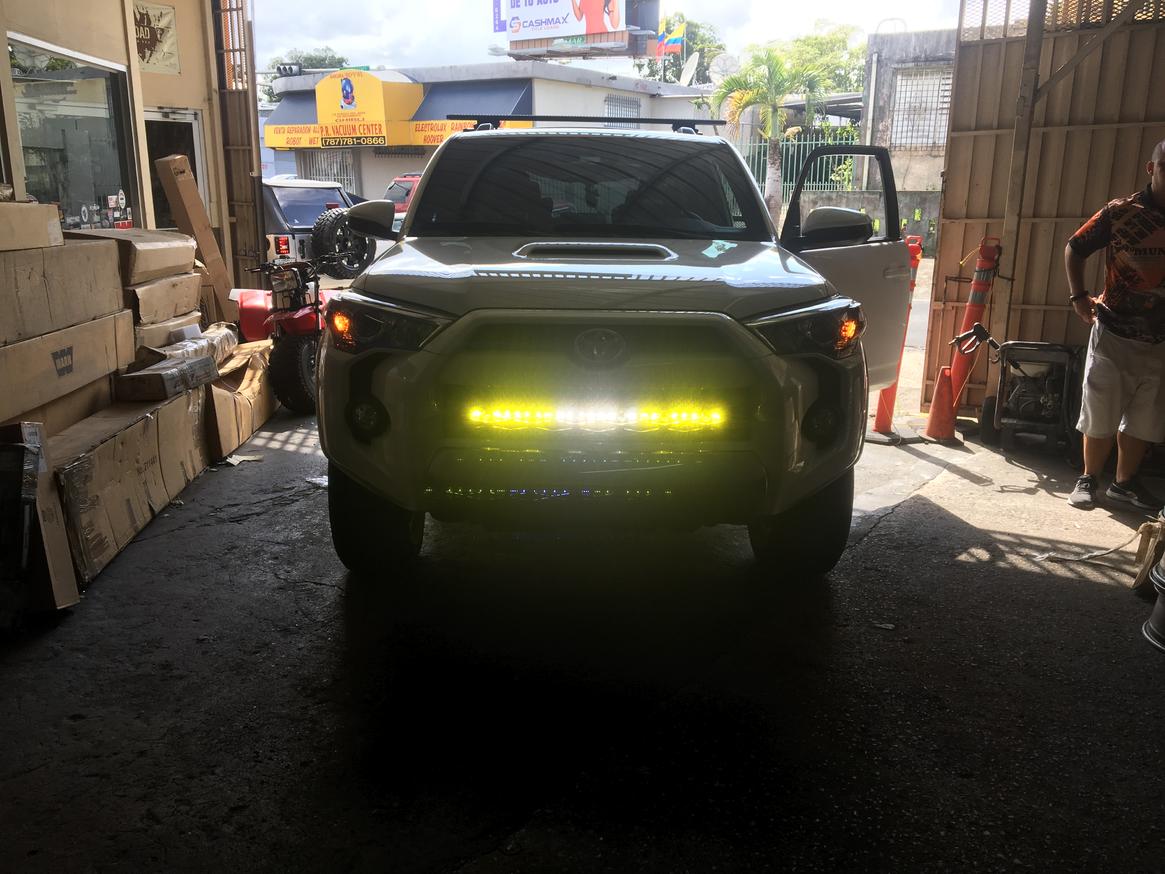

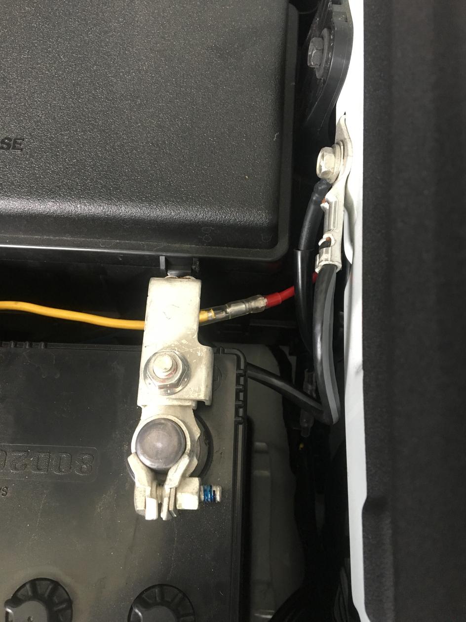

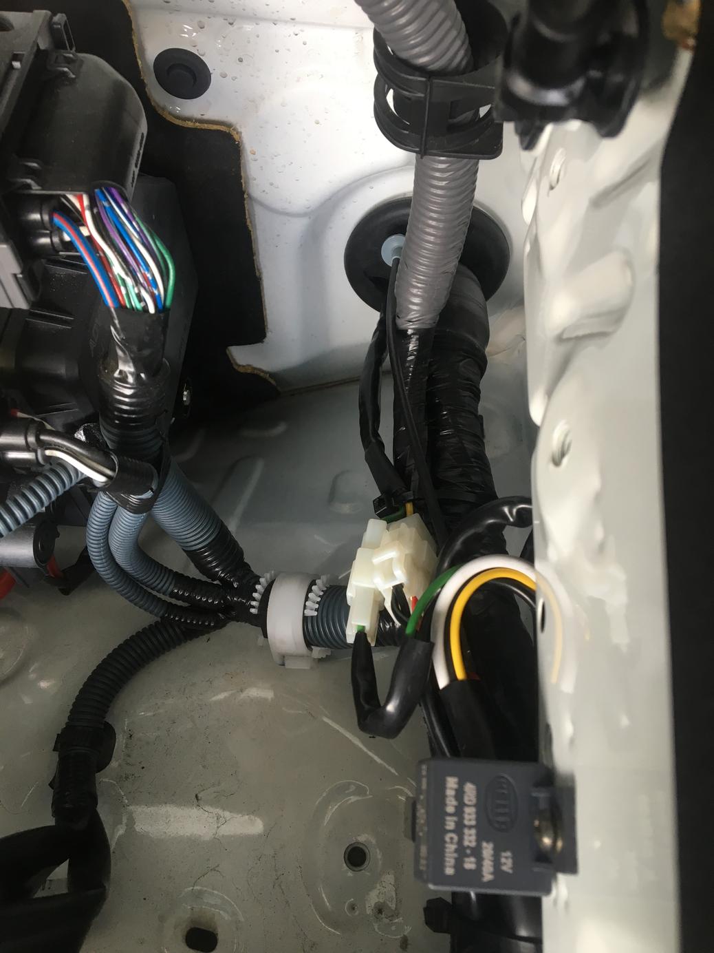

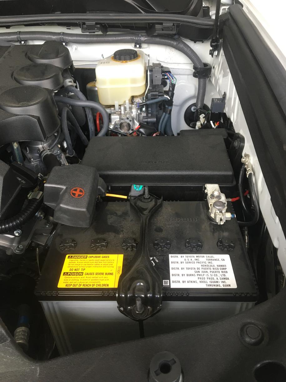

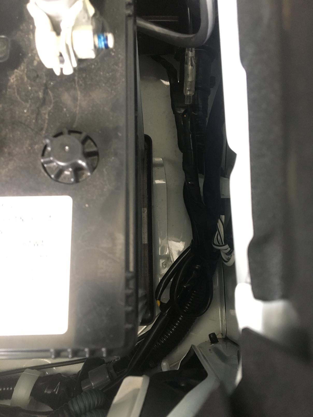

Hey guys and gals, I'm in need of your awesome knowledge on electrical wiring. Some months ago I went to a very good off-road shop for the installation of my S8 Baja Design light bar. They did an excellent job but it was kind of pricey. I have just received an ARB 12 volt wiring loom to power my Indel-B fridge 24/7. The question is if I can just connect it directly to the stock battery with the wiring of the light bar, or do I have to do something else??? I really don't know shit about electronic wiring and definitely don't want to burn my truck to the ground. Attached are some pics of the light bar wiring so you can tell me if it's ok or not to do the install directly. Thanks in advanced for your help!!!
You'll just run the ARB harness direct to the battery. No need to over think it, the light harness will be a totally independent circuit. Don't tap into the light wiring, just go straight to the battery terminals.
