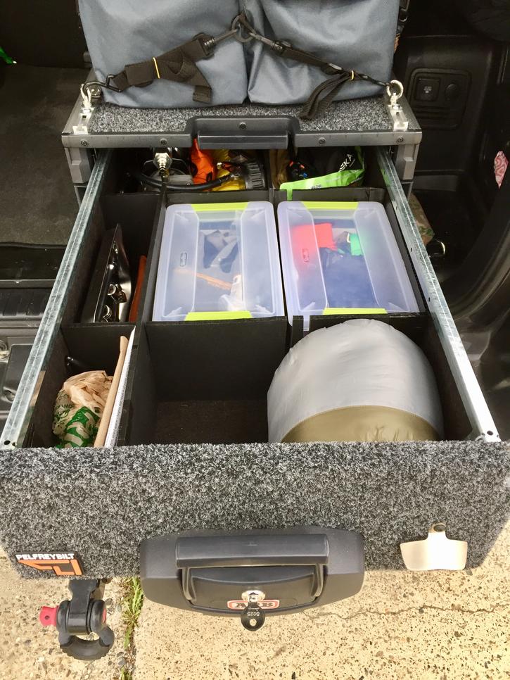

Made some DIY dividers for my ARB drawer using a sheet of 1/4" thick ABS plastic (although 1/8" would be plenty). Keeps my "junk" neatly organized in the drawer now!

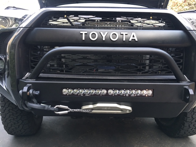

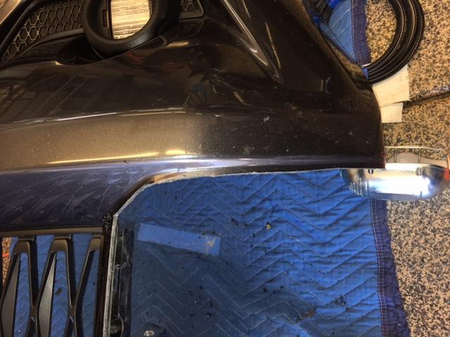

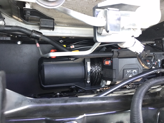

Finally got a day to install my SSO front bumper, BD light bar, and Smitty X20 winch. Project went really well overall. Bumper was packaged perfectly, fit and finish of the bumper was exceptional - everything lined up spot on. The only change I'd make (will be doing it asap) would be to mount the winch controller on the side of the winch. I mounted it dead center and it obscures the spool too much to rewind it well after a recovery.

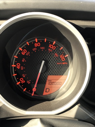

Celebrated a birthday last night! They grow up so fast, before ya know it she'll be asking to go on road trips by herself! Got to say, 100,000 miles and not one major issue, love this rig!

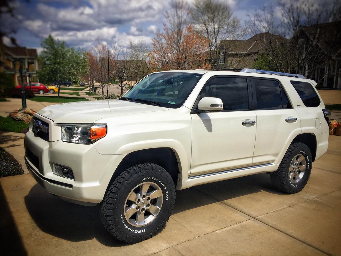

Had BFG KO2 285/70/17 installed as well some other routine mainance stuff done. Oil change, Both diff fluids changed and power steering fluid changed. I am really liking the new tires. I Have had nittos for years now.
