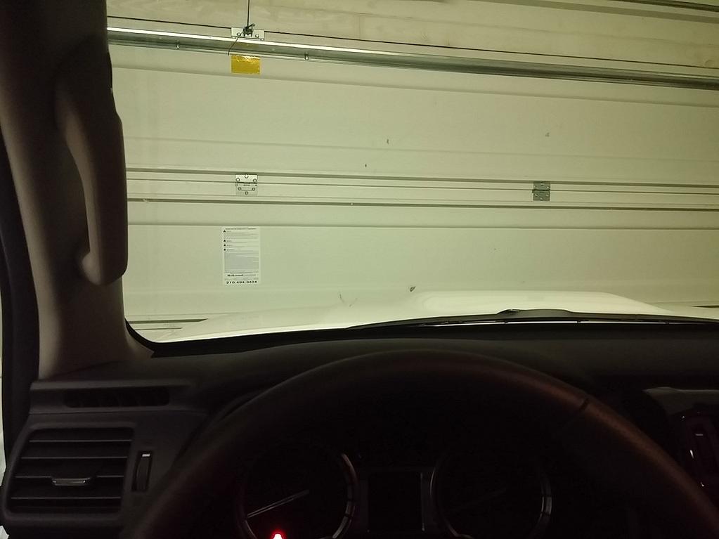

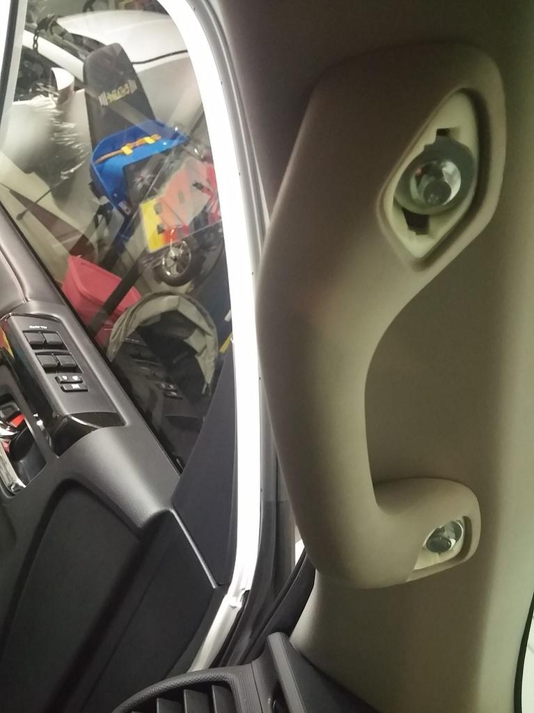

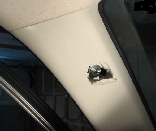

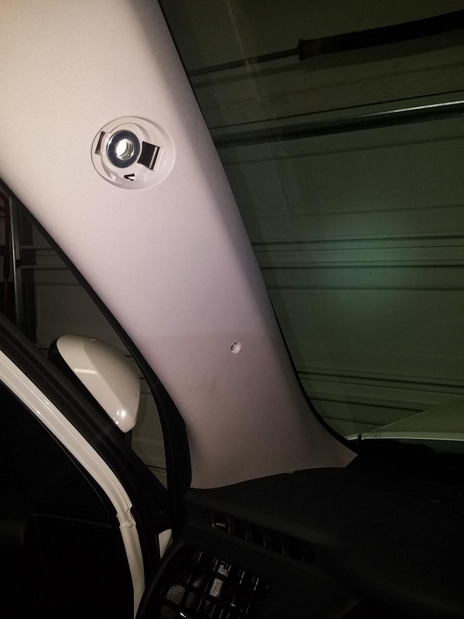

WTF?!?! I want a drivers side grab handle! Stupid 2016s!
yes grab handle! Sorry for the 2017 annotation confusion but no 5th GEN comes with an A-pillar grab handle:
I Purchased a passenger side grab handle and the the two covers over the bolt mounting holes.

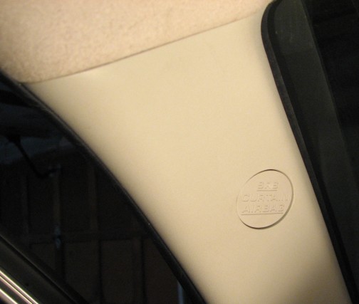

I fabricated a custom bracket for the BOTTOM hole as the top hole i used the existing bolt hole that is hiding under the "SRS CURTAIN AIRBAG" pop out. the top hole has a bracket that is the same build quality as the passenger side brackets - as if toyota may have intended to install a grab handle but decided not to. the space is there for mounting a custom bracket for the bottom hole. no issue with space at all.
Top bolt:
1. I had to install a metal spacer because a gap is formed between the handle and the top bolt mount surface hiding under the "SRS CURTAIN AIRBAG" pop out plug.
2. longer bolt of course M6x1.0x35mm
Bottom Bolt:
1. 5/16 - 18 x 2 inch long bolt with washer.
2. custom bracket mounted to the A pillar structure.
3. drilled hole and modifed the A piller trim interior plastic "CLIP" that helps hold the A pillar trim in.
Finished:
outcome is awesome! very oem clean install - exactly what everyone seems to complain about online and all these "top 5 things i hate about my 4runner youtube videos"
Ill post more pics and a stand alone thread later. as the bracket i designed is very basic and works just fine for an unseen bracket.
-J

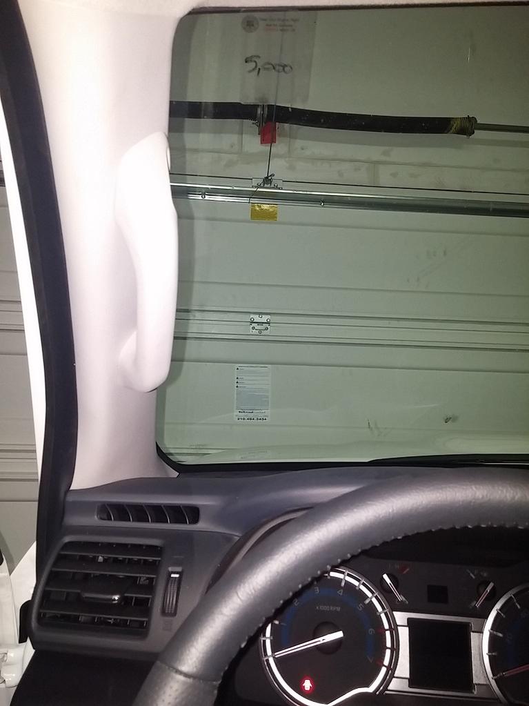

I would love to meet up with you sometime and see how you did this! That is one thing that I miss from my 4th Gen.
Would be interested in seeing how this turned out from other angles and in the daylight. But would be down to have you make me one as well.
ya sorry i did it last night...this one has flash....ill take more pics, but there is no gap, smooth and nice...looks very oem.
-J
